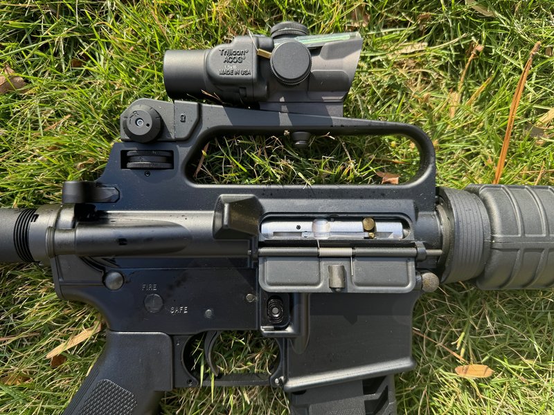

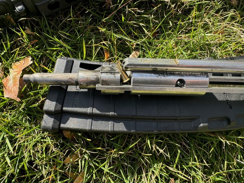

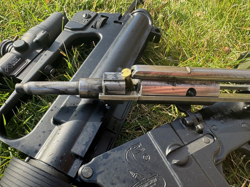

I shot an AR15 with the CMMG conversion kit installed.  The results were disappointing to say the least.  I started off with two 25rd magazines full of Aguila Super Extra HV 40gr copper plated.  This ammunition runs reliably in all my other semiauto 22LR's.  The were 11 failures to eject out of the 50rds fired.  I then fired one 25rd magazine of CCI Quiet-22 Semiauto lead.  There was one failure to eject and the bolt locked back once before it was empty.  Finally, thinking that it might require 22LR with more power, I fired one 25rd magazine of CCI Velocitor 40gr copper plated hollow points.  There were five failures to eject.  Of all these failures to eject, the majority were easy to clear, but a good number required the bolt to be removed in order to clear the jam because the mechanism was catching and holding the spend case.

The Colt and CMMG are NOT the same, and they are NOT made by CMMG, there are slight difference and the biggest being the DLC finish.
All conversion devices are temperamental with ammunition, the copper plated ammo works reliably, generally, and applying a little oil on the hammer/trigger region may solve alot of issues.

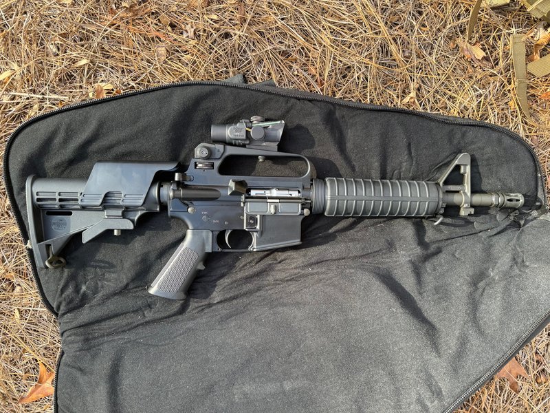

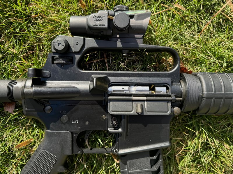

I had a thought about the Bushmaster SBR that I used, so I decided to test my theory today.  The Bushmaster SBR has a commercial buffer tube.  My thought was that perhaps the conversion kit doesn't work reliably with rifles that have commercial buffer tubes for some reason.  So, I decided to break out my CMMG 10.3" SBR.  It's not technically a "factory" SBR, but I bought the complete lower from them, did the NFA thing, bought a complete upper from them and then snapped them together.  I figured that I'd use the CMMG rifle to eliminate an excuse option for them if I had to call.  I installed the conversion bolt in the CMMG and then loaded up a magazine with 25rds of Aguila Super Extra HV 40gr copper plated.  It ran flawlessly.  Unlike when I was using the Bushmaster, the cycling felt the same every shot.  I then loaded up three more magazines with 25rds of Aguila Super Extra HV 40gr copper plated.  Function was once again 100% through all three magazines.  Obviously, I'd have to do a lot more testing of commercial versus milspec buffered AR15's to test my theory, but it's obvious at this point that there is something different in the Bushmaster that's causing the ejection failures.  Before anyone thinks that perhaps the Bushmaster is just an unreliable rifle, it isn't.  I've put hundreds of rounds through it without issue.  In fact, I put its BCG back in and shot some without issue after using the 22LR conversion kit to clear things out.  It runs like a champ using 223Rem or 5.56x45 ammunition.
The buffer tube type (i.e., commercial or mil spec) has nothing to do with the .22LR conversion function.  There is a lug (or tab) at the top of the frame back plate with a hole in it where the small rod end of the recoil spring rod fits.  That tab rests against the lower and prevents the .22LR assembly from moving backwards.  In any case, I am one of thousands of individuals who have an AR lower used for .22LR shooting that does not even have any buffer tube.  So when you see someone suggests using a "pressure plug" to fix poor operation, ask them what someone who does not have a buffer tube is supposed to do.  You'll get total silence.
FWIW, the back of the frame rear plate at the top should be flush with the rear of the lower receiver under the charge handle.  If the back of the frame plate is recessed into the lower, the frame assembly is insecure and stands the chance of improper operation.  I suggest that the cause of the conversion assembly being recessed be investigated and corrected for proper operation.
