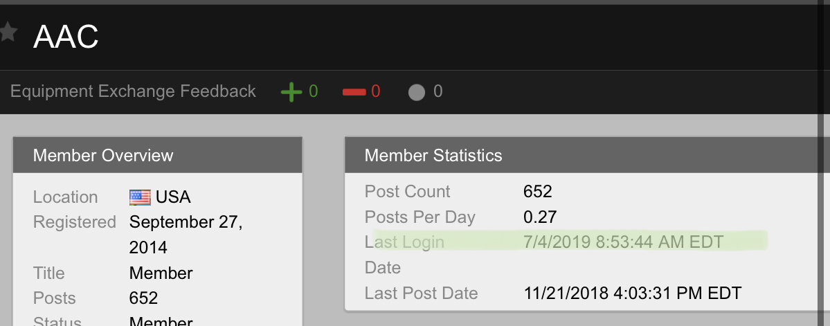

3/25/2021 3:00:33 PM EDT
Originally Posted By cms81586:
Still nothing from AAC. How the mighty have fallen...
Just for the record...
