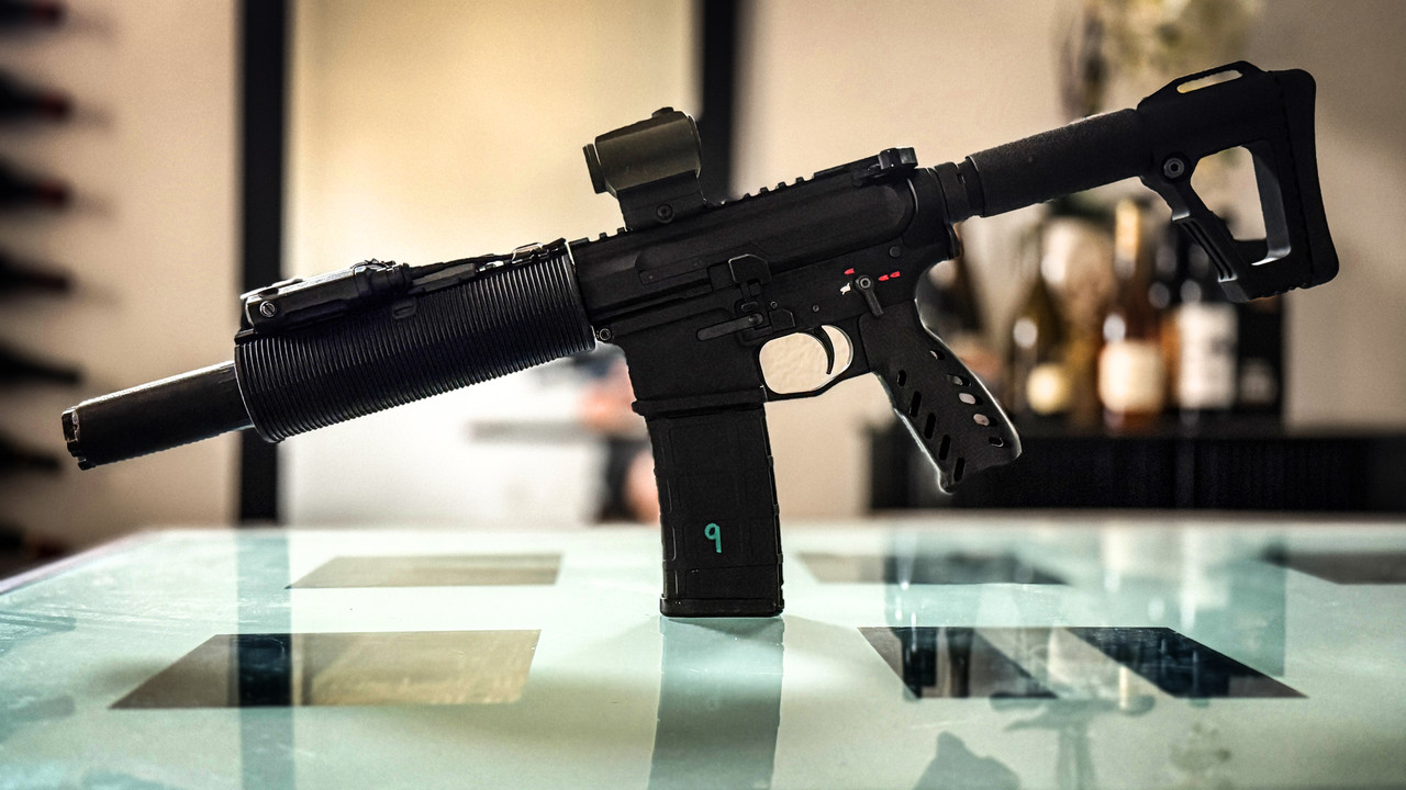

This is where my Gen 4 ended up... great stock I love it. Attached File Attached File |
"Don't want to be that guy with 100K primers who can't pay the electric bill."
Originally Posted By Commando223: This is where my Gen 4 ended up... great stock I love it. https://www.ar15.com/media/mediaFiles/63506/20250918_175828_jpg-3626275.JPG https://www.ar15.com/media/mediaFiles/63506/20250918_175605_jpg-3626277.JPG That looks really good. |

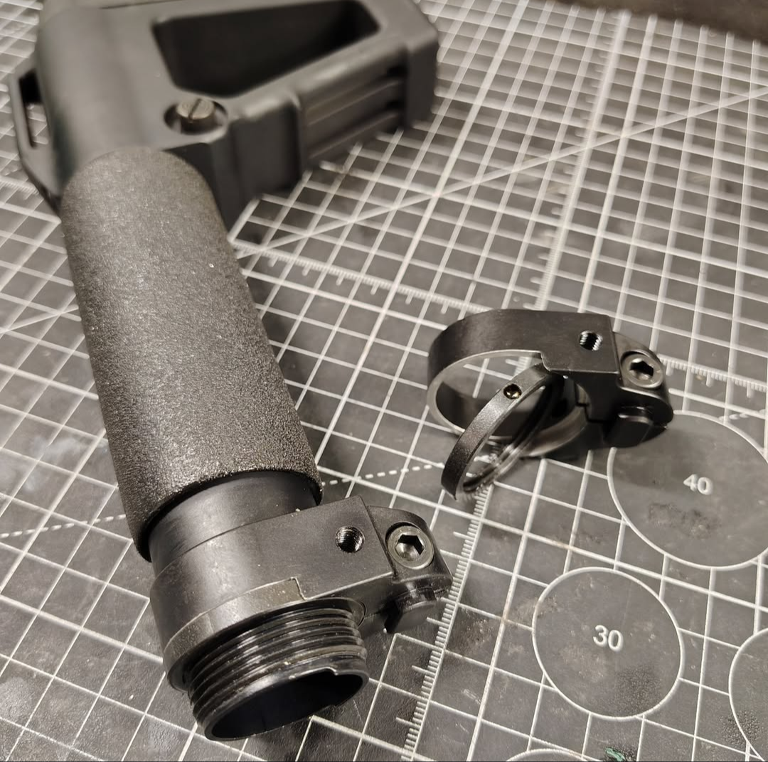

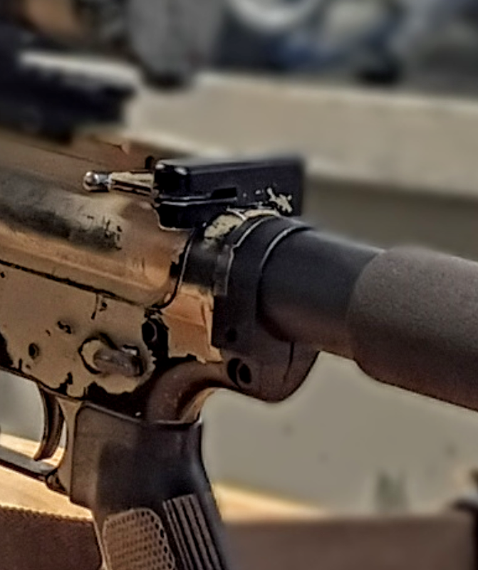

Originally Posted By HaveBlue83: i recently did one for a guy and i might have 6 thin lock rings from ACE sitting in my drawer for others if they need theirs......modded Originally Posted By HaveBlue83: Originally Posted By SecretSquirell: Unless Ace is offering something now, that was a homebrew thing by @Haveblue83. I must be lucky; mine has only just barely gotten loose. Never had it get all floppy on me. |

that lock ring has been a godsend and i have already done a few for guys and my own. thx again for alerting me to them, there is JUST enough room to fit them into the gusset on the new style stocks threaded length and secure the detent. I have to grab more of them! i need to grab a spanner for the hole since my dpms wrench teet broke off. ill check the site for one actually... i have some of those pads, ebay had some last year. guys hit me up about them frequently. if i post a pic or video about the ace stock, i get "where did you get that pad" DMs lol |

Jesse, When purchased the ace socom stock I also bought the thin lock ring. ( A618, Cage 70NN3) When installing I've tried both inbetween the gusset and after. Neither seem to work as the gusset won't match when before and the thin lock ring won't go After. Please tell me how dumb I am and let me knothe correct way to install the two together. Just the stock alone has a crazy shake. (FWIW, yes, I applied adequate pressure against the gusset to the receiver then tightened) Thanks |

Originally Posted By JohnnyLawdog: Jesse, When purchased the ace socom stock I also bought the thin lock ring. ( A618, Cage 70NN3) When installing I've tried both inbetween the gusset and after. Neither seem to work as the gusset won't match when before and the thin lock ring won't go After. Please tell me how dumb I am and let me knothe correct way to install the two together. Just the stock alone has a crazy shake. (FWIW, yes, I applied adequate pressure against the gusset to the receiver then tightened) Thanks You have to modify the gusset to make that work; it's not a plug-and-play thing. |

Originally Posted By HaveBlue83: i never had one stay tight since 2017 . i offer the service and many other items off this site, please @clonechinist on ig for projects https://i.postimg.cc/2S9tvz7R/Screenshot-20251229-110239-Instagram.png Originally Posted By HaveBlue83: Originally Posted By SecretSquirell: Really only needed if you can't keep the tube from loosening. I never had an issue with mine. . i offer the service and many other items off this site, please @clonechinist on ig for projects https://i.postimg.cc/2S9tvz7R/Screenshot-20251229-110239-Instagram.png I need a lathe. |
Originally Posted By HaveBlue83: all mill work sir Originally Posted By HaveBlue83: Originally Posted By SecretSquirell: I need a lathe. I do have a rotary table for the mill.
Originally Posted By HaveBlue83: ur overthinking this just send it here ![]() Originally Posted By HaveBlue83: Originally Posted By SecretSquirell: I do have a rotary table for the mill. ![]() ![]() Nah, I wanna fuck it up myself.
