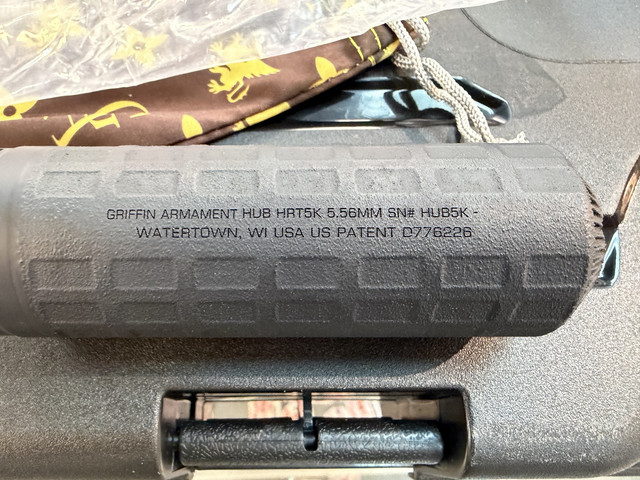

6/26/2026 6:49:05 PM EDT
[Last Edit: Brahmzy][Edited] [#13]
Conjugal visit!
LOVE that printed texture!  Feels great.
6/27/2026 5:26:50 PM EDT
Originally Posted By Brahmzy:
Conjugal visit!
https://i.ibb.co/Rp2JH6RL/Griffin-HRT5-K.jpg
Cool.   I hope you get to shoot it soon.
