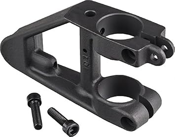

6/28/2018 12:23:35 AM EDT
[Last Edit: azmp5][Edited] [#15]
I'll look for the company (cant think of it right now) but I have a 20" stealth and ended up going with a "clamp on" A2 post. Put about 1000 rounds through the rifle so far and no issues

6/28/2018 6:14:26 AM EDT
Edit:
DEZ
Not a fan of that method of attaching a FSB.  If you cannot pin then an Armalite FSB is what you seek.   No bayo lug but under the circumstances who gives a fuck.

6/28/2018 11:54:18 AM EDT
Edit:
DEZ
Used the same one for my A1/A2 build with a 20" Stealth barrel.
