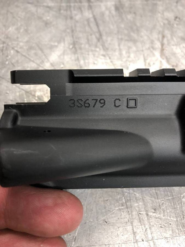

Anyone know if there were “dot matrix” style “C” marked uppers?  I saw the below pic and it looks like it to me but hard to tell.
I seem only to remember seeing raised and stamped.

Its a C stamp.  All the other rounded things in that photo look blocky.  It's just the resolution of the image giving it the appearance of a dot matrix.

Yes. For a short bit during the transition to CAGE marking receivers.
I've seen it with and w/o the CAGE markings.

https://i.postimg.cc/xdt4snpz/IMG-6829-jpg-866991-JPG-876973-1020948-j-1565944-jpeg.jpg
I’ve seen that pic before with the FN cage on it.
I’ve also seen a pic without the CAGE of a dot matrix C that looked a little off (almost done by hand) but that also had a “sanitized” CAGE on it.  Do you happen to remember seeing any uppers with just  a dot matrix C and the forge mark?
I agree it isn’t the best pic, it was these 2 areas that make me thing it is dot matrix.  I don’t think a normal C stamp would look like that.

IIRC, the pic above was originally posted by Combat_Diver.
I have not seen a receiver with only dot matrix/ forge mark.

I have factory uppers woth dot matrix C's. I will see about getting one out tomorrow.

Thanks.  I saw that pic in a thread on here, pretty sure as well it was CD that posted it.
Interested to see what you have.

I have a few as well....
Factory Colt 6921 upper
