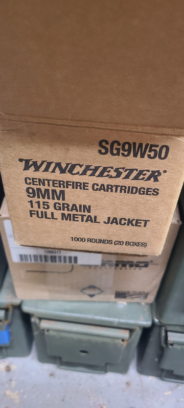

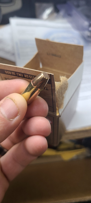

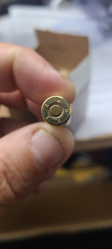

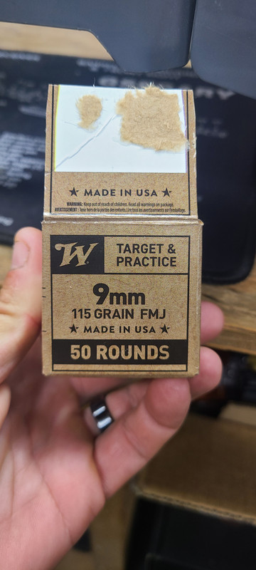

Just picked up 10k of the SG9W50 from Target Sports. So far looks good; WMA 25 head stamp, 115gr FMJ flat nose, primers crimped and sealed. .22 CPR with Ammo+ made it an easy buy. If I can swing another 10k, I plan to.
I think Target Sports has their description of this stuff wrong. Says 1190 FPS which is definitely not correct.

I went to a show a couple weeks ago and was looking around for this ammo. One dealer had 500 round cases of the traditional 50-round boxes, which is how I’ve bought it in the past. He let me open up a box, and it had the round nose bullets discussed here. A couple other dealers had new 1000-round cases with the smaller square boxes (the ones with the rounds stacked with no internal packaging). Those had the usual flat nose bullets. I bought one of those cases. Just throwing this observation out there.

Be interesting if OP's ammunition was in the traditional 50 round tray and not the small square boxes. The SG9W in traditional boxes ships in a 500 round case that is physically the same size as the 1000 round case SG9W50.
The SG9W50 I bought came in the small boxes, reminds me of what 7.62x39 shipped in. I like it, less trash to deal with.
Shot some through my 43X today. Really like how well this ammunition shoots out of everything I've tried it in so far (Glock 17, 19, and 43x). I'm going to keep stocking up on it. It is hot, but we're still
