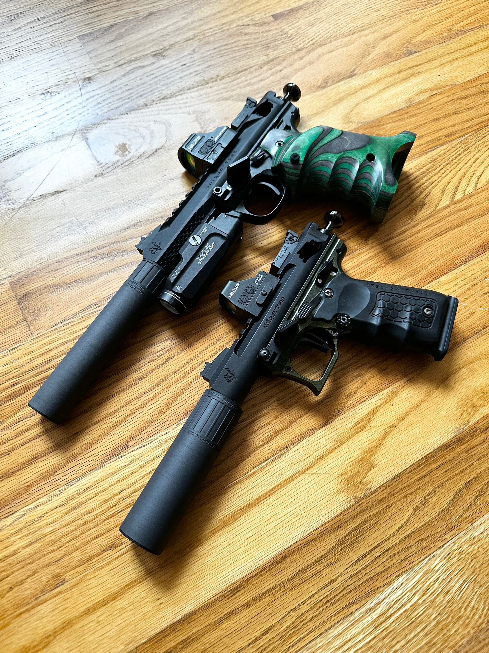

Of the ones I own, the best on pistols is OCL Titanium and the B&T print-x Tiger. I highly recommend getting serviceable can as first can with pistols in mind.

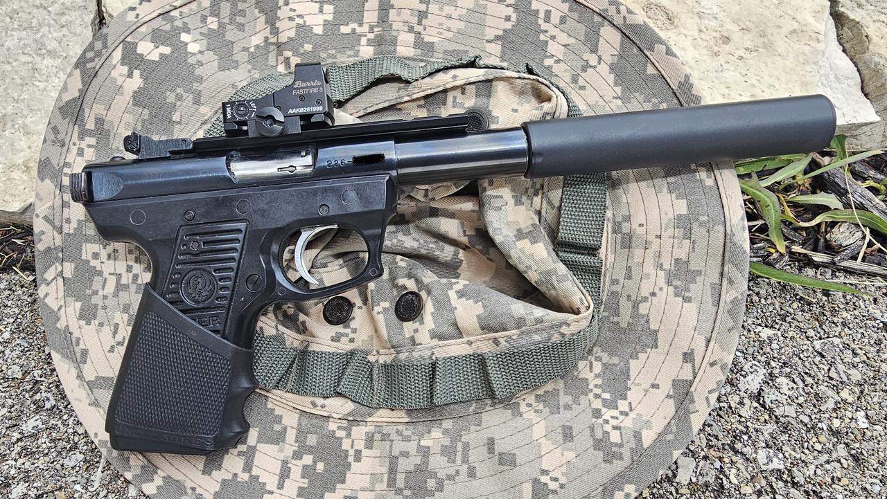

30 year old 22/45. Just put a Burris red dot on it. 22 year old AAC Pilot. Might get one of the new 22/45's this year.

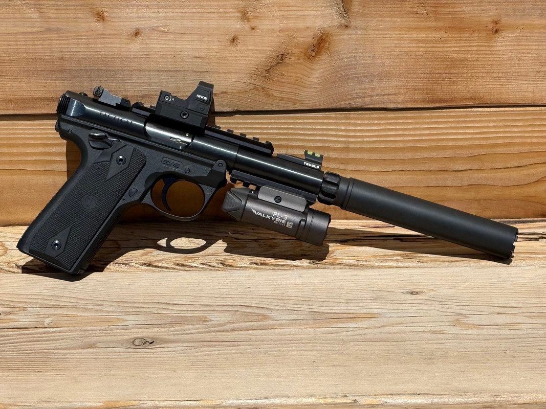

Ruger can with Burris FF RDS…can’t remember the optic mount but it’s so nice I got it in raw aluminum since I didn’t wanna wait on the black to come back in stock.
HUGE range favorite with new and old shooters alike; too easy to shoot accurately, near zero recoil, hearing safe and cheap AF to shoot all day if you’re so inclined.
