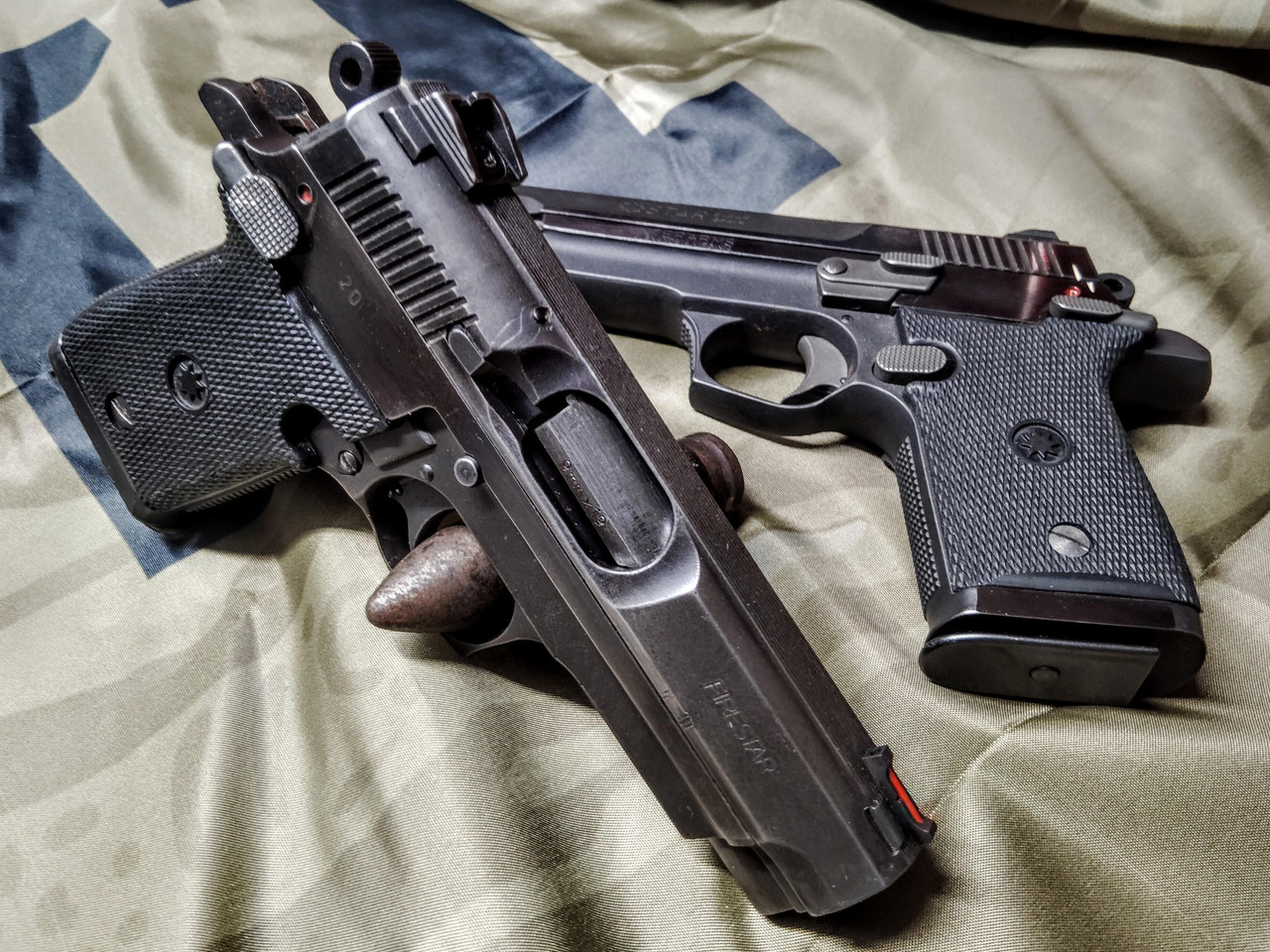

Picked one up as a parts gun awhile ago.
Turns out that the only thing wrong with it was the safety detent plunger was missing.  Made a new one and off and running.
I figured this one being in not the best visual shape, I would experiment with swapping the front sight with a fiber optic one.  I need all the visual help I can get.
From what I could gather online, the closest I could come to width, height and dovetail cut is Heine cut 1911 sight.  Ordered one from Dawson.  Ordered some files from Amazon (made one into a safe file ) and went to work.
It went a lot smoother than I thought.  Took my time filing, and think its a good fit.
I have an A-75 that I will probably do next.

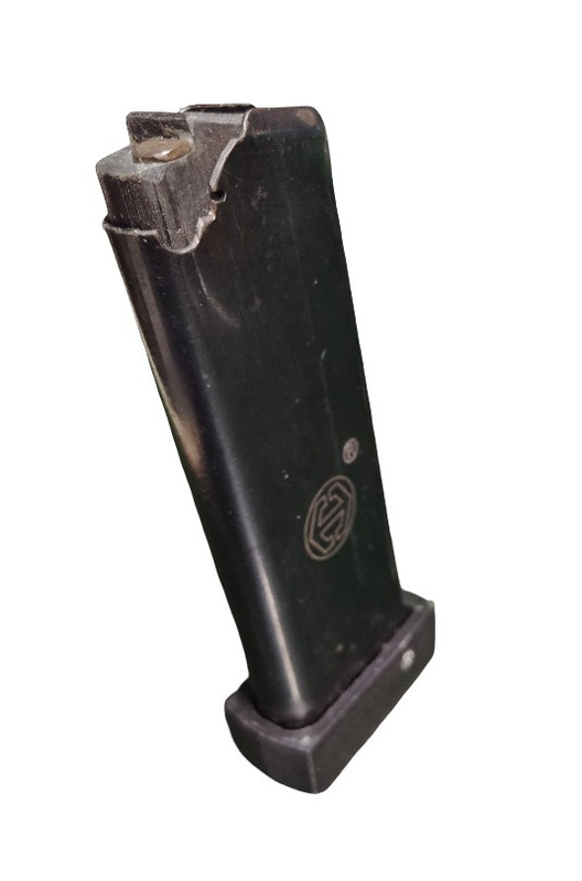

If you have one, you know the mag situation on these.   I had hoped the A75 would fit but no.
I have 2 Hi- Point C9's and found those fit the frame (can be inserted)
I modified the HP mag to mimic the Star, designed a new floor plate for it as well as follower.  It works well, but does not always lock back.  Well, that's on the beat up m43, the like new one has a slightly longer slide stop catch and works well in that case.
If you have other mags that you have tried please chime in.
If anyone wants more info about what I have done lmk and I will post more.
