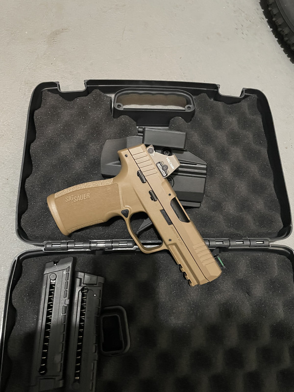

Anyone have one? What do you think about them? Other than being an sig.
I like the optic and suppressor ready idea and the 20 round mags.
Thoughts?

I have the P322 Comp and it's been surprisingly reliable.  My kids shoot it a lot.
10/28/2025 6:53:33 PM EDT
I like mine. Some magazines work better loading 15 instead of 20, at least in my experience. I shoot it with a Holosun 507 and YHM Phantom. Super fun to shoot.
Some had had an issue with light primer strikes. Not sure if this has been fixed with newer models or not. I’ve had mine for a few years now. If you have this issue, follow this fix. I haven’t had a light strike since putting a spacer in.

Great feeling in the hand. Sold it do to feeding/mag issues. Tx22 is the way.

Love mine.  Problem are the mags.  You need to be spot on in loading the mags or will get feeding problems.  Use the loader and load one round at a time.  There's plenty of vids on youtube to show how to load the mags

I bought one a couple months ago and it was an absolute jammatic.  It would jam consistently with all 3 mags that it came with until the mags got down to about 10 rounds or so and it would run the rest just fine.  I watched all the YouTube videos to make sure I was loading the rounds correctly.  I would load one round at a time and only pull the follower down enough for the one round to fit.  Rounds would just not feed.  They'd run up the feed ramp partially and get jammed into the top of the barrel hood.  I called Sig and explained the issue so they issue the repair tag and I sent the gun back.  I got it back in less than two weeks and the repair slip said nothing was wrong with the pistol and they couldn't replicate any malfunctions.  I tried the gun again and still had the same issues.  I had my wife take a video of me shooting the gun and showing the constant malfunctions.  I emailed the video clip to the person who emailed me the shipping label.  I never got a response back.  So that was enough to turn me off from Sig big time.  I ended up taking a big hit on selling it, but I wouldn't feel right not letting the new buyer know it was problematic.
10/31/2025 8:56:20 AM EDT
[Last Edit: Chris_1522][Edited] [#10]
I have had one for a few years now. I posted about it here a couple of times when I first got it and was super enthused by it, putting a bunch of different types of ammo through it and testing it. Since then I have shot the snot out of it.
It did require some tweaks to get it to 100% initially.
I had to shim the hammer spring to get reliable ignition.
I had to file the slide stop to get it to engage as it should.
You have to load the mags properly as has been state above already. The 25-round magazines never worked reliably for me, but the 20s were fine.
Once that was done it ran fine for several thousands of rounds. May very well be in the 10s of thousands. It was not uncommon for me to take it to the range and put 500-750 rounds through it once or twice a month with no problems.
This year it started developing feeding problems. I replaced the recoil spring, but it didn't help. I tried the "HV" ammo recoil spring, got worse. Tried the lightened recoil spring from ISMI, even worse. New factory spring back in, slightly better but still not good.
The mag springs may be worn out at this point but I haven't found them for sale anywhere.
The plastic mags will bow and swell out on the sides over time.
The passive safety levers inside the slide's breech block are a highly convoluted and piss-poor design. There is one lever that is pushed aside by the hammer as it strikes the firing pin, which allows the firing pin to move forward. That lever broke quite a while ago. There's a second lever that is pushed up by a plunger that is supposed to block the hammer if the gun is out of battery. It's a practically microscopic design and I can't imagine it would survive many wacks, but fortunately in normal operation it shouldn't have to. Both of these could be replaced by a typical plunger-style FPB activated by the trigger bar like essentially every modern handgun has but for some reason Sig went with the convoluted and extremely delicate mess the P322 has instead.
The rear sight is cheesy as hell but I can't say it doesn't work but adjusting it can be finicky.
Overall, initially I was really enthused by the 322, but I've since soured on it a bit. It's not a piece of crap, but it's also not a "lifetime" design like a Ruger or Buckmark...something you can have for decades and shoot indefinitely. It WAS a LOT of fun when it worked well, but frankly I think I've just worn it (or at least the mags) out. I could buy more mags and see if it works well again, but I think I'm just going to hold out and try a different double-stack .22LR.

Was excited to buy one as research revealed nothing but positive reviews.
Bought one and ran into issues.
Posted and received a lot of feedback on how you have to be very very very careful when loading the mags.
Quick summary.
Shoots great.
Accurate.
Fun to shoot.
If I known about how you have to be meticulous in loading the mags, I would have not purchased it.

Just to add.....
Took it out to the range this weekend.
Loaded about 10 mags and only 1 malfunction.
Not sure if general issue or related to the mag.
Getting better at loading as was able to get a little faster than previous range trips and no issues.
Long story shot. It does take some practice loading the mags and am getting quicker.
It is fun and accurate.

Hit the range again this weekend.
Loading of the mags is getting easier each time.
Only 1 feed issue, but not due to loading the mag but instead a random feed issue.
Liking this pistol a little more with each trip to the range.

I’ve had one for a few years.  I like the feature set (easy to suppress, optic ready, higher mag capacity) but I don’t really like the trigger and I’ve had reliability issues.
Even loading mags carefully its got a bad habit of jamming.
I’ve had fun with it, but it’s a gun I’d sell.
11/17/2025 1:19:46 AM EDT
Mine shoots great suppressed with CCI S/V, I put a Holosun full size EPS on it & Armory Craft trigger.
Fun to plink w/the five 20 round mags I have for it, never had the loading / jamming problem with the mags like others have.

I forgot to mention I tried this 2 mm hammer spring spacer fix in mine in the youtube video above and was still getting failure to eject & failure to fire problems when shooting suppressed with CCI Standard Velocity, so I tried a 1 mm flat washer spacer instead of a 2 mm one and now it's reliable.
Also the Armory Craft adjustable trigger really helps vs the cheap spoungy feeling stock trigger, highly recommend it.

Hated mine at first. Couldn’t get through an entire mag without a hang up. After several mags, that cleared up and now it runs great. I don’t think I’ve had a single malfunction since.
