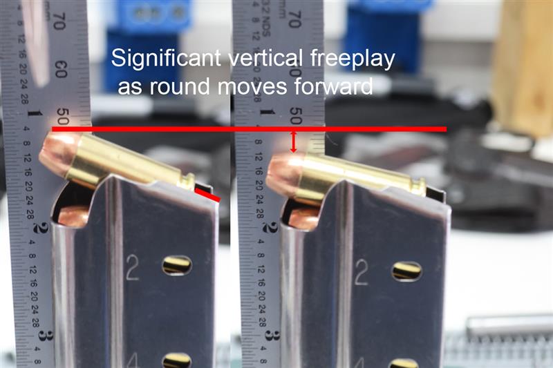

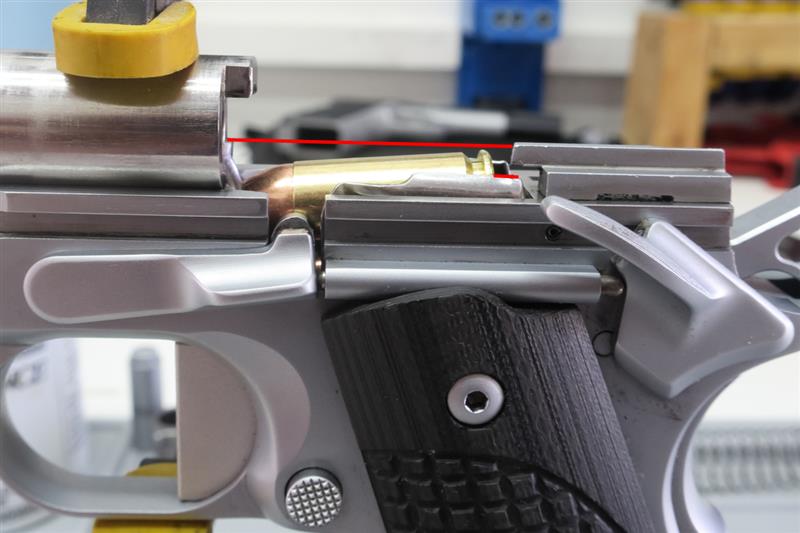

Out of curiosity, what is the bullet profile?  Flat taper / no ogive?
When it binds, does it look like this?

Yes, and yes.  I thought that’s what bullet S&B was using when I bought all that ammo in 2018 that never gave me trouble. But maybe it was more round then with an ogive but it definitely had a flat nose.  I can’t remember.  Anyone have S&B 180 gr 10mm FMJ they purchased a year ago?
On the left is Sig 180gr, the middle is S&B 180gr and the right is recently purchased S&B 180gr FMJ that won’t feed.
5/27/2019 2:51:12 PM EDT
Your bullet to the right would produce the same effect in all 10 of my 10mm 1911s, from Kimber to Wilson and Nighthawk.  The difference is the ogive, or more appropriately, lack thereof.
In a perfect world, the magazine holds the round at the perfect angle.  The slide starts sending it forward towards the chamber, and the extractor tension leverages the case rim to keep it from dipping.  Into the chamber it goes, and life is good.
But sometimes rounds are not perfectly shaped, case rims can vary in thickness, mag springs might not quite be up to snuff, and the stacking of many little tolerances can keep the round from going straight into the chamber.  So a healthy throat will catch the dipping bullet and guide it into the chamber.
The problem with a flat tapered bullet in a 10mm 1911 is that the bullet can have a lot of vertical play, particularly after it leaves the feedlips.  In the last two rounds in particular, the bullet can move quite substantially.  If it comes in low when it hits the throat or ramp, it can start to climb at a fairly steep angle.  The bullet hits the top of the barrel hood, and a bullet with a healthy ogive sort of 'rolls', or eases into the chamber.  On a flat tapered bullet, the flat may come in at an angle such that it is parallel to the chamber hood.  It can't roll, and more force applied to the slide simply drives it more firmly against the top of the barrel hood.  You get a three point bind between the top of the barrel hood, the throat or ramp, and the slide.  You can verify this by yourself by taking your barrel out, positioning a flat tapered round at a steep angle, and feeling for the bind.  That is what is going on in your gun, possibly any time, but most commonly within the last two rounds:
S&B and Privi both make rounds with flat tapers and others with ogives.  The one that's cheaper depends on the supplier at the time, I suppose, so you can't use the lowest price as a consistent indicator of one or the other.  Just really have to read the label.  You will find this same sort of swap between flat tapered Truncated Cone (TC) and more traditional JHP with Armscor and some of the other value providers as well.  Sig did it too, in their initial run of VCrown, which was somewhat ironic when they introduced a 10mm 1911 that wouldn't feed their own ammo.  In addition to this sort of bind, the broad meplat, or flat area at the tip of the bullet, on a truncated cone can cause another issue as well; nosediving.  That flat can be wide enough to catch just below the feedramp or throat, and the slide will drive it downwards.  Very annoying.
I have these pictures because this drove me crazy years ago, and a bunch of folks offered me some really well intentioned advice that had me swapping springs and assorted parts, buying a bunch of different magazines, and even contemplating the Dremel.  But it ended up just being the bullet profile and the stacking tolerances of adapting a long existing platform to the caliber.  If you don't end up trading these 10mm bullets back, I have found them to feed fine in my Glocks, Sig, and S&W.

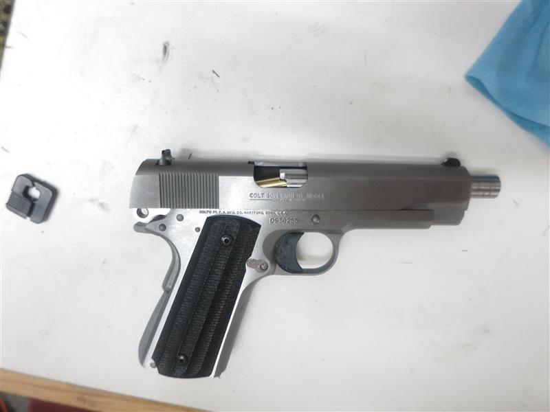

5/28/2019 3:39:02 PM EDT
@ken_mays
It so happens I do have a pic
I don’t see a bevel lol
5/28/2019 5:34:48 PM EDT
@ken_mays
https://imagizer.imageshack.com/img924/4583/IqKtNz.jpg
Yes, that's certainly not helping.   It should look more like this:
The case will still be more than sufficiently supported.

5/28/2019 10:23:47 PM EDT
@ken_mays
Ken, you seem knowledgeable & to know what you’re talking about
Not to derail the thread, but my Colt Delta has run everything I’ve put through it. No bulging of the casings but I’ve only ran:
Speer Gold Dot
Hornady Critical Duty
Sig V-Crown and FMJ
PMC
Rem UMC
and the aforementioned S&B, so nothing super hot.
What do you think of my case support from factory Colt barrel? Is it terrible?
5/28/2019 11:02:05 PM EDT
I think the Colt unramped barrel is safe.  It may not be ideal, especially if you reload, since hot loads like Doubletap have been known to bulge the brass at the unsupported area and I wouldn't want to reload those.
I also think there's really no reason not to use a ramped barrel in 10mm, unless you're Colt and stuck in your ways.
