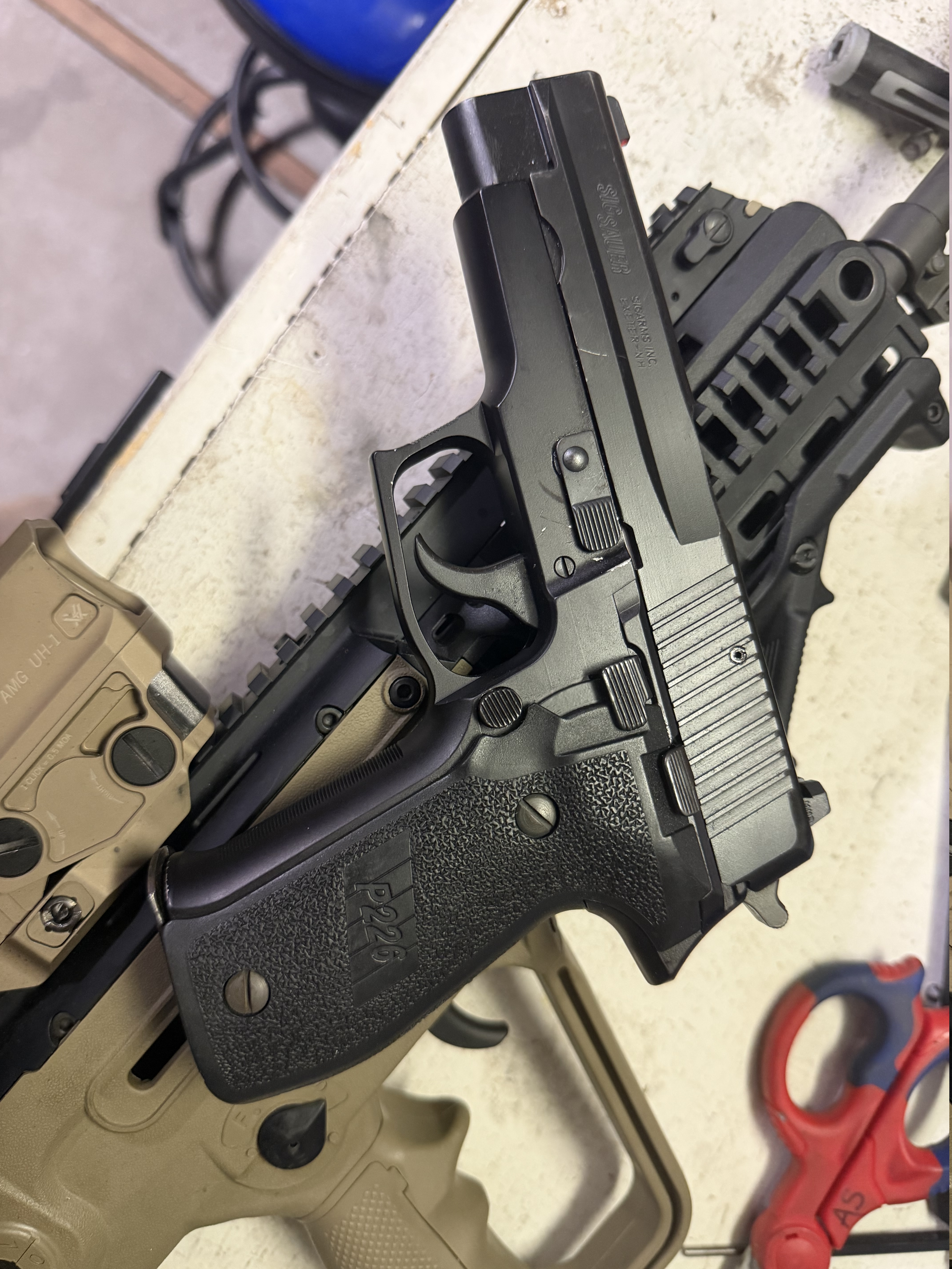

I recently got a 30ish year old German P226. It has the pinned breech block. I’d like to do a full refresh on the pistol but aside from a new magazine and recoil spring I don’t really know what I need.
Any pointers? Links would be great. Thanks.

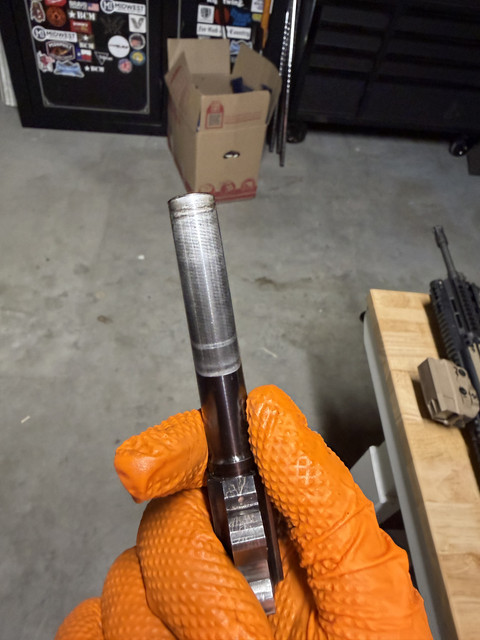

Post a pic of the top of the barrel with the slide back, the amount of wear on the barrel (known as the sig smile) will say a lot as to whether or not you really need to worry about it.  Those guns are irrationally long lived, and that doesn't look like its been shot much.
Top of barrel has similar wear.
This gun also shooting a good 6” high at 15-20 yards. I put new Meprolight sights on it both #8 which I thought was standard size but maybe not.

Originally Posted By AS556:
https://i.ibb.co/HDXsd2Xg/IMG-9569.jpg
8's are correct for 9mm. That barrel has more wear than I've ever seen. Might be time for a new one. Here's a sticky which show barrel wear and round count.
