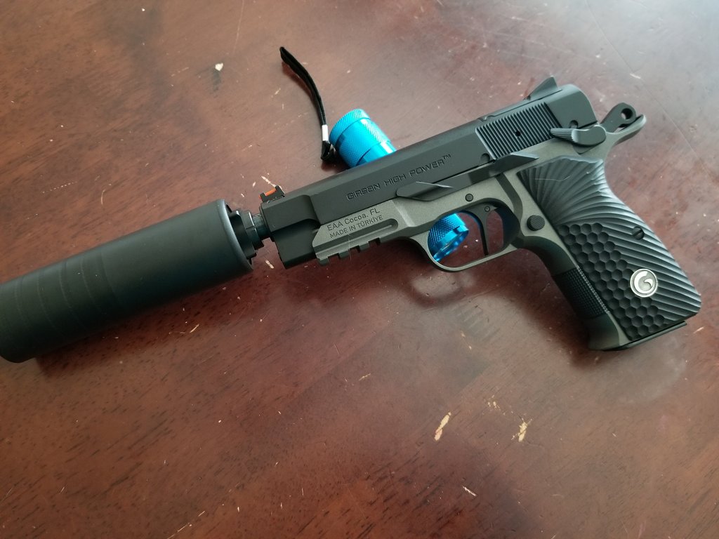

[Last Edit: November5][Edited] [#16]
Changed out the grips for some  Boone Trading Comoany.  Ordered a bunch of C&S parts as well. Now I just need to find someone that will fix the optics cut.
2/26/2024 4:00:26 PM EDT
2/26/2024 7:04:04 PM EDT
I dig the color. Is that a factory offering?
I don't know how this works, but I nominate Joker and Fluffy for arfcom sainthood.
2/26/2024 9:31:02 PM EDT
yes
