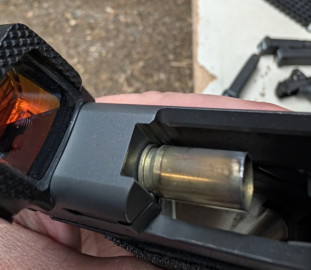

Yesterday 2:49:20 PM EDT
Welp...just got back from a range trip and this happened at the end of shooting through 2 boxes. This time I only brought Blazer 115gr since two weeks ago I had no issues with the Winchester 115gr, which had caused the issue back in July. Starting to think it's not an ammo issue. I would be inclined to think it's a slimline design issue, but I have two OG G43's and two G43 clones with thousands of rounds through them and haven't had this issue. Time to call Glock CS?

Yesterday 3:00:28 PM EDT
Did we ever determine if the extractor spring and plunger assembly is installed correctly or not?
Preferred Pronoun: Space Lord Mutherfucker
Yesterday 3:39:27 PM EDT
@HeavyMetal
Yes, I did a complete disassembly of the slide before I went out two weeks ago and all was A-OK.
Yesterday 3:43:06 PM EDT
Spring-loaded bearing touches backplate, metal end touches extractor.  Metal on metal and plastic on plastic.  If it's backwards, it can cause malfunctions like you are experiencing.
Yesterday 3:50:36 PM EDT
Correct, that's how it came out when disassembled and how I put it back in on reassembly. Just checked once more after your post to triple check.
Kind of wishing I hadn't ordered a second 48 last week and just got a 19.6. I like carrying the 48 over a 19, and I actually shoot it better, but now I having second thoughts.

Yesterday 5:06:29 PM EDT
[Last Edit: craig24680][Edited] [#28]
https://i.ibb.co/9949rpC0/cccvvv.jpg" target="_blank">https://i.ibb.co/9949rpC0/cccvvv.jpg
@craig24680
thats crazy it keeps happening to you. Sill only once for me.
I would contact Glock and see what they have to say.
I stripped my slide and found my inards to be properly installed from factory.
