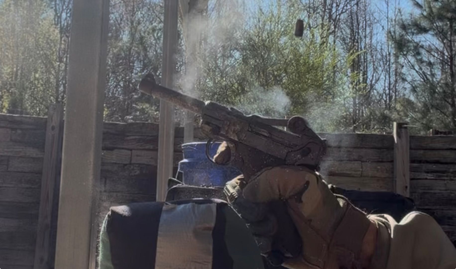

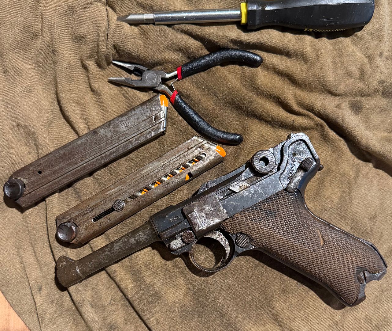

I’m in the functional/shooter stage after disassembly/reassembly of a 1917 Erfurt that spent decades in an attic in a holster.

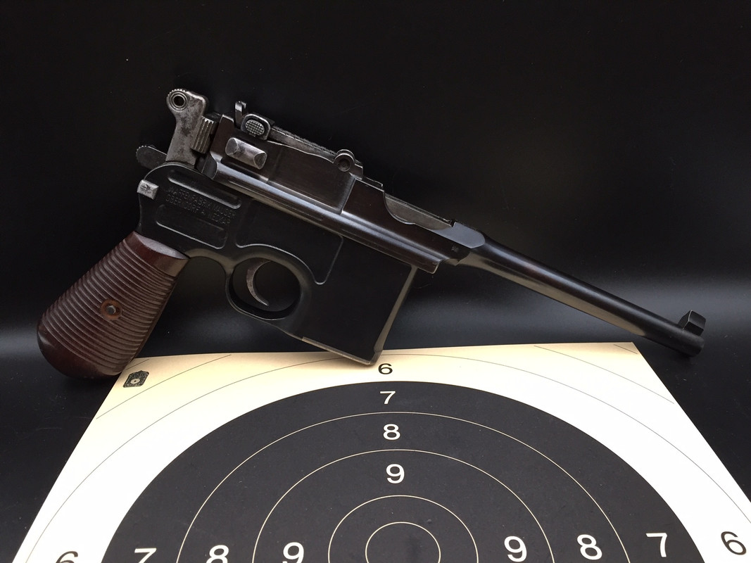

Mark Lee Express Blue #1
From this
To this:
From this
https://i.postimg.cc/6pcJWwvc/Mauser_C96.jpg
To this:
https://i.postimg.cc/WzyfQCWn/Mauser_C96.jpg
That turned out PERFECT.
You should do this for a living.
Thanks,
rust bluing is very labor-intensive but it can be done without expensive equipment. The preparation is basically degreasing and sanding the surfaces. One does not need to even sand it with very fine sandpaper, since the bluing can adhere better to the "teeth" in the surface.
The number of applications will lead to a darker and thicker blue, since each application forms a new layer that also has to wear down individually.
