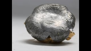

Test Gun: Sig P229, Beretta Nano.
Barrel length: 3.9, 3 inches.
Ammunition: Federal 9mm 115gr JHP +P+.(9bple)
Test media: 10% Clear Ballistics Gel.
Distance: 10 feet.
Chronograph: Caldwell Ballistic Precision Chronograph G2.
Five shot velocity average: 1234, 1188fps
Gel Temperature 71 degrees.
Many of you reading this will be familiar with this round. The 9bple as it is so often referred to. At this time the price is not much more than some FMJ practice ammo that's available. SG ammo probably has the best price right now at around $15 a box when it's in stock. It shot well out of both guns at 10 yards.
Out of the P229, it had an average velocity of 1234fps with a high of 1249fps and a low of 1223fps.
In the Nano, I got an average velocity of 1188fps with a high of 1201 and a low of 1175fps.
Starting with the P229, the first round had a velocity of 1251fps and penetrated to 9.5 inches. The bullet expanded to .69 inches and had a recovered weight of 114.8 grains. Round two's velocity of 1244fps, penetrated to 10.25 inches, expanded to .66 inches, and a weight of 113.8 grains.
Through the clothed covered gel the first shot penetrated 13 inches and expanded to .61 inches at a velocity of 1217fps and had a recovered weight of 114.2 grains. Round two hit the gel block at 1257fps and penetrated to 17.75 inches. It expanded to .53 inches and had a recovered weight of 113.8 grains.
Out of the Beretta Nano, the first round had a velocity of 1183fps, penetrated to 11.75 inches and expanded to .63 inches with a recovered weight of 113.9 grains. Round two's velocity was 1158fps. The bullet penetrated to 11 inches with .65 inches of expansion and a recovered weight of113.9 grains.

Great test. Interesting that it actually performed better through the 4 layers of denim.
Overall, not optimal, but still great performance - especially for the price. 9BPLE can be bought for $0.27-$0.30 per 1000rd, vs $0.45-$0.60 for Gold Dot/HST.

Yes, bare jell pen is shallow but dang, that expansion. I would certainly carry this again if HST were not available.

It seems like a lot of these older 115 grain JHPs start to shine in the shorter barrels that a lot of folks are carrying these days. The lower velocities retard the expansion just enough to get awful close to 12 inches of penetration in bare gel.
Overall not too bad performance.
