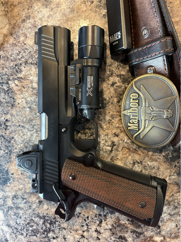

Chambers RDSM by Dave at Defensive Creations. Got a great 15 yard zero on it and burned through 250 rounds in no time flat. Super fun gun to shoot.

That's a good looking gun. I'm in the process of building a 5" single stack myself
7/21/2026 8:15:38 PM EDT
Have wanted one for awhile now, I have multiple 9MM 1911s and just can’t get myself to pull the trigger on that kind of $$, very nice looking gun by the way.
7/21/2026 8:58:34 PM EDT
I have the CCU CCO in 9mm.  It’s great gun.  Super light recoil.  My only complaint is the edges need to be dehorned but the frame is lightweight and Colt won’t work on them in the custom shop.  I wish I also had the railgun version.
https://www.ar15.com/media/mediaFiles/425157/IMG_0655_jpeg-3799044.JPG
My biggest gripe about the gun was how poorly fit the trigger was. That thing slopped around in there like it was nobodies business. The thunder mountain trigger was pretty much drop in with minor adjustment to the pre travel tabs. Breaks clean at 3.5lbs with perfect pre travel and over travel. Light but still serviceable as more than a range toy I think. It was converted to 70 series due to the optic cut but, I believe the firing pin block could be preserved by drilling through the optic plate and maybe shortening the “cup” on the top of the firing pin block. Then the spring would just sit up against the bottom of the optic. Anyways, fun little project and it’s a slick shooter.

Looks great!  Dave does amazing work (he's done work on a few Staccatos and a revolver for me).  Hope it serves you well!
8/31/2026 11:53:04 AM EDT
Man it looks great.  I have the same complaint about Colts being so sharp everywhere.
Where did you get those grips?
They are older Springfield cocobolo units.
