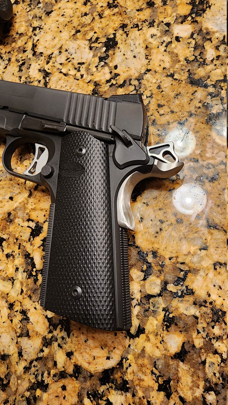

I have a 1911-X. The little pad on the grip safety is exactly that - little. I want to swap it out for one with a bigger pad like this:
https://www.nighthawkcustom.com/parts-and-accessories/main-safeties/sdp1060-drop-in-carbon-grip-safety
I am not a 1911 guy. That says "drop in". Is it really drop in or will it require fitting? If fitting is required how difficult is it?

Drop-in usually means that the gap at the frame tang is large to ensure it'll clear a larger variety of firearms as they're different radii or lengths.
You'll probably have to fit the arm on the grip safety to your trigger bar.
Yep, like this:

Thanks for the replies.
Tuning it makes sense. IDK if there was more to it though.
I think I need to contact them to make sure it will work with a Series 80 gun?

I’ve had to “fit” a EGW one before.  The tits at the bottom were too thick and that made the safety be “off” until they were filed down letting it free up the safety to disengage.  Easy task once identified.

That NHC grip safety you linked is cut for Series 80 compactible. Just be aware, it may not match exactly to Sig frame tang at the top and bottom as the degree of high cut might be different on every brand even though it might drop in. So it may also require some polish work if you want them to be more OEM look.
Example of Ed Brown grip safety on Kimber frame, just to illustrate what I am talking about. Again, you might be lucky, you might not. Aftermarket parts maker cannot design parts to be one-size-fits-all. In this case, without remove the bottom of the frame tang excess, it becomes uncomfortable to shoot without wearing glove.

There are quite a few youtube videos showing how to properly fit one

This is important to consider. Fitting it to function is different than fitting to be comfortable and/or aesthetically pleasing. The later being as much an art form as it is a technical skill.

Not a 1911 pro, but have tinkered with a few.  Another thing I've done personally is slightly tweak the grip safety spring, bend it a little to make the strength needed to squeeze the grip safety a little bit more.  For me that helps encourage a firm grip.  Doesn't take a lot.

I have fit many grip safeties, mostly from NHC.  If you know what you are doing, it isn't hard to fit one for function.  But, a file stroke or two too many and you're out the cost of the part.  Off on the angle and a lot of things can go wrong and make it unsafe.  I would recommend having a professional fit it if you are not comfortable with the risks.

The most function-critical part is fitting the blocking surface at the bottom of the grip safety arm.  Don't cut it too close or as someone said, you could ruin the part.
Depending on the gun, you may have to fit the bottom tabs that interact with the MSH.   Sometimes they are too long or too thick.
I've also seen instances where the grip safety is too tight to fit into the frame without dressing down the sides of the GS.   There are several other places that may need fitting too, but it all depends on your gun and the part.

I've replaced one, but it was to drastically reduce the speed bump.  As stated, frame radius, safety tab and MSH interface all has to be right.  It is fairly simple.
