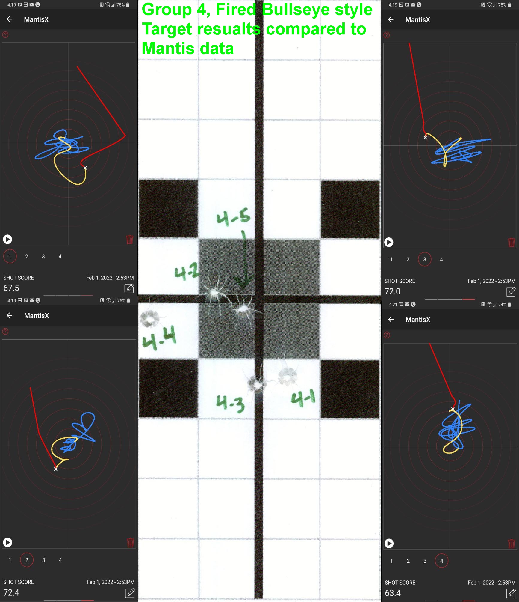

As you might expect, I took some data on Mantis X use on the handgun. First, I have the shot readouts and the target for 4 live shots fired. I have picked just one of these to share as an example. I'll let you know right off the bat this isn't Mantis's best target: it's actually one of the worst. However, because one shot was deleted either by a glitch in the program or perhaps a fat finger, it is the only one with four shots instead of five or ten and therefore makes for a nice symmetrical, image when you add the Mantis shot tracking screens. As you can see on the image, Mantis didn't do a great job of calculating where the shots landed on the target based on its accelerometer readings. Mantis was quite close on the first shot of the string, but not on the other three. Incidentally, its call on the fifth, and best, shot of the group was actually the worst of all, but Mantis was embarrassed and so deleted its record of that one for me.
Four live fire shots with the Mantis X10 elite system and the target showing where the shots actually hit.

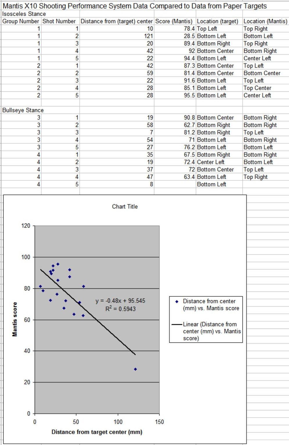

Looking at these shot readouts had me wondering whether Mantis was any better than chance at deciding where you intended to aim and then placing your shot where it actually landed. There are a number of different statistical ways of calculating this with varying degrees of difficulty. I went with a very simple one. Mantis gives you a "score" for each shot indicating how close to the center Mantis thinks that shot. I can, of course, measure how far from center each shot actually landed as I had recorded during my shooting session which shot was which on the target. There should be an inverse correlation between these two numbers for each shot as 100 is the maximum Mantis score and 0 would be the minimum distance from center. So, I took the data from one of my shooting sessions and ran this correlation. This resulted in the below table, chart, and best fit equation. An R^2 value for that equation of .594 means that, mathematically, the linear relationship of best fit calculated between the Mantis score and the measured millimeters from the center of the target, explains 59% of the variance in the data. I would confidently say therefore that Mantis is a good bit better than chance at figuring out where you intended to fire a shot and where it went. Beating chance is, of course, the lowest possible standard for some measure of success. You can see from the above target and shot plots that, while Mantis is better than chance, it is not what anybody would call excellent when it comes to figuring out from accelerometer data where shots were intended to be fired and where they landed. This matters because, as mentioned before, the advice Mantis is doling out to improve you shooting is based on the same advice commonly dispensed using the diagnostic pistol target, which is a diagnostic system entirely based on knowing where on the target the shots are landing.
Table and chart containing Mantis X data on 19 shots from two stances and target data for those same shots.
Here I should talk a little about quadrants and the nature of the diagnostic pistol target mentioned earlier. This target originated in bullseye pistol, a discipline requiring one-handed shooting and utilizing a specific relaxed and upright stance. This is also the only pistol discipline I have any training in so keep my relative novice in mind throughout this review. Your not getting the thoughts and opinion or either a champion or an experienced instructor here. I utilized the bullseye stance in about half of the rounds fired on the particular range day the data of which is shown in the above table and chart. Being one-handed, the bullseye stance is not one of the more commonly utilized shooting stances. Different, and more common, handgun shooting stances, such as Isosceles (used for the other half of the shots I fired), Weaver, and Chapman, feature two-handed grips and entirely different forces on the gun resulting from their two-handed nature as well as the specific geometry of each stance. It is my opinion that shooting results from these stances to do not correspond as well to the diagnostic pistol chart as those from the bullseye stance. You can also see from the quadrant information in the table that the Mantis frequently makes errors in measuring the direction a shot deviates from its intended mark. Given that the advice the Mantis gives you is based both on the direction the shot deviates from center and a chart specific to a one-handed bullseye shooting grip, that advice is often going to be incorrect for one or both reasons.
