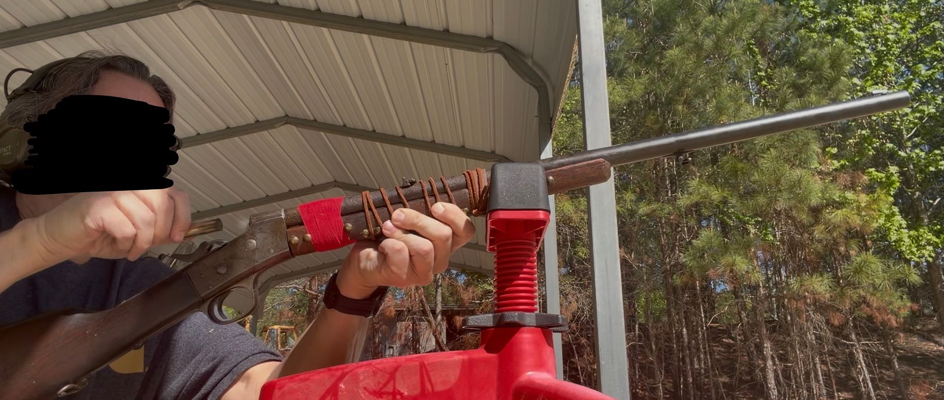

I load 12.7x42 centerfire for my great grandfathers Rolling Block.

My rolling block was originally 12.17x42 Rimfire.
To shoot my options were have the block redone to center fire, or find a center fire block and fit.
I found a block and fit.

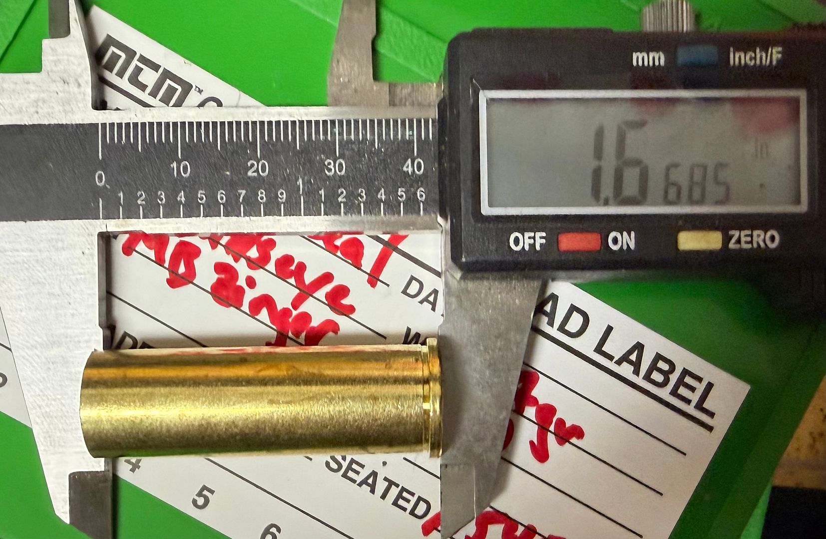

I trim 50 Alaskan to 1.65inch for it.  OAL of 2.0”.
I just assumed I would need a long frame, in 50 Alaskan.
For comparison, 44 mag, 45 colt, and my rolling block ammo.
Thinking more,
My 50 Alaskan Starline brass is 2.1”
I cut it to 1.67 inch
Then quick fine trim and chamfer at 1.65” / 42mm
My OAL Hornady Great Plains 385 grain is right at 2.0 inch.
When Husky converted rimfires to to center fire in the 1800s, some would not quite chamber 44mm brass.
Mine does case right at 44mm but no issue trimming to 42.
So, I could either trim brass about .1 inch more or sear 0.1 inch more- or some combo of the two.
Like an OAL of 1.8” or so, shoot my rolling block ammo in my rifle and also in the 5 shot short frame BFR.

I have made ammo and only shot the old gun about 50 times.
Even then, the modest recoil is hammering the buttstock and rattling loose the forestock.
It’s 150 year old wood.
When I got it the leather wrap holding on the cut down/previously cracked foresrock was dry and cracking off.  The trade cloth was a tracing paper thick disintegrating into dust layer.
In the decade since then, just being a wall hanger, most of the leather had broken off.
Under the forestock, which is just the front half, the back half must have cracked and been cut off, was a smelly resin/lead block to “fit what used to be the middle of it to now the rear of it.
The military sight has been replaced by a three folding leaf.  A front sling mount had been soldered on the barrel.
I don’t have the right barrel ring, but I do have a much better condition front and rear stock.
Using that would take away the decoration my great great grand father had done and were on it when my great grand father got it.
Some say I should have left it as a wall hanger.
I elected to let it shoot again.
I have an unhealthy desire/fetish for handgun/rifle pairs.
I’m pushing 60, have a ton of other guns, and realistically will maybe take it out once a year and shoot five through it.  There is no practical need for me to have a handgun to go with it.  I just want to.
