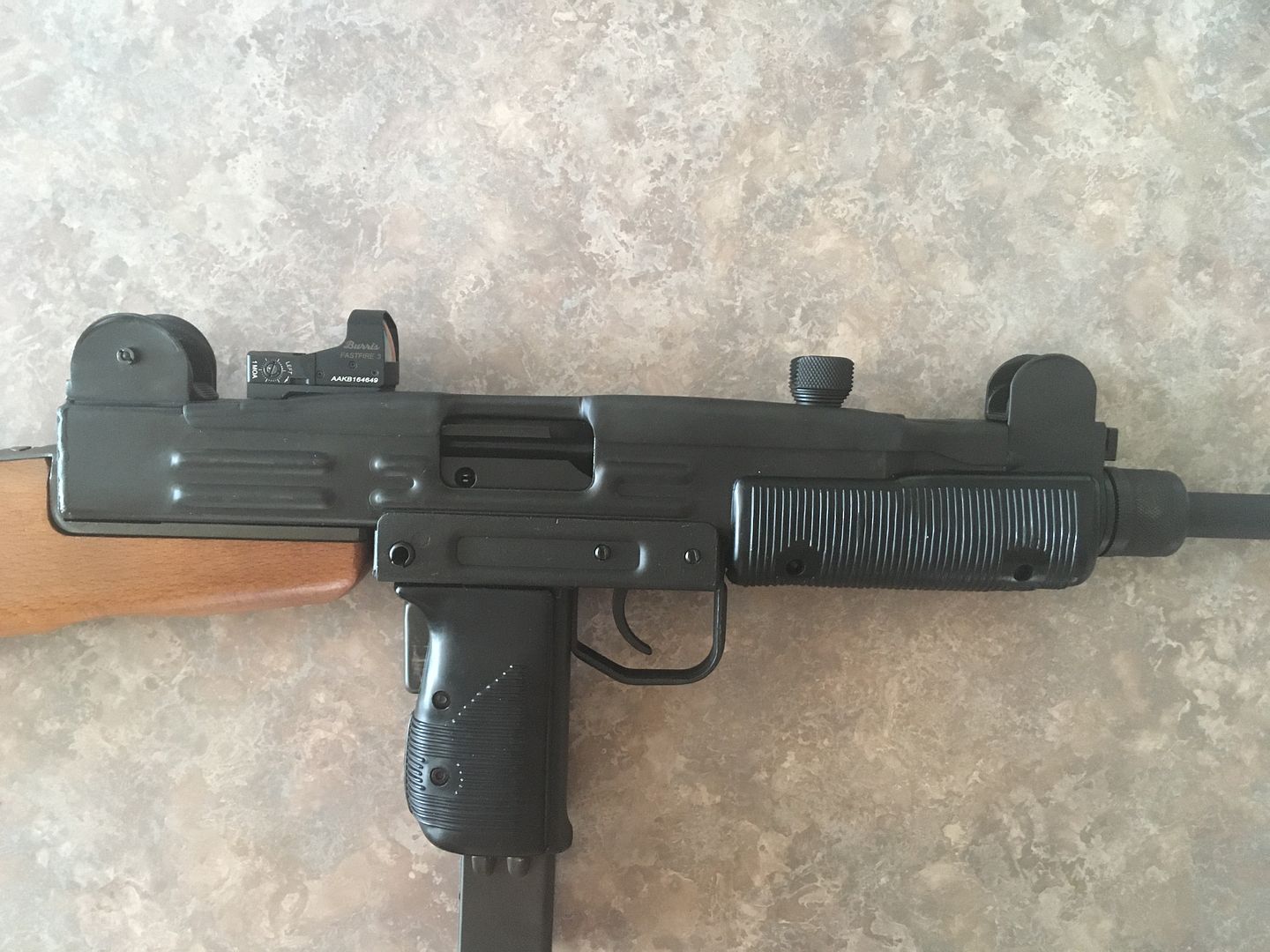

For example I have an Uzi and an MP5, both set up with red dot sights, a Burris Fast Fire in the first, and a Holosun 507C on the second.  Both are "Parallax free", but on a PDW/SMG class of weapon where they are commonly employed from 5 to 100 yards and can reach out as far as 200 yards, at the longer ranges you'll encounter some parallax.
Both of them are set up so that the dot co-witnesses through the iron sights, and at longer ranges, doping so pays off in noticeably better accuracy.
The MP5 will for example shoot 2.5 MOA out to the 185 yards where the bottom of the reticle zeros.    But that's also an artifact of bedding the mount to the rifle and ensuring there was zero play between mount and sight.
As a single claw mount, this meant using neutral shoe polish on the receiver and then filling the recess in the mount so that when clamped into place the epoxy bedding compound took up all extra play and ensured zero movement.  Dye it black and wipe off the  excess that extrudes out for a neat and clean installation.
In the case of the Uzi, the rds is mounted on the top cover, which isn't the most consistent base, but keeping the dot on the front sight post still serves to keep your eye in the same spot shot after shot and still minimizes any long range parallax.
