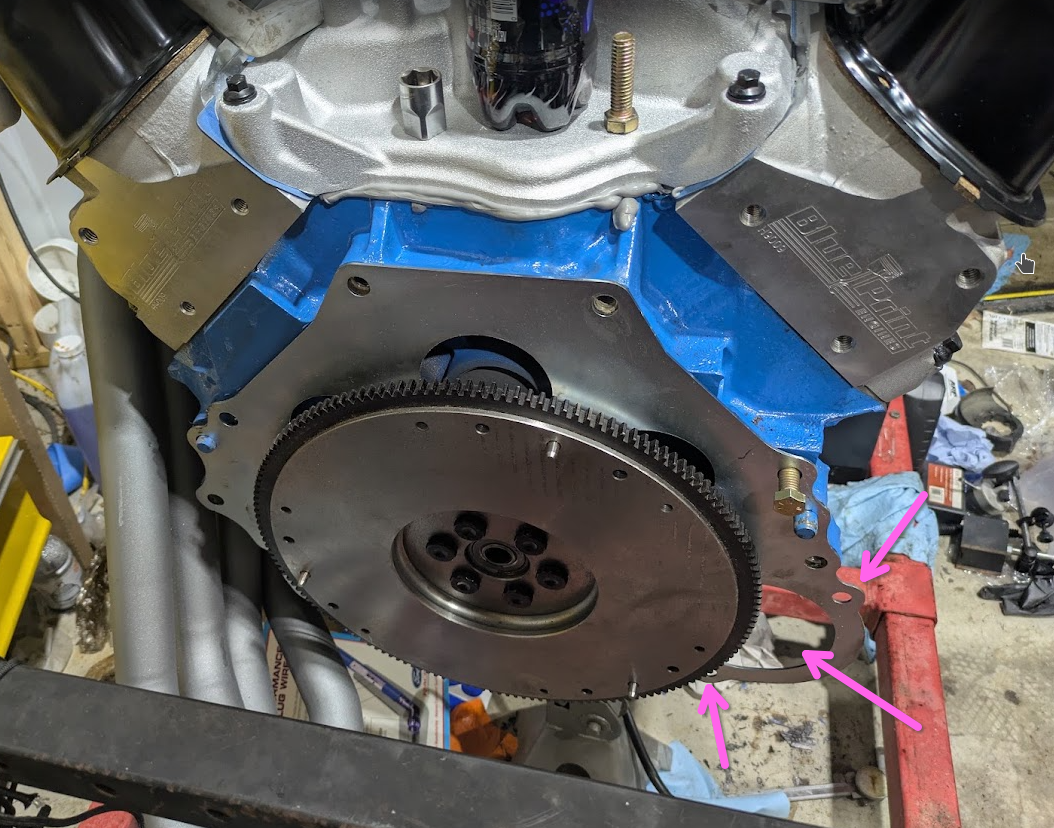

This wouldn't be the problem....would it?
To say that you are on thin ice would be a vastly optimistic view of your current situation. The ice has melted. You are being supported by the surface tension of water.
https://www.ar15.com/media/mediaFiles/135/20260905_152621_1_-3822658.jpg
Dam - is that the block plate that appears someone hacked-up?  What the fuck for???  Yeesh…
yep it is.. and it tells me they didn't find the real problem.
How does one determine whether or not he has a 157 or 164 tooth flex plate..I'm wondering if the one on the engine is the right one.

That block plate has left the chat.

The bold part alone could explain it.  On a chevy 350, the starter bolts have a knurl to them.  The knurl keeps the starter and the engine block aligned.  On a ford 289, there is no such knurl.  The starter bolts to the bell housing.  For 1, whatever clearance there is in the starter holes will allow the starter to move up/down and side to side.  It is the block plate that keeps that from happening.  The plate has the hole that the starter indexes in.  And second, the missing 1/8 inch thickness or whatever it is will cause the starter to sit closer to the bell housing.  That also puts the starter gear closer to the flexplate gear front and back.
That missing chunk of the block plate acts as a locator and a spacer.
They may have had the incorrect starter in the first place, and cut the block plate to compensate for it.  On older fords, different starters had the gear sticking out different distances.  Could be he was a cheap bastard and rather than buying the correct starter, he used what he had on hand and cut the chunk out of the block plate.
Worth noting that the inspection plates are paired with the block plate.  So if you get a block plate for a C4, and you have the inspection plate for the C6, they may not fit together.  There are also oddballs like if the car is column shift or floor shift.  The car doesn't actually need the inspection plate to function.  But its always nice to have the correct cover.  If you're pulling parts off a parts car at the pull-a-part yard, get the inspection plate that matches the block plate.

But no, his photo shows a slot for the inspection plate/torque converter bolts at the bottom.  That looks like whats left of an automatic block plate.

First, you're gonna have a hell of a time bolting the torque converter to the flexplate with a solid block plate.  That inspection plate is the big access hole for you to connect those 2 components together.
Second, the block plate needs to match the tooth count of the flexplate as well as the transmission bell housing.  157 and 164 tooth bell housing will obviously have the dowels and the bolt holes to connect the transmission to the engine in the same place.  They will not have the starter locating or mounting holes in the same place.   I didn't catch which transmission you're planning on connecting this motor to.  But the bellhousing on that transmission is gonna be one of the big deciding factors for some of the other parts.
Here's one of mine.  This is setup for a manual transmission, but it shows the holes that are of concern.  The starter locating and mounting holes are over on the passenger side with the pink arrows.  On the 164 tooth bell housing and block plate, those stick out further to the passenger side of the motor.
