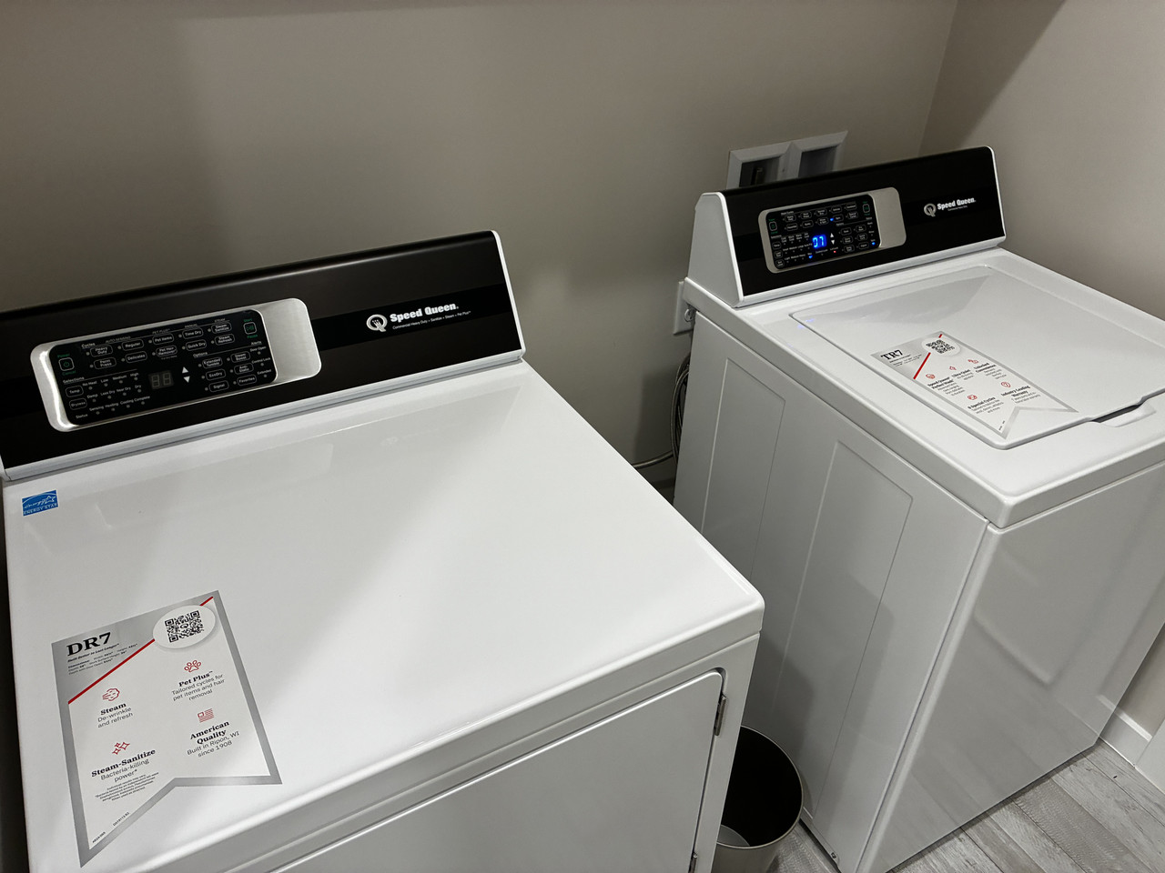

We bought the Speed Queen FF7 and the matching dryer.  Yeah, it was just under $5k for the pair (gas dryer), but I don't think we'll need to replace them ever.  After the 5 year warranty is up, I plan on just repairing them myself if needed.  I have filled the FF7 a couple times just to see what it can do, and it handled it well.  Generally we don't use it to full capacity, but being a front loader, it does use less water.  But, our water is fairly cheap (for city water) and we do have a minimum cubic foot usage each month that they charge us even if we don't hit it.

They’re not real knobs and switches. They’re the same as my SQ above in a different form to satisfy “knobs and switches” people.

We paid a bit more for the digital model.  Sturdy components, but the digital controls are a waste of money.
