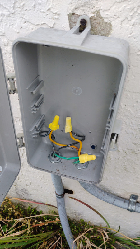

Going to install an indexing valve and a timer to my sprinkler system. It looks like they ripped the guts out of the original timer. But took a look in the box yesterday and saw there were only two wires running to the pump. The breaker box has a double breaker (two 20amp breakers) for the pump so I'm going with it being a 220v pump but I was expecting to see a black/red/white set of wires but there are only two coming in with a ground. The yellows coming from the breaker box and connecting to the blacks to the pump. So looking at schematics and I see that this is another standard wiring set-up for pumps.
Anyone want to take a stab and explain why you would wire this using the ground wire instead of a neutral (white) line? Otherwise, will this timer that I ordered work with this set-up? The pump is a gator 1.5 hp irrigation pump.
Does it matter which of those yellow wires I use as L1 and L2 when I'm hooking up the new timer?

230 VAC doesn't require a neutral, unless you want to split out 2 120 VAC circuits. The actual power is on the 2 legs, the ground is for safety.

This, except that in this country, it's 240 volts, not 220 or 230.
Some 240 devices, such as ovens or driers, use 120 volts for the controls and 240 for the heavy load.  That's why they require a neutral.  Either leg to neutral = 120 volts.  Leg to leg = 240 volts.

Got you. Thank you for the explanation.

Does  it matter which wires I use as L1 and L2 since they are not color coded properly?
Nope.

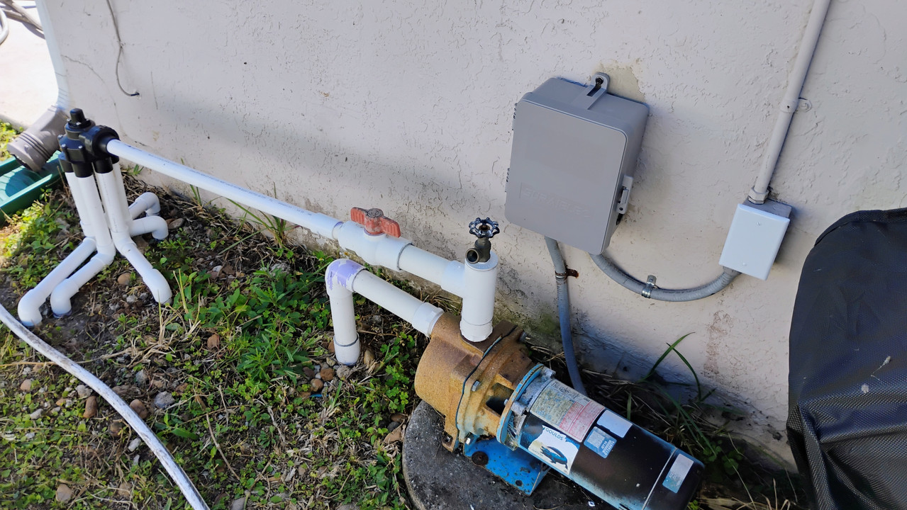

Only thing I really noted that was messed up was it looks like the ground wire was not actually grounded back to the panel. Even though it is connected in the picture it went went back to a gang box that had an on/off switch for the pump. The ground was just hanging loose in there. So I grounded it to the box and got everything hooked back  up.
Almost professional looking. Grand total for valve/timer/PVC... about $85.

Nice work.  Happy ending.
