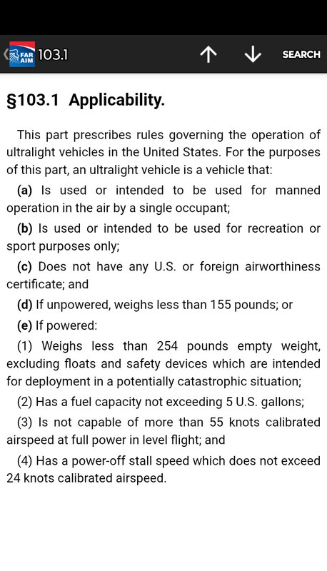

2/22/2026 8:19:21 PM EDT
Originally Posted By _DR:
The reason performance is abysmal on all ultralights is because the FAA mandates it, if you're going to adhere to Part 103.. top speed, HP, stall speeds, fuel capacity, it's all stipulated.
As far as I know, only top speed, empty weight, and fuel capacity are limited in Part 103. The power (h.p.) or stall speed are not specified in any way.
Unfortunately, the dry weight limit is very strict - only 254 lbs. For this reason, it's very hard to find ultralights with 4-stroke engines. The most common of them is Legal Eagle.
2/23/2026 12:07:39 AM EDT
[Last Edit: _DR][Edited] [#12]
You're right about the HP but the power off stall speed is definitely stipulated.
I had to look it up...I knew I saw it somewhere..here is it straight out of FAR/AIM.
