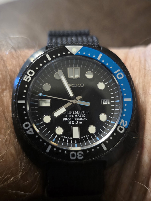

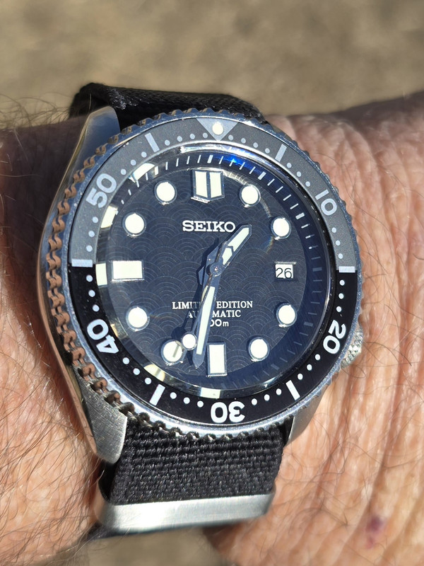

"MM200"
Btw i hate all of you!

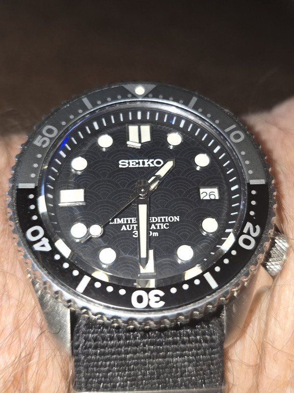

Here's a turtle I built some time ago.

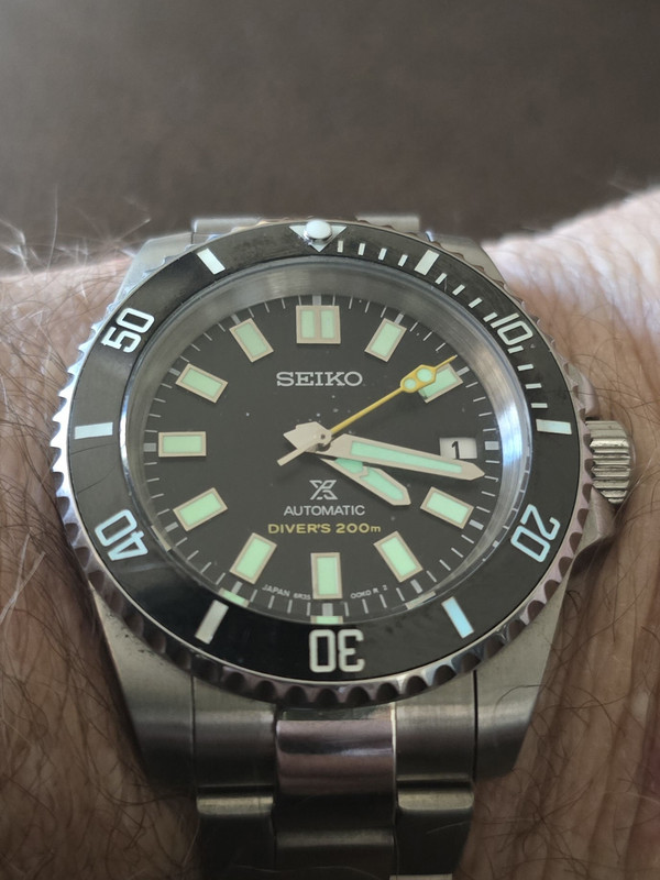

[Last Edit: NickOTime][Edited] [#8]
"Willard"
Nah, was getting sick of only having "serious" watches.  So I decided to brake the winter doldrums with a more "fun" piece.  "Why so serious?!?"  Was what I was going after on that little feller.  Plus I figure it will double as a kookie little spring piece too.
Built up the "willard" however to contrast/balance out the sillyness of the "mm200".  A little ying and yang action.

2/13/2025 4:58:08 PM EDT
Originally Posted By NickOTime:
"MM200"
https://i.imgur.com/R4Kwymu.jpeg
https://i.imgur.com/Ig5GAWz.jpeg
"MM200" is great looking.  What a fun combo.
Illegitimi Non Carborundum
DEXAI

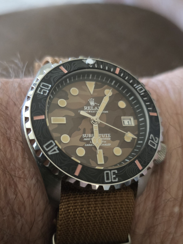

I have a thing for orange.
Just completed.

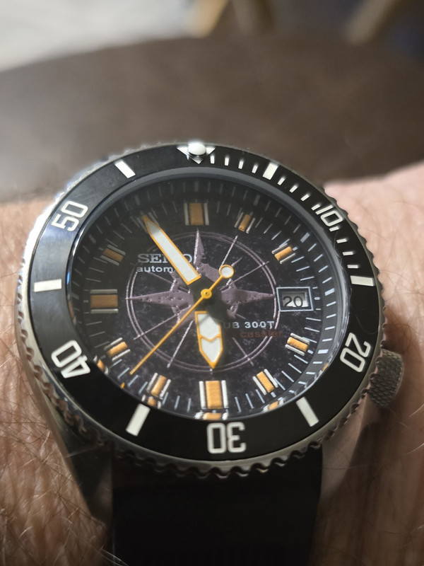

"Explillard"
It's too grey out today to get the green rocking on this one.  But it's got a subdued green leather single pass and subdued green sunburst dial.  I really do enjoy how the color plays with it depending on lighting.  It will go from green to grey/charcoal/almost black and sometimes it even goes a bit towards the brown/khaki spectrum too.

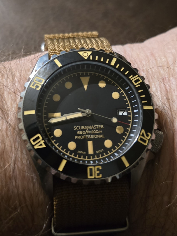

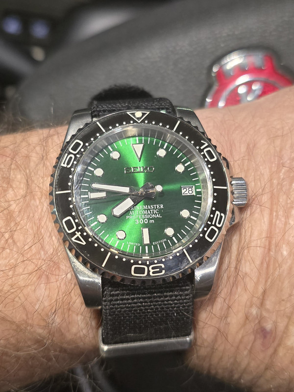

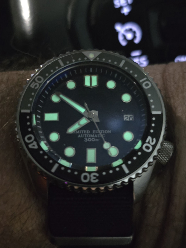

I used a dial I've had laying around for awhile. NH35 is ticking nicely. I had to slow it down just a touch to keep perfect time.
Lume is awesome.

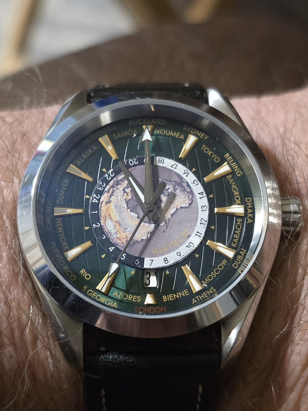

I am running out of ideas on what to make. I've made a few chrono's lately, and just the one above.
I'm starting to wear one, and getting it regulated to right to the second on keeping time. I found using a machine to get to the second accuracy, isn't as good as wearing one and speeding up or slowing it down with how it varies in different positions.
Get it figured out, and get the next one out of the case.
This one's been sorted out already so it's a joy to see it ticking right to the second.

6/2/2025 11:10:08 PM EDT
[Last Edit: NickOTime][Edited] [#42]
Maybe finished on this one, but also might pop her back open to switch the seconds hand.  As the lume is the wrong color.
And a new strap for this guy.
Eta:  replaced the whole handset.  Hadn't noticed how much I marred up the hour hand until I posted that pic last night.
Lume shot:
Not sure about how I feel on the differing lume shades and I think the seconds hand is a bit askew.

6/16/2025 2:35:07 PM EDT
Did away with the ceramic bezel insert in favor of an aluminum and I think I'm finally content.
6/16/2025 4:19:24 PM EDT
https://i.imgur.com/sHrqO5c.jpeg
Where did you get the strap? I like it
6/16/2025 4:53:08 PM EDT
[Last Edit: NickOTime][Edited] [#46]
Was going to say something about it, but was nearly embarrassed at how much it cost.  I've been eyeing one up since I first saw it about a year or so and finally found one at a "decent enough price " after haggling a bit.  Still a bit much unless you are a die hard Seiko fan boi imho.
It works in the same way the Marathon natos work, where you pull it over the second keeper to tuck under the 1st one.
It is the Seiko Seichu strap that iirc comes on their JDM/SLA models.
So it has 2 keepers.  The floating one is taller than the fixed one:
Then it folds over the top to pull tight on the floating second keeper, similar to a zulu system:
I tend to run mine backwards and through so this was a tad different:
I also usually cut off this lil tail to turn it in to a single pass:
Its pretty decent quality, but they start out at about $180 for a nato.  Im usually good spending about $11-$20 so for a nato that's a bit much.  Metal bracelet and clasp is a different story but for a nato.....
7/5/2025 4:27:01 PM EDT
Titanium skx173 build.  Waiting on an oem aluminum bezel insert and I do have a Titanium Jubilee bracelet to put on as well.  But was feeling lazy so nato for now.

Made a gmt World Timer yesterday. The inner dial actually turns like a gmt hand.

Originally Posted By teats:
https://i.postimg.cc/SND2Pwnd/20250705-230000.jpg
Dang, that is cool!  Also I love the explorer/ranger style case.  Looks sleek as all get out!  Little sleeper build u got there.  What movement allows for the face to rotate like that?
It's an NH34. The cut up, inner dial, had a center hole for an NH35 movement. I enlarged it slightly, so it would fit snug on the gmt pinion, where normally,  a 4th hand would be. I am having a problem tho. The cut dial is too thick. I have to thin it down some. It's not seating too well. If I push it down all the way, it drags on the green dial. If I lift it some, it pops off. It will work. I just have to make some adjustments. It is pretty eye catching tho.
