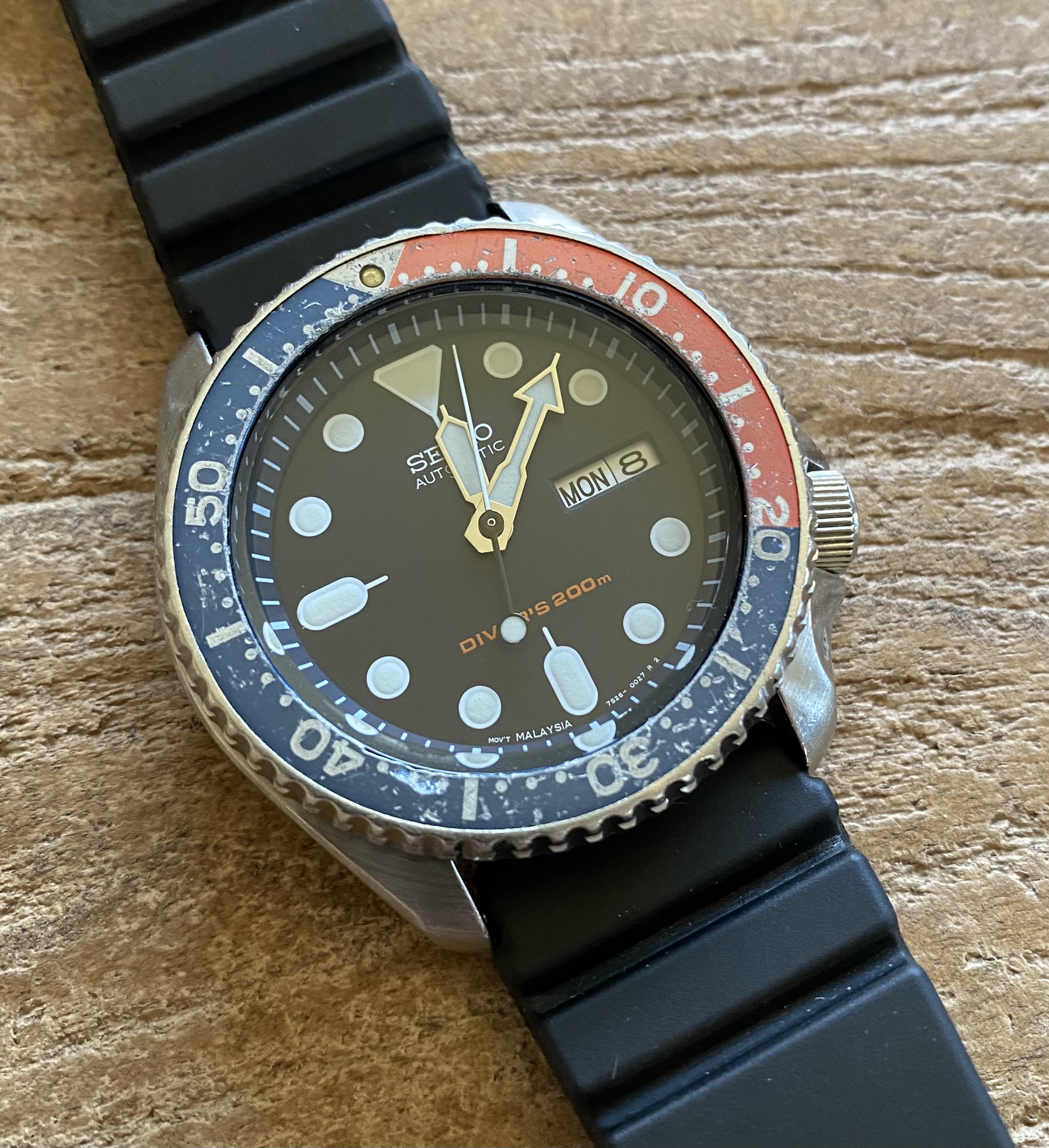

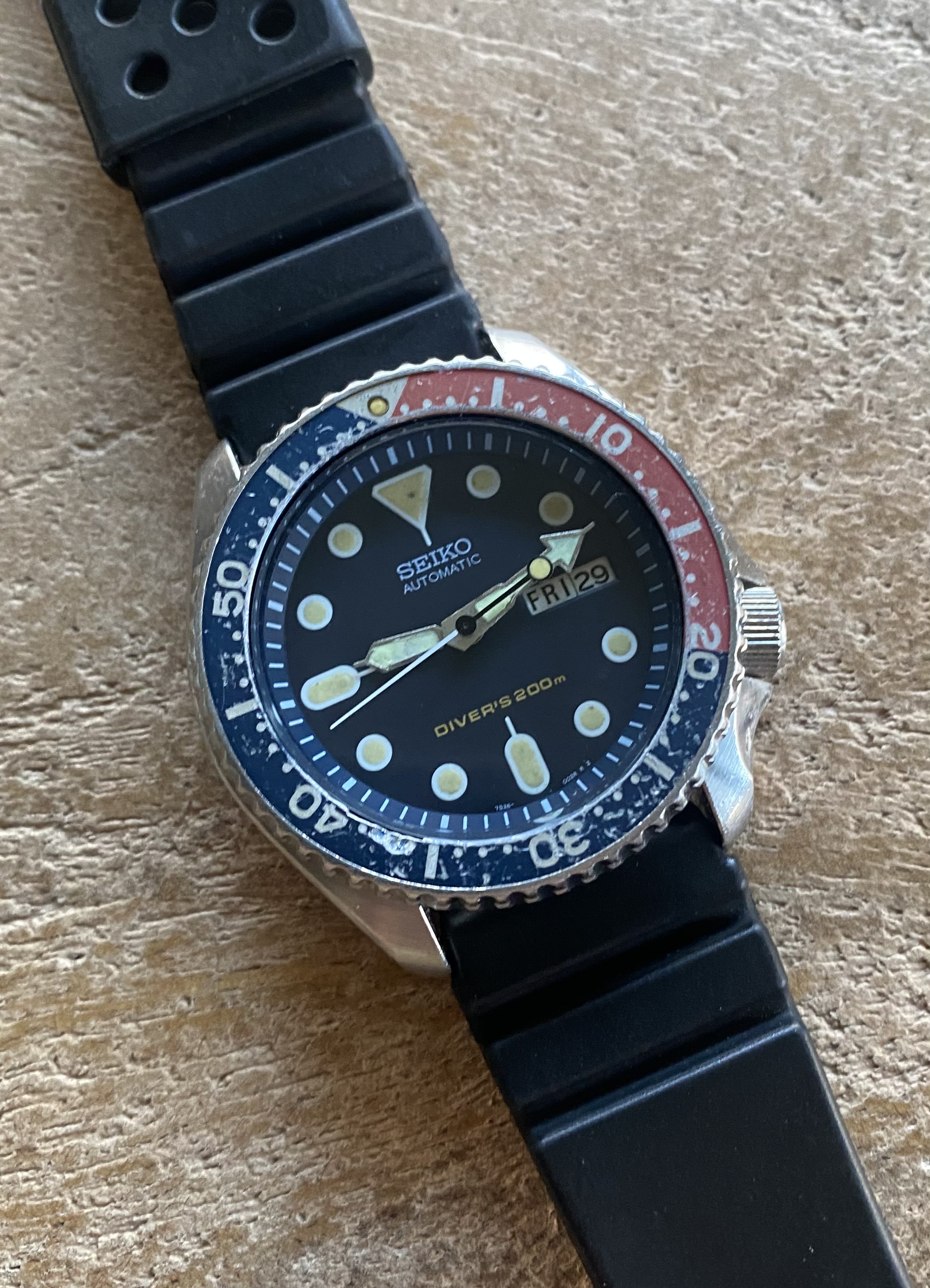

There are tons of cheap parts on ebay... a lot of it ships free from china and i haven had any issues yet.. the sky is the limit  on all the different dials hands and cases you can get for Nh35/7s26 movements
The last 4 watches I have built using NH35 auto movements are all running flawlessly... its a rock solid movement.
ETA: here they are.. the one on the right is an SKX031 that I modded and wapped out a 7s26 for the Nh35
The NH35 is my favorite watch movement. Plenty accurate for my purposes, very reliable, and cheap. What's not to like?

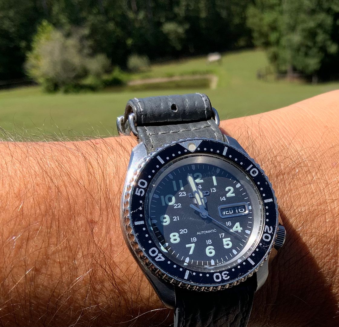

It’s been a while, but I made a mil / pilot / diver from an SKX007 and a 7S26 from the basic non diver line.
I keep meaning to do the same with an old 6309 diver case and a 6309 mil watch.
I have a couple of each lying around with the correct crown location instead of the 3 o’clock crown you sometimes see on the non-diver 6309s.

Bought this guy for $150. Original '96 SKX009 that I really just wanted for the honest patina of the case and insert. Movement ran, but it was on it's last leg. I replaced the movement with a new 7S26C, SKX175 dial, OEM hands, OEM click spring, OEM Hardlex crystal, OEM gaskets.  It's running strong at 4spd. It was a fun project.
https://i.ibb.co/BjJRdts/IMG-1306.jpg
https://i.ibb.co/Qr7x8RF/IMG-1314.jpg
Very cool, thanks for sharing.
@sgtlmj:  that looks MEGA SWEET!
