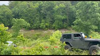

No pics or video but I used that Yankum 3/4" kinetic rope to pop a Jeep JKU out of the mud last night in the same area as that Tundra.
Did it on the 1st try. I guess it works...
Since this recovery request didn't come through the Facebook Missouri 4x4 Rescue page, I told them I would take donations, and they gave me $20.
I had just washed the mud off my Jeep the day before.
Short from the drive to meet them last night.
Haskins Ford low water bridge #jeepwrangler ##jkwillys #jeeplife

A fellow name Monty posted on the Arkansas 4x4 Rescue Facebook page that his Grand Cherokee was stuck in a gully in the back of his 6 acre property in Yellville, AR. One the of the group members scouted it out Tuesday.
Yellville, AR is about 1.5 hours south of me. I have friends in that town and have been down there before. It's very hilly. I contacted Monty and found out he was retired and working on getting his license back after a past DUI. He didn't need the vehicle out immediately and was good with waiting till Saturday. Looking at the above pics, it looked to me, like ought to be able to just drive out of that or that I could drive down to him and drag him out... Wrong!!!
I created an event on the Arkansas 4x4 Rescue page asking for other volunteers to winch Monty out. Meeting at the Monty's address at 10am on Saturday. 4 other vehicles showed up. I got there a little early and drove my Jeep down the hill to the GC with Monty and a can of gas. It was bit off camber, side hill, and I found my Jeep sliding sideways as I drove down there. Once down there, I learned why he couldn't drive it out.
The ground was all loose gravel. It's like the hill was a man made gravel pile that is overgrown with weeds & briars. My tires immediately starting digging holes in the terrain. I could turn around but was unable to climb up and out. There were trees uphill on the sides of the hill that I could winch to so I wasn't out of luck if no one else showed up. I could winch myself up to a tree, turn around and winch his GC to that spot, repeat, all the way up the hill, if necessary. That would've been a long grueling day on my own with lots of re-rigging.
The GC would turn over but not start after adding the 3 or 4 gallons of gas I brought with me. The GC also had a interlock device on it. Meaning Monty had to blow in a tube to start the vehicle. People always ask "Well what was he thinking taking his vehicle back there?" Easy answer he wanted explore his property. Hell I've taken my Jeep down a steeper grade at my lake house. I didn't get stuck and could've winched out if need be.
Thankfully 4 more vehicles showed up. Making for a total of 3 Jeeps and 2 Toyotas. Everyone started connecting vehicles the couple hundred yards across the top of the hill.
Pretty smart - using of a bottle of antifreeze as a winch damper on the steel cable.
We probably re-rigged 3 or 4 times. I had the GC (in neutral) strapped on to my rear bumper. I started off with my winch line line, hooked to my winch extension, to the white 4Runner.
You can kind of see in this 53 second video, every time I gave it gas while winching, my tires would just dug into the gravel. I wasn't aired down but I don't think it would've helped anything.
Arkansas 4x4 Rescue of a disabled Grand Cherokee in Yellville.
As I got closer to the top of the hill, my winch line was connected to a 30ft tow strap to maroon Rubicon. He was facing me with his winch line extended to the tow strap. I winched as far as I could then he winched the rest of the way. That was a smart way to do it.

After re-rigging multiple times I was finally able to drag the GC off the hill.
38 second vid.
Arkansas 4x4 Rescue dragging the disabled Grand Cherokee off the hill.
Couple pics of the top of the hill drag.
And we got him out.
It took 4 vehicles 2 hours to get him all the way out. Had it just been me there, it would've taken all day.
The extra vehicles really helped plus all the guys running up and down the hill setting and resetting the rigging.
