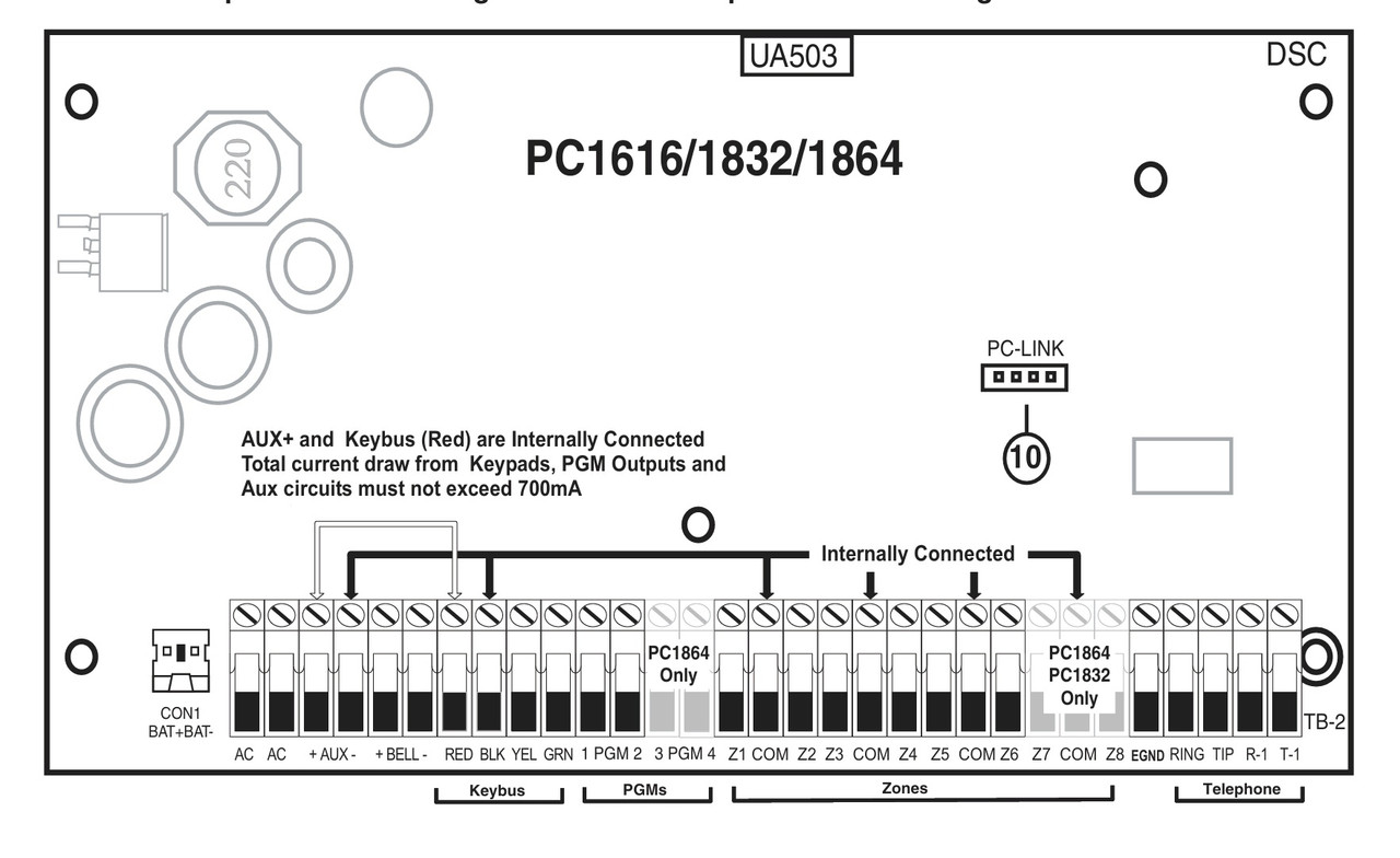

Here is the control board.

8/10/2026 10:15:01 AM EDT
https://www.ar15.com/media/mediaFiles/44438/IMG_0496_jpeg-3809060.JPG
Wider angle possible?

8/10/2026 8:34:09 PM EDT
[Last Edit: zach_][Edited] [#21]
How is this?
https://www.ar15.com/media/mediaFiles/44438/IMG_2656_jpeg-3809440.JPG
Eeeeesh. Call the alarm company that monitors your system to dig through that. There is probably a sticker on the panel with the company that performed the activation of the system.
