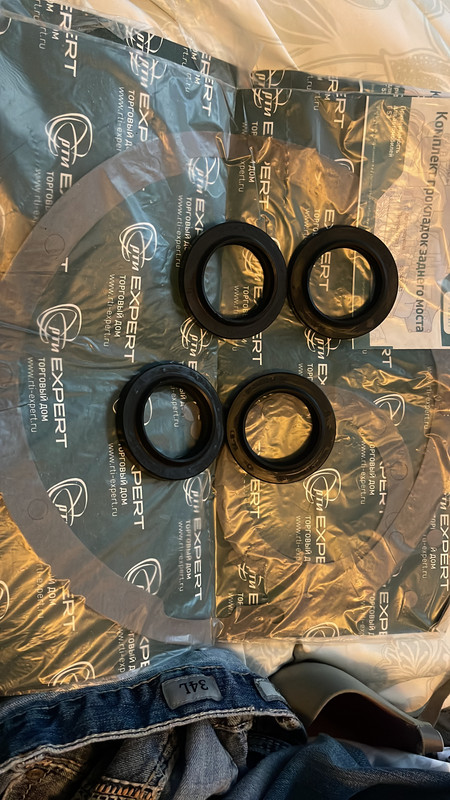

Seals arrived along with some
Extras

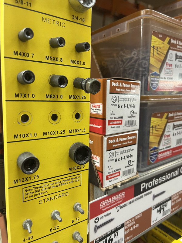

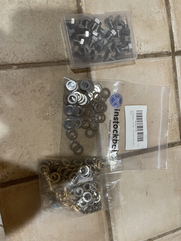

Home Depot for the bolts
They’re out
Amazon to the rescue
I will probably finish this up this week

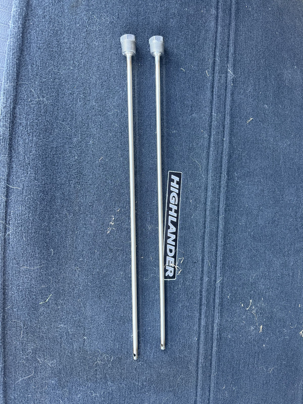

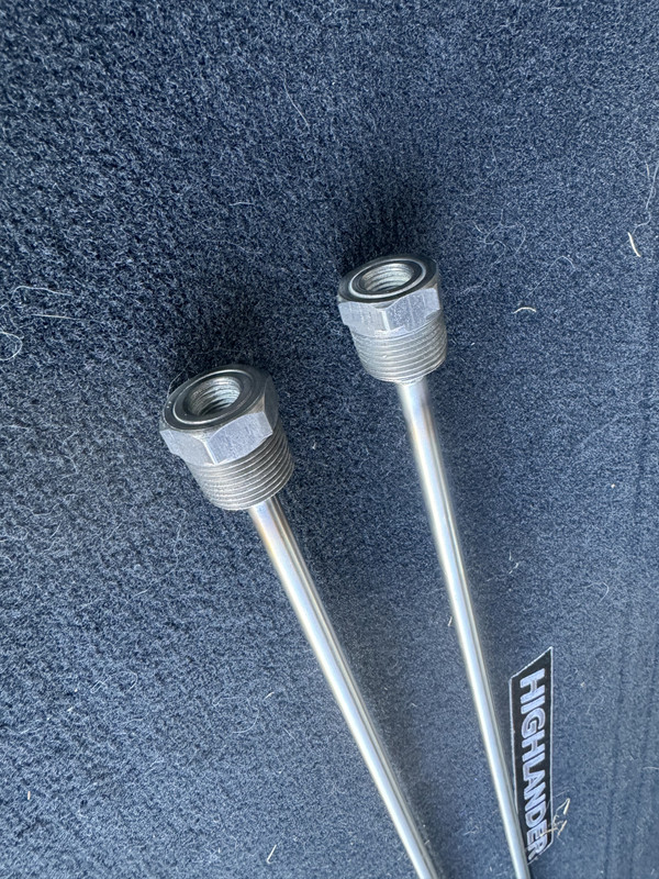

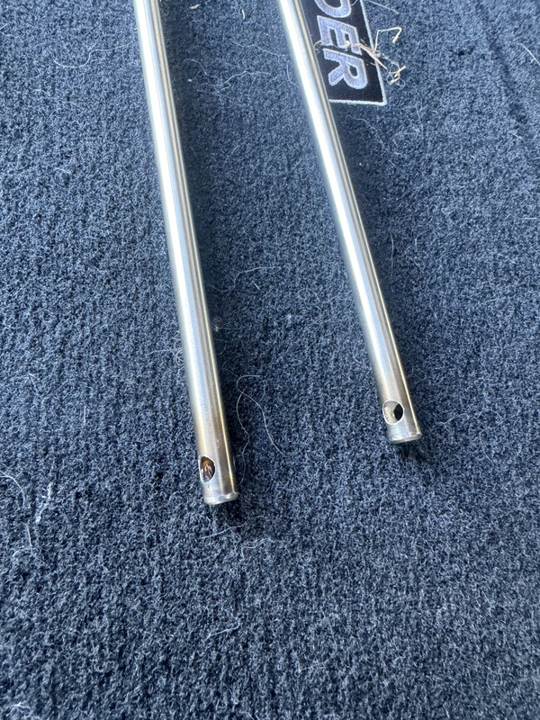

I'm getting the BRDM2 put back together in January.

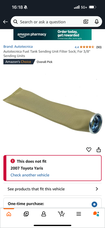

I ran into an issue with my Polish guy being obstinate and not able/willing to find the fuel pickup tubes so I found a local fab shop down the road in Granbury, Texas to weld up some custom ones. Instead of steel, it's stainless steel. No wonder it was having fuel issues!
Install one of these on each one (it has dual fuel tanks) and call it a day.

New Fuel pickup tubes are ready. 250$.
Once I get the OD of the SS tubes I will simply add a fuel mesh sock on the end and call it a day. I'm hoping it just press fits on
An update since it's been a bit (probably 4-6 months) since I've touched it. Reasons? Finances, work (20-40 hours of overtime weekly) and military stuff.
I have all the parts to complete the vehicle and put it back together EXCEPT the little fuel mesh filters at the end. Right now North Texas is going through a bit of a winter storm so it might be another week or two until I get on it.

Add this on and call it a day, ready for install
The tubes are made of stainless and I shouldn’t have any more issues with them rusting over

It can be slid on and off but seems to be a good friction fit.
Time to order another so they are completely ready

Both ready for install.

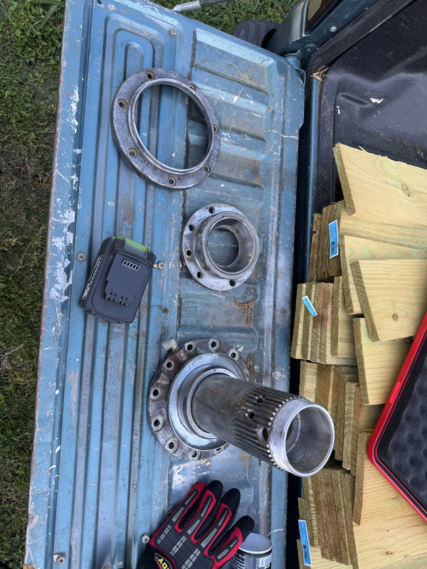

Good news, I'm ready to put the front left wheel station back together.
Bad news,  was cleaning up the axle spacer plates and one of the pieces got caught on the nylon wire wheel and did it's best SpaceX imitation and flew at mach 10 into my hand, splitting a finger open and folding the metal like a taco.
It's toast.

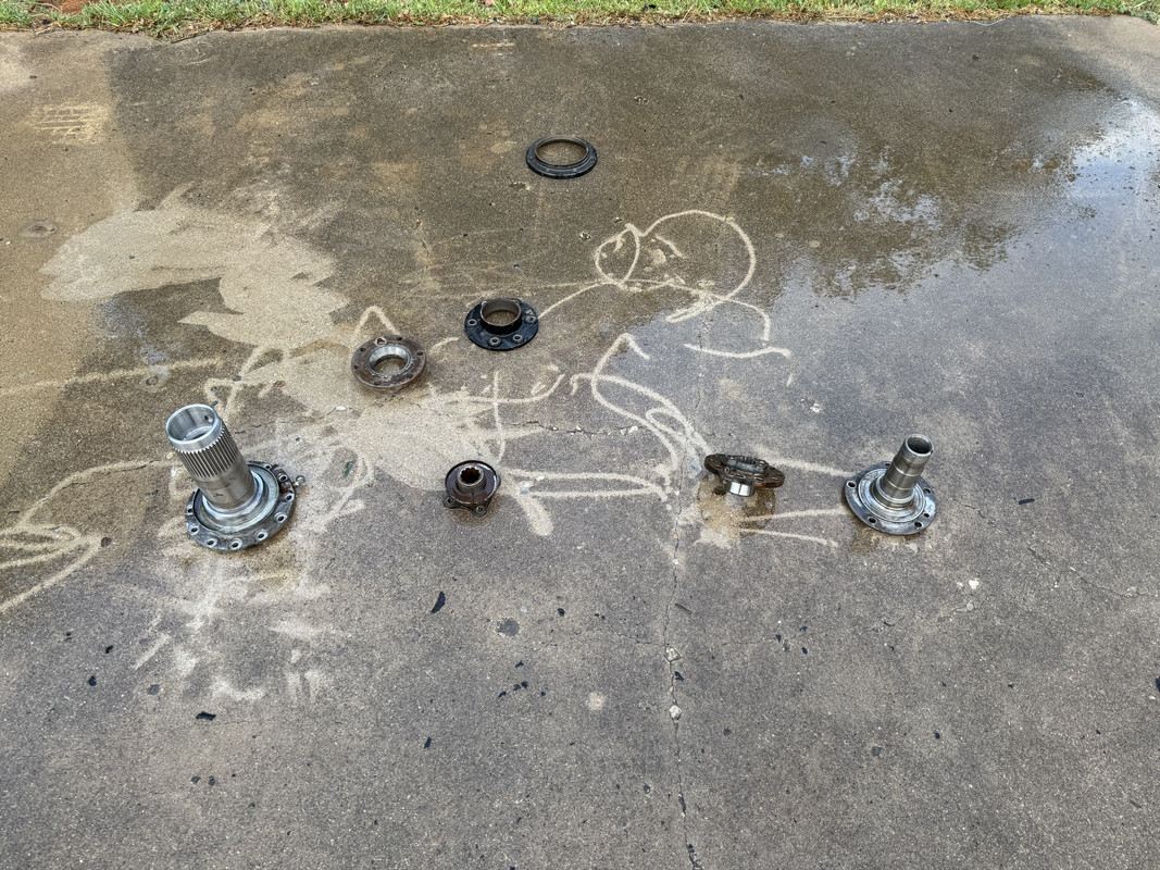

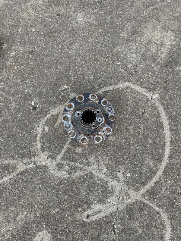

4/17/2025 1:31:42 PM EDT
[Last Edit: fadedsun][Edited] [#47]
The BRDM was pretty close to being done before someone tore the whole thing apart, according to M35Ben...
Other than the fuel tanks corroding, pickup tubes clogging up, and the brakes still having issues, yeah.

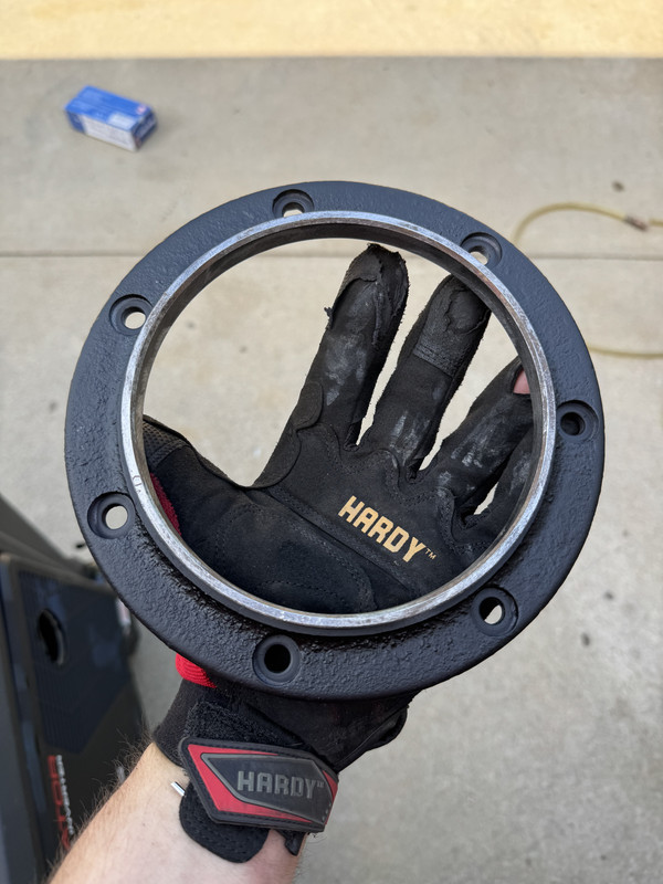

Pressure washing to clear off the old nasty grease.
Harbor freight predator did great.
Ready to re assemble the front left wheel
Station.

Front drive shaft and knuckle all cleaned up, ready to re-install.
