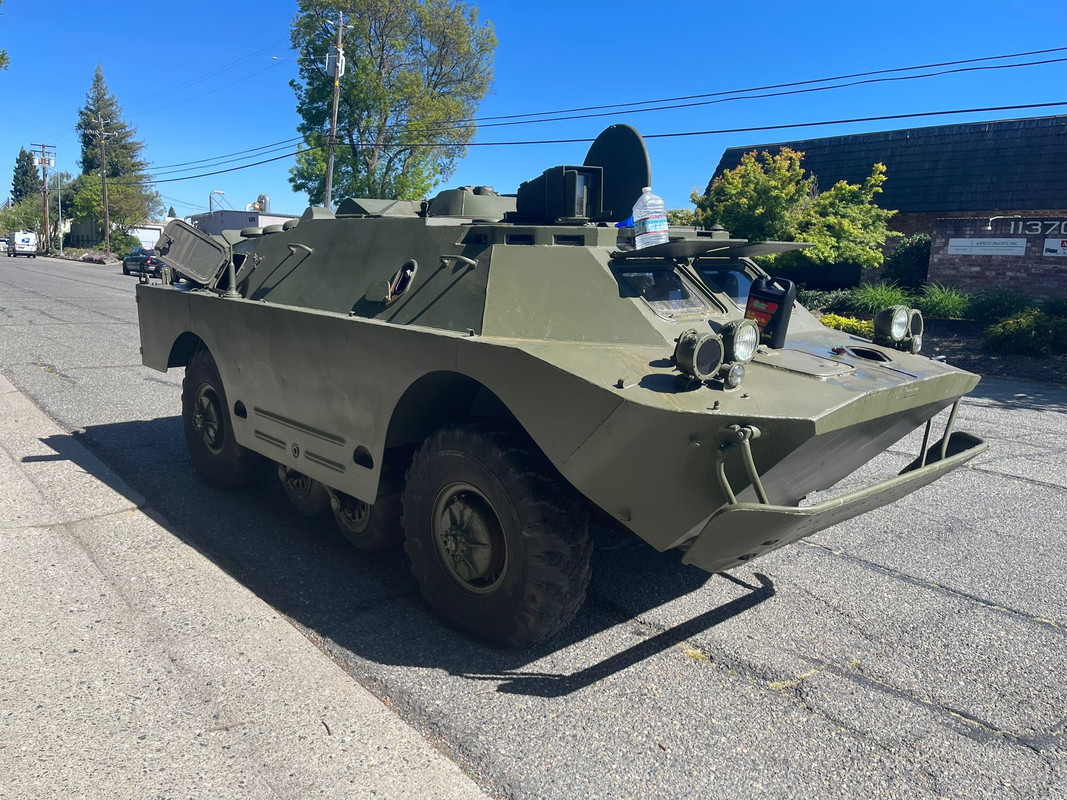

Okay,
so after 3 years of ownership I'm getting the BRDM-2 tagged and street legal this summer. I've been able to save up the money for the registration taxes and when I get back home I'll start on it. With the help of @m35ben a couple things to do before it hits the road-
Shifting-rough/doesn't want to go
Brakes-make sure they work (only had it at low speed)
Change trans oil EP90
Drive.
Later on :
Needle scrape/sand exterior-repaint in 383 green CARC substitute
clean up rust spots on interior
Now, I've never done paint. From my understanding:
Needle gun paint and rust off, wire brush exterior, blow off, Air compressor-HVLP sprayer (Harbor freight)-mix according to instructions, spray on primer, let cure (day), then apply 2-3 coats of paint.
Sound about right? Never done this before, so I'm learning stuff here.

I would strip/sand with a nylon cup brush on a grinder after getting the heavy stuff off. Then I would paint with real CARC from Sherwin Williams. I would spray the inside with Lizard Skin for temp and sound control and then Raptor or Monstaliner the inside with a color of your choice. Monstaliner will match any color including the military stuff. I used the Home Depot Husky 30 gallon air compressor and a cheap HLVP gun on amazon as the Harbor Freight one clogged too much. IN the HMMWV thread there are pics of how I did it. Same for the other guys except some used the Bear house paint which I do not recommend as it fades.

Ive painted several MB's in my driveway. I clean off rust, pull easy to fix dents / fix sheet metal, sand to 220 with a da, mask with aluminum foil and shoot it with Olympic porch paint in 383 green and then brown and black last. Motor pool paint jobs are easy. I'm also super color blind and can't tell the green and brown apart when spraying. Every other year or so I repaint them.

I would definitely wear a good respirator while removing CARC paint and also while spraying CARC paint. When I was in the Army, we were allowed to do touch up painting with a brush only. If the vehicles/equipment had to be sprayed with CARC, a full PPE set had to be used. PPE required was respirator,  coveralls along with gloves.
It's not CARC paint to my knowledge. I don't know if russia used CARC paint on it to begin with even thought it was a CBRN vehicle and expected to get slimed.
I can get real CARC paint?
The inside is probably gonna stay as is for the most part except for a couple of rusty spots, mostly in the floor boards and a rear compartment.
Blyat

Sherwin-Williams sells CARC, its about $140/gal iirc. Look in the paint forum on steelsoliders.
I've had good luck with the porch paint, easy to spray with a latex gun and I only sand the carc appreciably where I need to weld. Like was posted above, a good portion of the MV's are painted with a brush in the motorpool. In general it's much more like painting a tractor than a traditional automobile. If it gets sun faded or you jack it up with a pressure washer, repaint it.  I can shoot a second 3 color camo job on a Saturday. I'm respraying the CUCV in a month or so once the pollen stops falling, same pattern just need to fill in some light spots.
Nice...140 a gallon

Real CARC from Sherwin Williams varies based on your account and location. In the Houston area you have to order from the Professional Coatings division. Sometimes the local store can order it and have it shipped to the store for no additional cost. Its a two part paint with a third part being a little water to make it easier to spray. I paid under $200 for two gallons and the quarts of the second part.
As for the Lizard Skin it was very easy to spray with their kit and covered up a lot of the imperfections from multiple layers of paint and sanding. Provided a very smooth and level surface to top coat with your choice of paint or spray in bed liner. Again the Lizard Skin was for temp and sound which was a must here in Texas for the temp and well anything for sound helps.

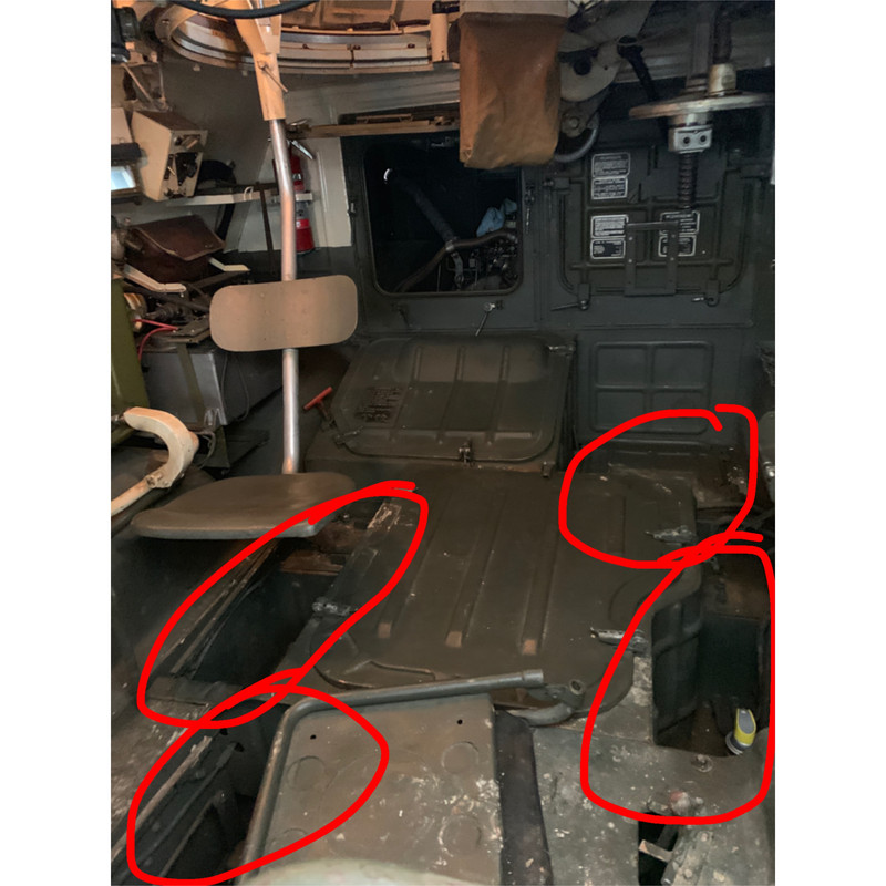

How does that hold up in high foot traffic areas? The circled areas above are where folks stick their boots.

I can't comment on Russian vehicles. Every US combat vehicle is either painted white or a light green on the inside. Unless they are new, you will see the paint rubbed thin/off from where soldiers feet constantly rub.
As far as exterior pain goes. If you use a true CARC paint, make sure to wear proper PPE, CARC is very caustic and cancer causing. That is why we were only allowed to use a brush to touch up vehicles in the motor pool. Complete strip and paint jobs went to special shops with proper ventilation and air filtration.

The new sherwin williams stuff is a different animal, type 2 is even waterborne and cuts with distilled water.  It smells like green apple jolly ranchers and downright pleasant.
Im sure its still not wonderful to breath in....So i suppose PPE is still warranted.

Got the paperwork greenlight from the inspecting officer. Nothing has changed.
I've got the money ready for the sales tax on the vehicle. Spicy.
Update to keep from getting archived.

I contacted the DMV and set up an appointment today for the registration. The earliest they could see me was 11/19/20. I set an appointment for 11/23/20 since that was my day off. I still have to go there and show the bond I paid and hopefully it won't be too complicated.
What
I have a local guy who is going to come out and pressure wash everything. His price is half of what I was previously qouted. Inside and outside degreased and blasted with HOT water and he has his own water tank.

This is awesome, I love the BRDM-2.
Are you replacing the GAZ V8 with something else? Russia modernized most of theirs with a 4cyl TD. I bet a 4BT would be a nice swap.
