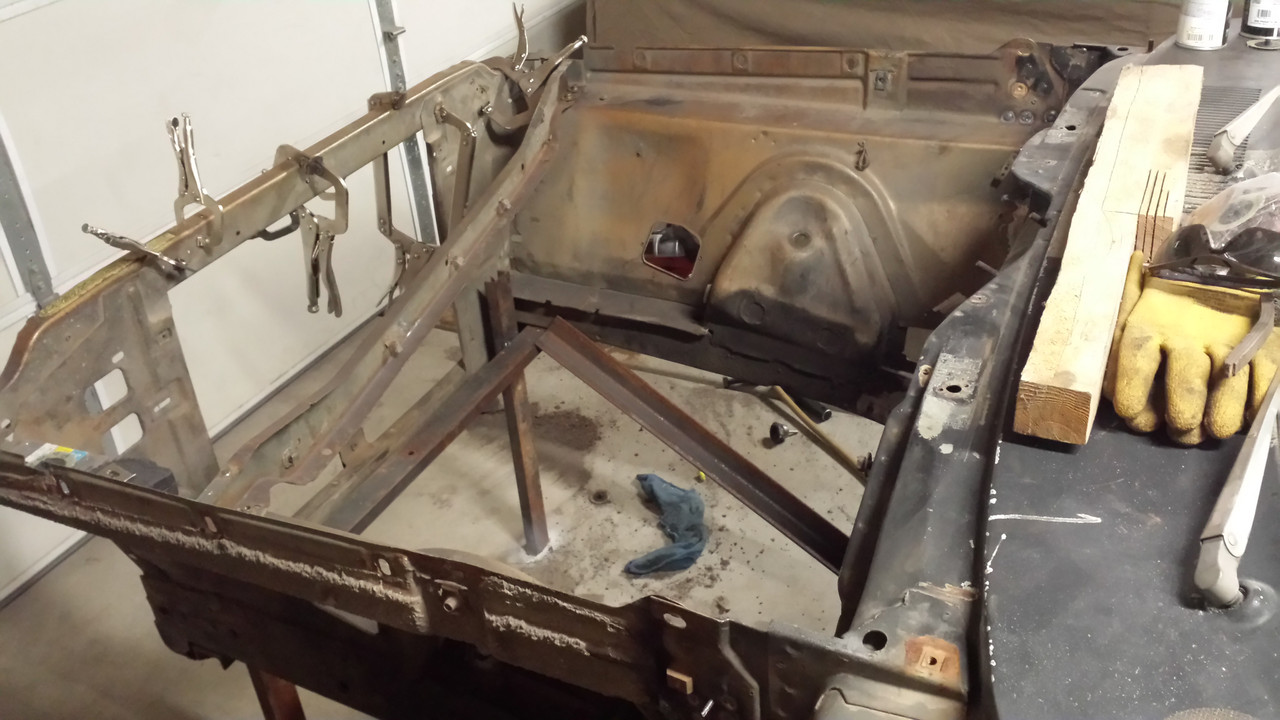

Here is a pic of the doghouse that was replaced.  Donor was in perfect shape.  Lots of measuring and welding up supports to keep it in place. I cut the frame in a < shape and doghouse a corresponding < with a slip in box tube for strength.
You can see a frame I welded up under it to keep it in alignment during the swap.

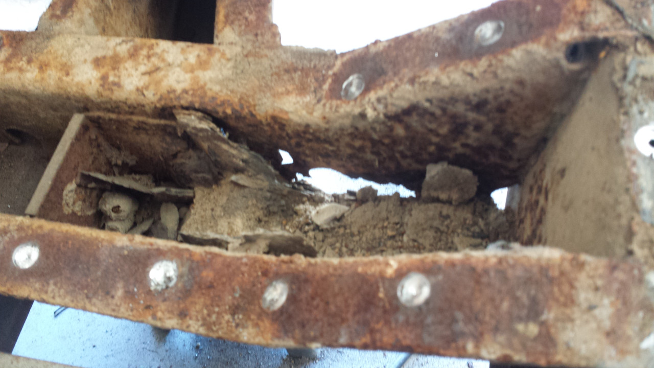

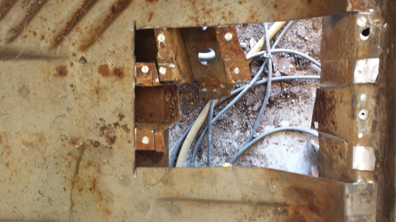

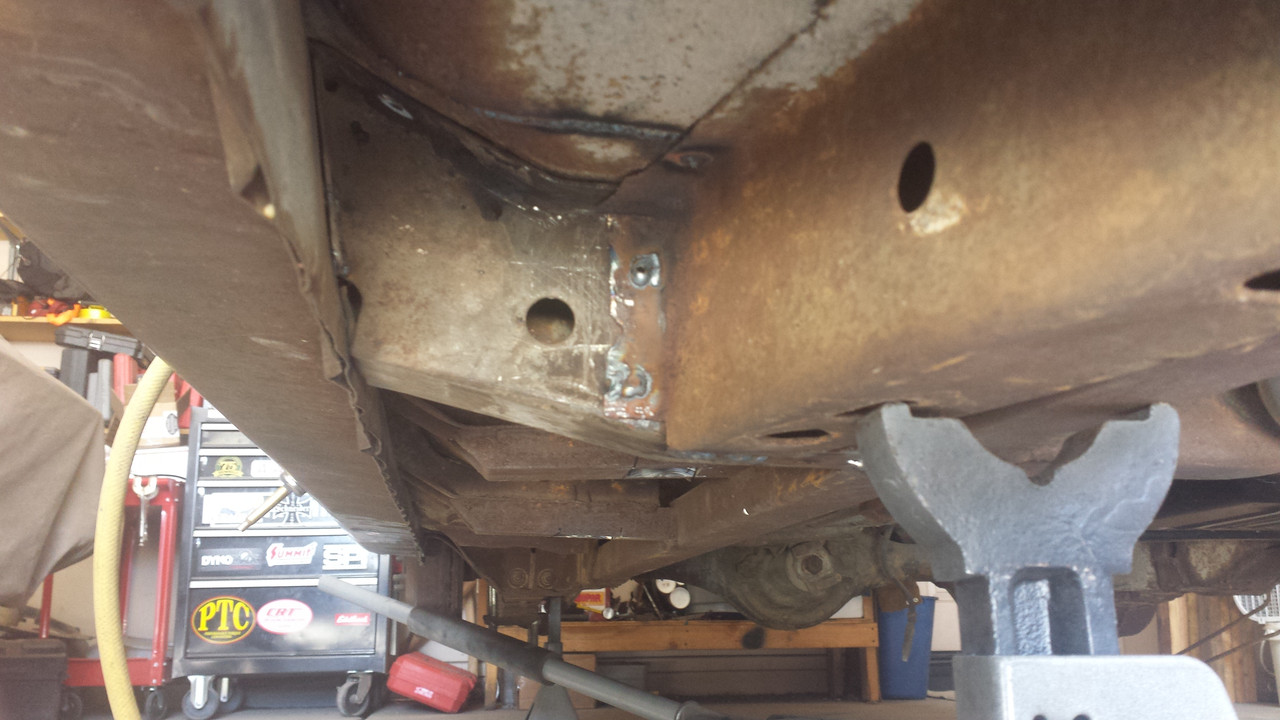

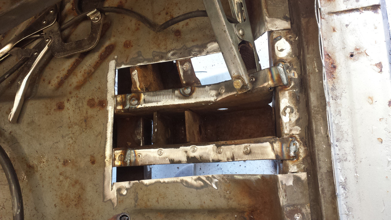

Pictures of the transmission crossmember. These rot out in this area because there is no drain hole so dirt and water collect destroy them over time.
