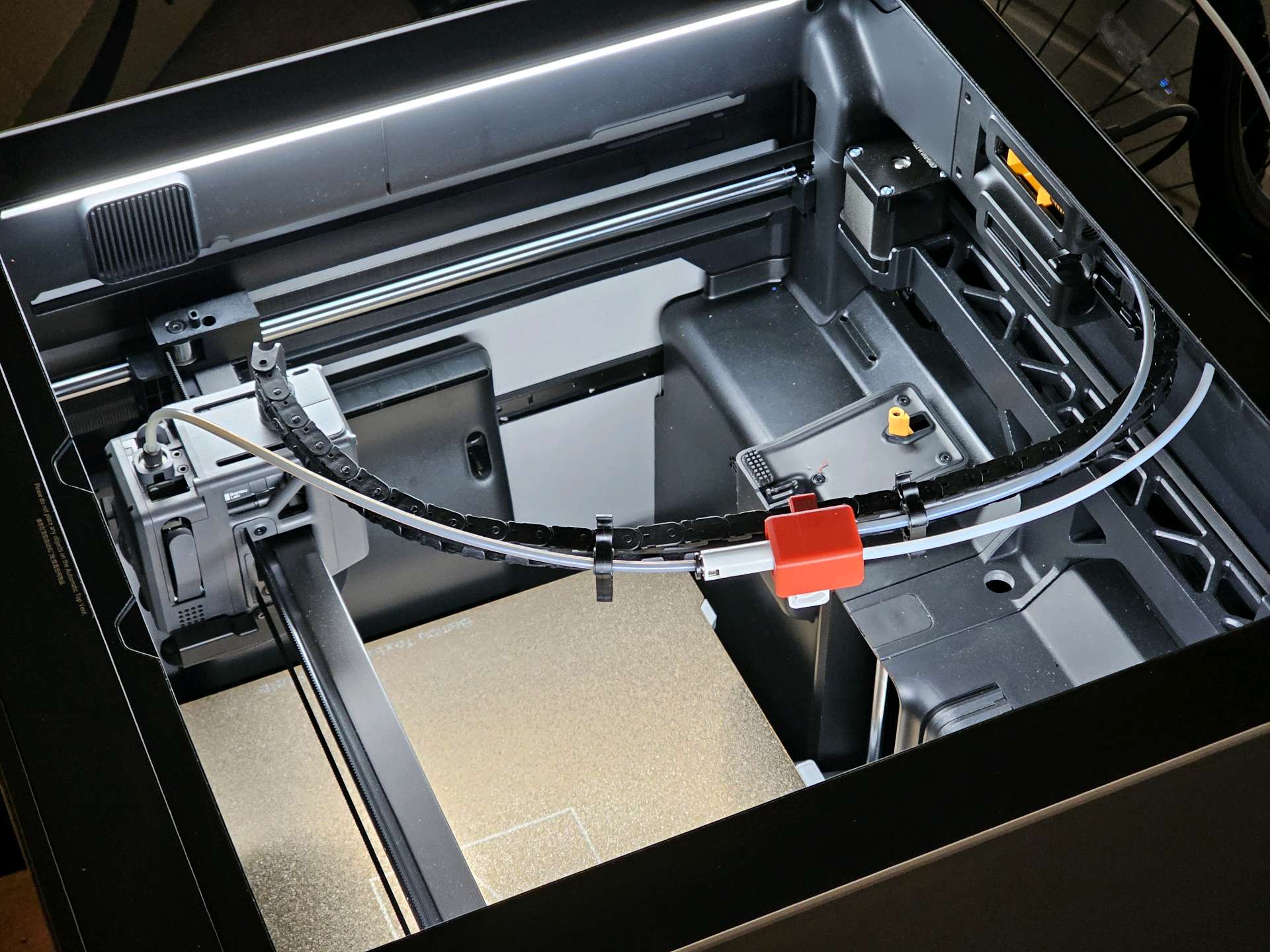

Correct, the 2 HT's feed into the 4 to 1, which then feeds into the printer.  Nothing manual is required, when the spool on the left goes empty it will automatically load the spool on the right....or vice versa (assuming they're the same filament).  You can also have 2 different spools loaded and use them on the same print, it will just be slow because it has to load / unload filament for each change....it would work the same way your P2S / AMS works today.
It's a similar setup to the P2, only there are 2 connections, one for each nozzle......and instead of being in the middle of the printer, they're located on the upper right side.
EP429: Today's lesson - Don't provoke ARFCOM. People will see your butthole.
5/7/2026 9:01:11 AM EDT
Like the P2S, you have to bypass the buffer to run TPU filament.....I use another 4 to 1 adapter on the right nozzle so I don't have to move PTFE tubes around to print TPU.
Not my picture but it looks like this.

https://makerworld.bblmw.com/makerworld/model/1575376/comment/de331350-e99a-11f0-b409-8b2e5e1362b4.jpg
Did you print that holder for the 4 in 1?  I got my H2D a couple of days ago, boy it is a monster compared to the P2S.

Yep....it works good.  I had to play with the length of the PTFE tube from the buffer to the 4 in 1 when I first installed it but haven't touched it since.
