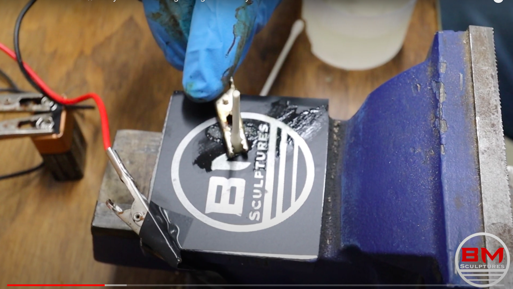

As an addition the H series printers have the ability to add lasers (10w & 40w) to them as well as a vinyl / paper cutter attachment.  I bought the cutter attachment with my H2D, partly because it was a capability I didn't have before and partly because it was only a $70 adder.  I passed on the laser because it's much more expensive and isn't able to engrave steel....it also just seems like a messy combo to put in a 3D printer.
I'm sure the kids would keep you busy making stickers and vinyl decals to put on stuff.....related to 2A stuff.....I've used precut vinyl "negative" stickers to make templates for electro etching 80% lowers with really good results.  Essentially you make a sticker but cut away everything you want etched.  All it takes is an old laptop charger, q-tips and salt water.....some patience probably helps.
Not my picture but gives you the general idea.
