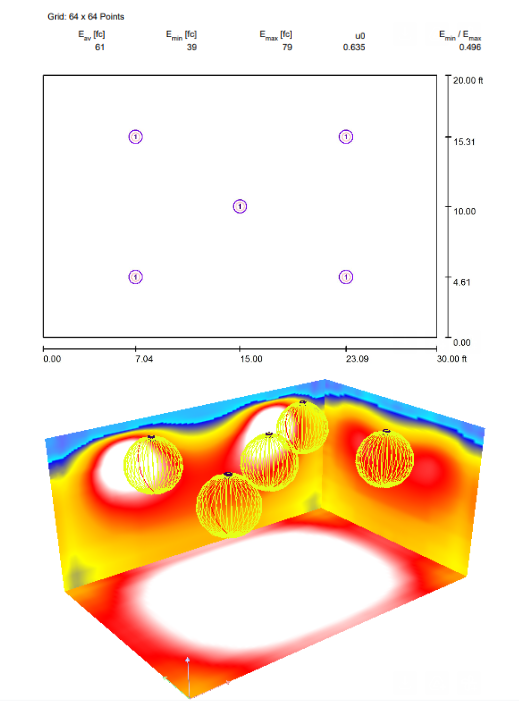

If you upload your shop's measurements to hyperlite, they'll use their software to model it and get the right amount of light everywhere.  Mine's about the same size as yours.  They sent me the layout and the model of my shop.  Its basically 5 ufo lights arranged like the dots on the 5 side of a die.

Here's some of the simulation they made up.  Mine is 20x30 with 14ft walls.  There's another sheet that shows the footcandles plotted in a grid around the room.

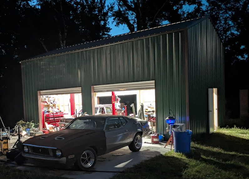

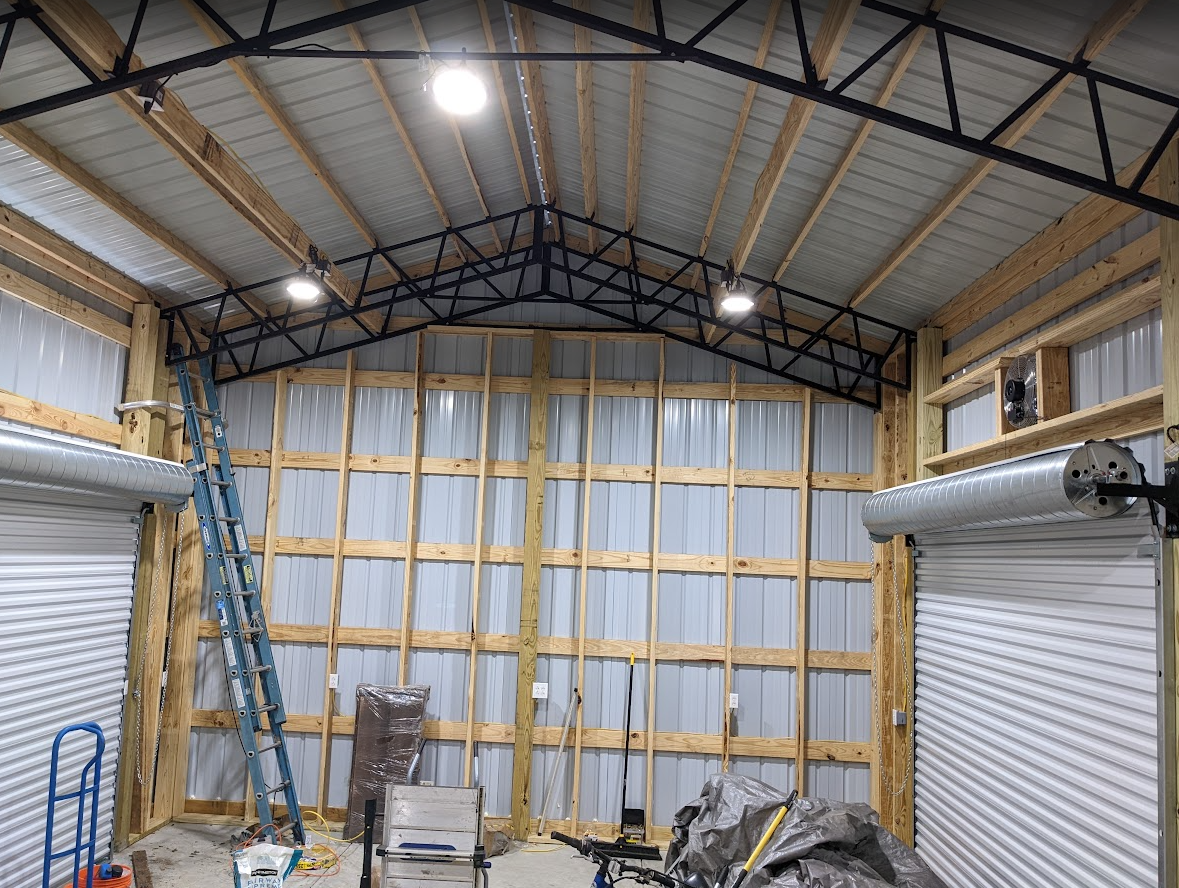

When I went to hang the lights, I didn't get it exactly like their model.  I hung my lights off the rat-runs.  I figure its close enough, you'd never know the difference unless you walked around the room with some tool that can measure light.  I have plenty of light to see everywhere in the shop.  And there are not really any shadows, except while working under a car.  The daytime shot shows the light placement, as well as how light it is inside with the doors closed.  The night time shot is how lit up it is at night, with no other lights inside besides the 5 on the ceiling.
