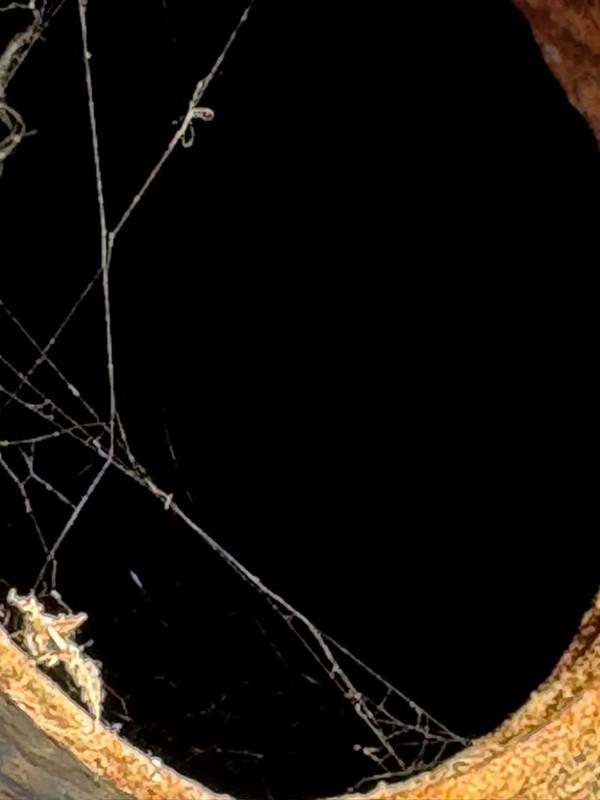

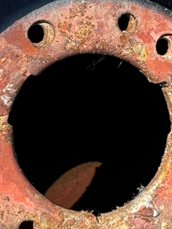

Does anyone know anything about fuel tank repairs when the tank in question has been relined previously?
The liner is flaking off in my fuel tank and the shop refused to work on it. How can I fix that or is my only option to get new tanks made?

The way we deal with rusted diesel fuel tanks at work is to cut an access opening, weld on backup strips, then clean out the tank. Wire wheels or blasting. We never treat them as it always fails and causes bigger problems.
The backup strips make it easy to weld the plate back on without any splatter getting inside and to have full penitration.
9/14/2026 2:54:54 PM EDT
For smaller tanks filling them up with acetone and letting them sit until the lining softens up, then hitting it with a pressure washer usually takes care of it, sometimes you need to use the nuts/gravel and shake it up routine to get the lining to come off.
Acetone would be a littttttle bit expensive to fill up that tank.
Since it is a simple tank, and it's painted, I would suggest a partial deconstruction of the tank. Gouge off one end of the tank, do the cleaning with a scraper, wire brush and some acetone. I would use Rustblast to clean up the rust, and treat the steel. Personally I would rather have raw tanks, unless you have pinholes.
