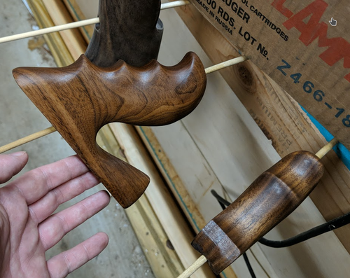

For a coffee table I would use spar urethane.  Super durable.  I do love tung oil on wood gun stocks though.
