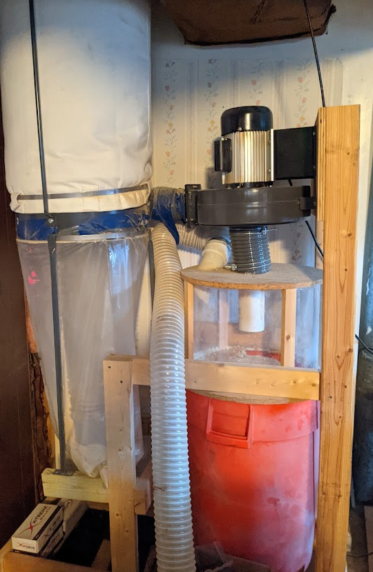

I've had a dust deputy and a 55 gallon drum sitting in a corner in the shop for the longest time, just waiting for the motivation to hook everything up. I set it up the past couple of days, a 6 inch intake from my shop fox 2 HP (really 1.5) DC with a 12 inch impeller and it discharges into a Donaldson truck filter with a 5 gallon bucket attached with a gamma seal.
I've used these things before, but they always amaze me. It's sort of fun to watch the debris spin around inside the top of the cyclone long after you cut off the DC. I sucked up probably 15 lbs of wood chips, shavings, and what I thought would be ultra fines (the leavings inside of my tablesaw and a bunch of sawdust from my miter and bandsaw). In the end, I had maybe an ounce of fine dust make its way into my five gallon collection bucket. That's crazy efficient.
And now I don't have to use that godawful bag clamp apparatus that goes on most factory dust collectors. I just pop the lid off my 55 gallon drum and dump it in my neighbor's driveway late at night (he'll never know who did it).
If you use a dust collector or even a shop vac and don't have a dust deputy, get you one. And no, a home made thien baffle or that silly jet cycloidal separator is nowhere near as efficient.

Second this.  My HF dust collector, super dust deputy, 32gal trash can, and pleated filter made a world of difference in my shop dust/chip management.
ETA: I also have a standard dust deputy on a 5gal bucket connected to a shop vac.  This is where I started, and after seeing how efficient it was at keeping dust out of the vacuum, I built the bigger system.

Yeah I set up a two stage cyclone with a Dust Deputy last year when I needed to build my doors.
Way, WAY easier to dispose of all the chips and dust. I still have the bag on my DC but it never fills up, I mean not even a half inch of crap in the bottom. Super easy to take the lid off my fiber drum, dump it in my green organic recycling bin, and get back to work. One day I will need streamline it to make it more efficient and have a smaller foot print. Also want to add a small vibration motor to the filer to knock off the dust.
A note about that. I removed and cleaned the filter after about a year and holy shit the ultra fine dust wouldn't stop coming out of it. Knock it over and over, vacuumed it over and over (another cyclone with HEPA set up), used a blower on it over and over in the back yard. Still didn't get "clean" but it was clean enough. The vibration motor will hopefully reduce the caked on dust within the pleats.
I've noticed recently my table saw doesn't seem to be extracting saw dust like it used to. The two stage dust collector set up seems to be working as it was, so may have something in the saw obstructing it.

I converted my HF dust collector into a 2 stage with a home made baffle/separator.  It dumps into a 32 gallon plastic trash can that I just slide out and dump.  Its connected to my CNC router and table saw.  In the 7 years since I did the conversion, I've emptied the trashcan countless times.  My original chip bag maybe has a gallon or two of sawdust in it.

You should be able to notice from my pictures that the DC is running and that there is no cloud of fine dust in the air, or on things around the tool (no dust on the girls in particular).
How could those crappy bags keep the air around me so clean but still flow enough air and have enough suction to pick up and collect the fines that I want removed as quickly as possible from the machine???
