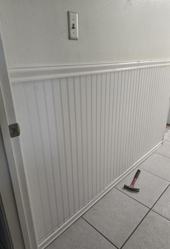

[Last Edit: Trollslayer][Edited] [#8]
How about wood paneling?
It comes pre-primed, so you don't have to paint it and it won't be dark.
It is easy to hang/install.
Trims using tools you already have.
There are no seams to finish (tape, mud, sand).
Go to your local building supply and look around in the sheet goods area (Home Depot, etc).
This is just one example of what you'll find (does not have stop half way up)
