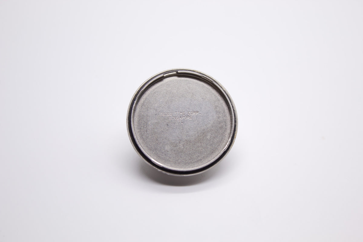

Howdy all! I've recently dug grandpa's Seiko dress watch out of my "stack of stuff" and want to get it
running again. It's a 7N00-7A49 model quartz.  I think it's from the 1990's and wasn't an expensive watch,
but I'd like to get it usable. I assume  the back just pries off, but I've tried with an Exacto knife and
cannot get it to budge. Any tricks or tools I need or does this back a screw off and I'm pissing up a rope
trying to pry it off?
Pics..
Pic of grandpa in the Phillipenes circa 1945.
Thanks!

Just running the 321-491 through Google, it looks like it may be a screw-down back. I would take the bracelet off and use your palm to attempt to unscrew it against. They make a soft "watch ball" for that purpose, too.
I would not try to pry it off until you can confirm that it is a pryback case. TONS of Reddit watch subs to ask.
Edit: further research says it probably is a snap-off back. Look for a notch in the case back.

It’s definitely a snap back.  The trick is to find the gap before trying to pry it off.  It should look similar to this (the gap is near the top):
If you can’t get it with a knife and/or don’t want to scratch it up, get a case opener:
Amazon Product
  • 1. STURDY AND DURABLE: Our watch back case removers are made of stainless steel and ABS, sturdy and non-toxic. It will easily pry the watch back case open.

Just take it to most any jewelry store and they can replace the cell for you for a minimal charge.
In fact, many of the mall watch stands can do it.
Be aware that the rubber "O" ring on the case back may be deteriorated and should be replaced.

I did it myself. Watch runs just fine now. I did remove and clean the o ring and the groove it sits in. It was kind of hard to get the back to snap back on but I got it on with no damage.
