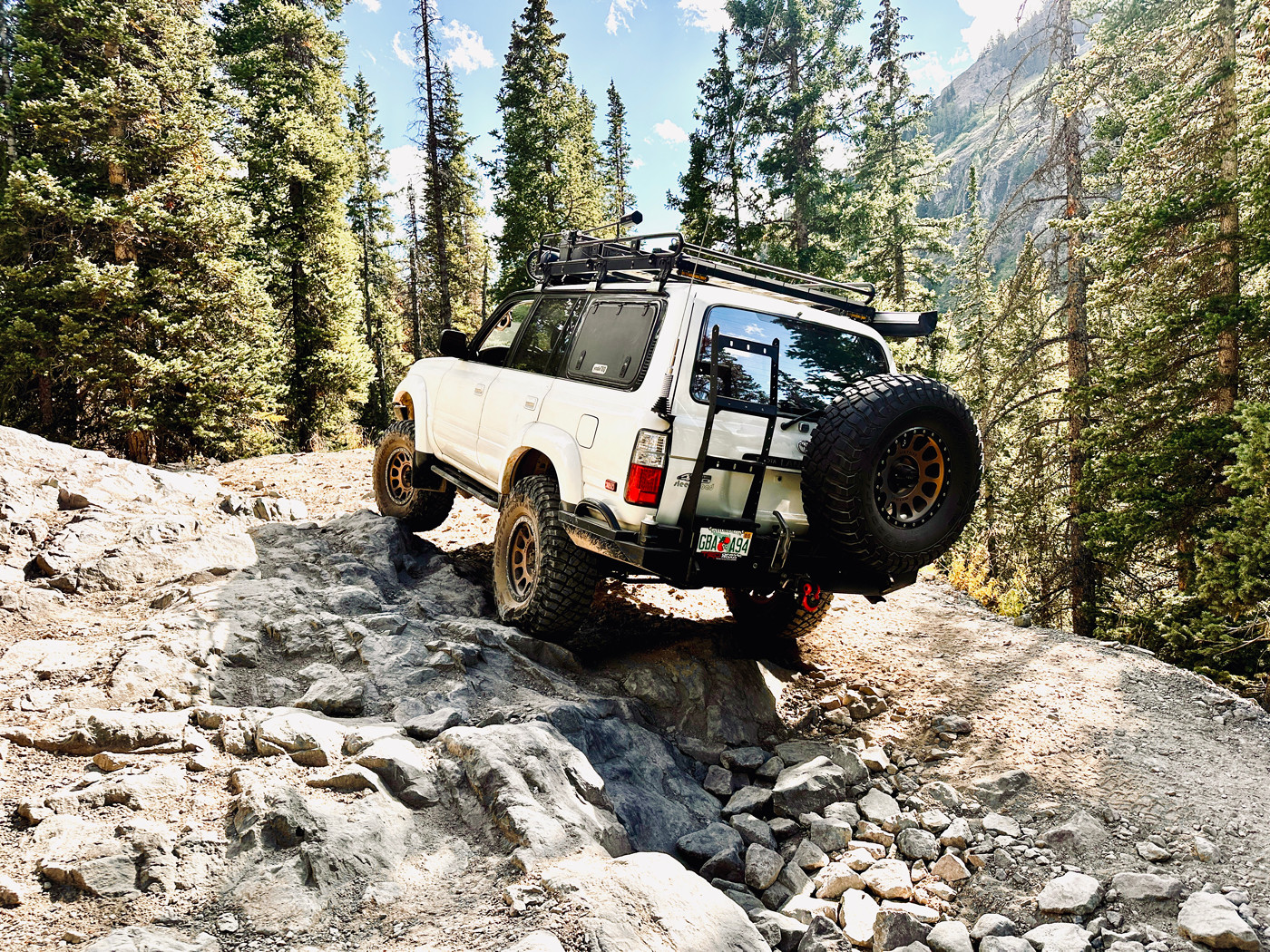

I went with Nitto Recon Grappler in LT285/70-17 E-Load (33") and think i made the right choice. Didn't need to do the body mount chop, had enough clearance. The tires drive very well, not harsh at all. Smooth and quiet. Completely satisfied. Glad I went with the E Load as the piece of mind on the trail was well worth it. Aired them down to around 18psi, really absorbed the rocks.
Pic of Imogene Pass:
