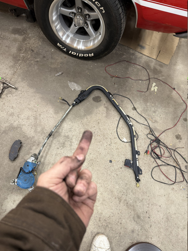

One of those days, None of my other projects went well. Tore apart my dishwasher for the 3rd time since breaking a glass in it. Seems to have died for good this time. Need to tear it all the way down and aim the parts shotgun at it.
Put new headlights in my Crown Vic and went to adjust them and pulled the adjuster out of the housing.
A couple project car successes though:
Made a clean spot in my garage attic for parts and rearranged some stuff to make room for the EF teardown. Discussed with my kid where we would park his EG for winter. It'll be boxed in bad so mine will hopefully be a roller by spring.
Had a convo with my buddy and he convinced me to get the wiring sorted before I burn it down driving it. He's probably right

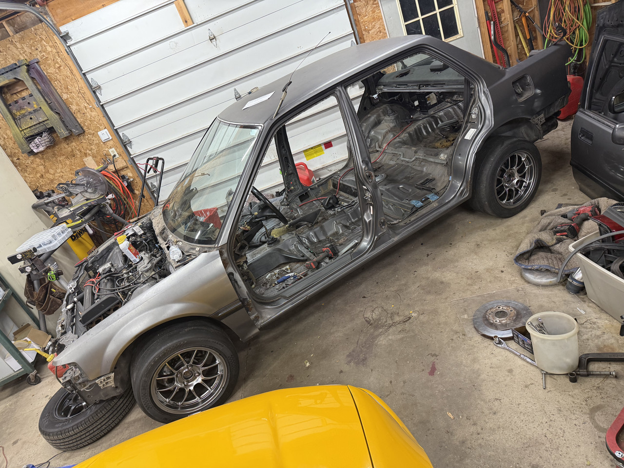

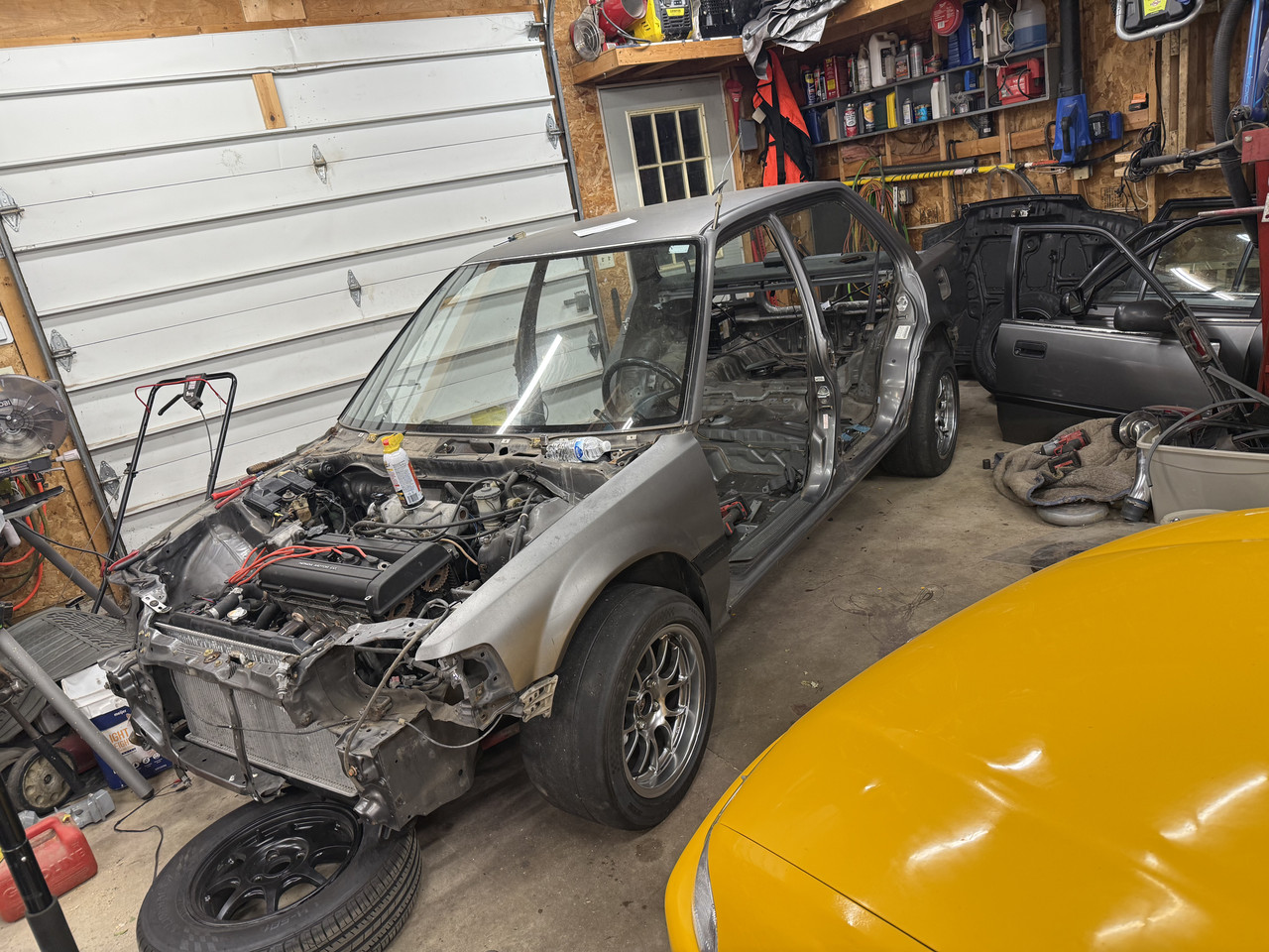

Started the day moving shitboxes around and snapped a pic
I was thinking about sorting out all the wiring and pulling the dash to do so so I can start the tuck and do a hydro clutch conversion when I just said fuck it and started at the rear bumper working my way forward. stopped at the dash/headliner/driveline. Save that for next week/weekend.
Took me 3 hours to get it to this state.

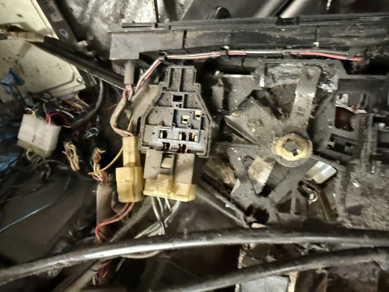

What a fucking mess.  Wiring is sketch asf.

Did they use a conversion harness for obd0 to obd1 or 2? That’s what I did years ago on my swap. It basically plugged into the obd0 plugs with a short harness to obd1 plugs into the ecu  then had the extra wires you needed to run off the obd1 plugs to go to the vtec solenoids, sensors etc. definitely not the cleanest solution, but was a lot less work than cutting the old obd0 plugs off
11/5/2025 9:23:05 PM EDT
Yeah there is a ODB 1 conversion harness in place but there is also a lot of chopped up engine harness, plus the EK cluster swap and stereo stuff

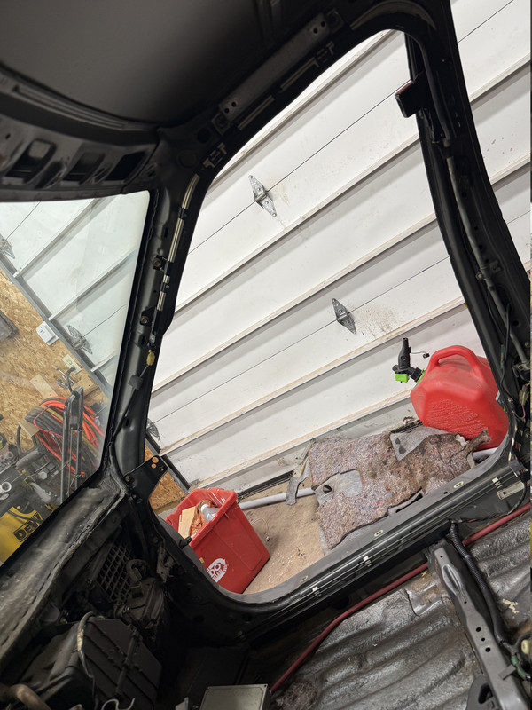

Slept all day and finally got up and pulled the headliner.
After that I rearranged some shit in the garage and made more room for the EG and any other repairs I need to do to the fleet

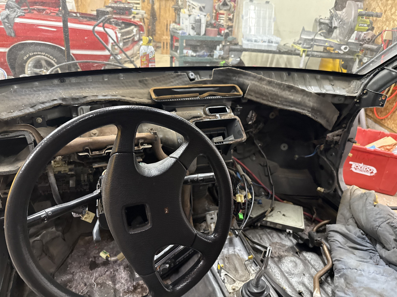

So much of the wiring in the car looks like this. No idea how the PO didn't burn to death.
I may do a standalone and add a Haltech dash just avoid the hackjob on the cluster.

Looking at that pic of the wiring. The guy that had was obviously a home electrician.
11/9/2025 7:42:22 AM EDT
Probably won't sell anything until I'm all done. I may just clean up his wires and reinstall to try to save a buck.

yes. It works but the wires are just twisted and taped. I'll probably go through and barrel crimp and heat shrink it all but if I hit the lotto I'll get a Haltech. The rear dash cover doesnt fit with the EK cluster

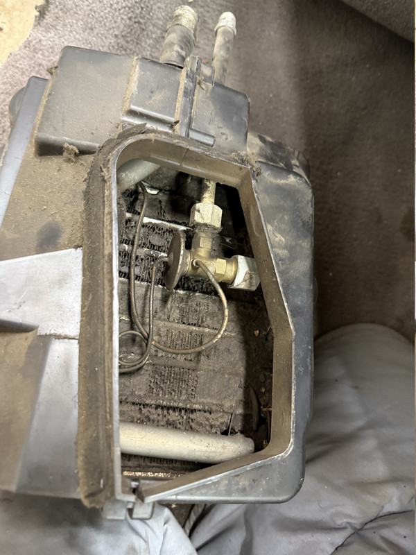

pulled the auto retractor belts. These will never go back in. Also drained coolant and started pulling the underdash. This car is way more complicated than the 92 civic under the dash. Tighter too. and disgusting.

made a couple decisions today. BF got me and i bought a hydro clutch conversion from Hush performance for a Bseries trans, I also bought the hybrid racing shifter setup for b series. it has great reviews but it was spendy. BF pushed me over the edge to commit to the B 20. My buddy found 3 vtec heads on FBMP  in 5 minutes so that also helped
I also decided on a color.
that said i am still on the fence about the build. it will be a street car but i am considering a track-like build. light gutted and race oriented. or full interior but swapped to black.
I have a crazy idea i may do if i gut it
oh yeah, i found another build i like but can't easily emulate. i may try though
11/29/2025 1:53:58 AM EDT
[Last Edit: victorgonzales][Edited] [#41]
Good choice.  I'm really considering a b 20 VTEC in the crx too.  It's pretty reliable 200hp which is all the ef needs .  I wonder if the cable hydro converter works between d and b series trans since I already have one for my d series since it has a 95ex trans.
Since you'll already have a head off the car might as well throw a new cam in there too lol.
B18 turbo is another great option.  Rock solid reliable 250hp on stock internals.
We are at same point on the track decision.  Do I want interior panels? Lol. Or gut the thing and order plexiglass windows and shave a couple hundred pounds.  It's appealing on these older models because shaving 200 pounds off an ef is noticably faster compared to shaving 200 pounds on a modern two ton vehicle.

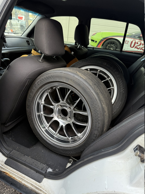

found som 15x9 wheels I know will be a mistake but i may grab them and try to make them work. It will look like that red car above probably. Pics if I buy them

These don't fit. Yet.
I love them.
12/3/2025 11:33:44 PM EDT
Good looking wheels. They look wide
