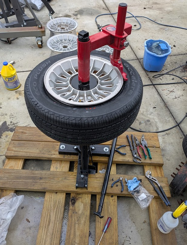

Some tires arrived at my house today.  They were not the ones I ordered.  Long story short, though.  Through mass incompetence at every single layer of walmart, I got this set of tires for free.  I went ahead and mounted them with my little tire setup and got them on the car.  Thats when I discovered one of my new used center caps was cracked and won't stay on.  Since the entire tire change was $0 out of pocket, I'll probably pony up for a new center cap.  While I was at it, I used the toe plates and turn tables and whatnot to check the alignment.  It was close enough, I just left everything like it was.
I also ordered a pile of parts to build this rear end.  Now that I've had a chance to drive around with the new drivetrain and the correct size tires, I decided I'm gonna try out the stock 2.73 gears from the GT rear end.  In the fox cars with a manual transmission, 2.73:1 was the standard option and 3:08 was the free upgrade you can order the car with.  My 7.5" rear end has the 3.08 in it.  So now I know what the upgrade drives like.  I can try out the 2.73 that came with the 8.8.  If I don't like them, all it costed me to try them out was a couple quarts of oil, a bearing, and maybe a new pinion nut.  I figure its worth that much just so I'll know.

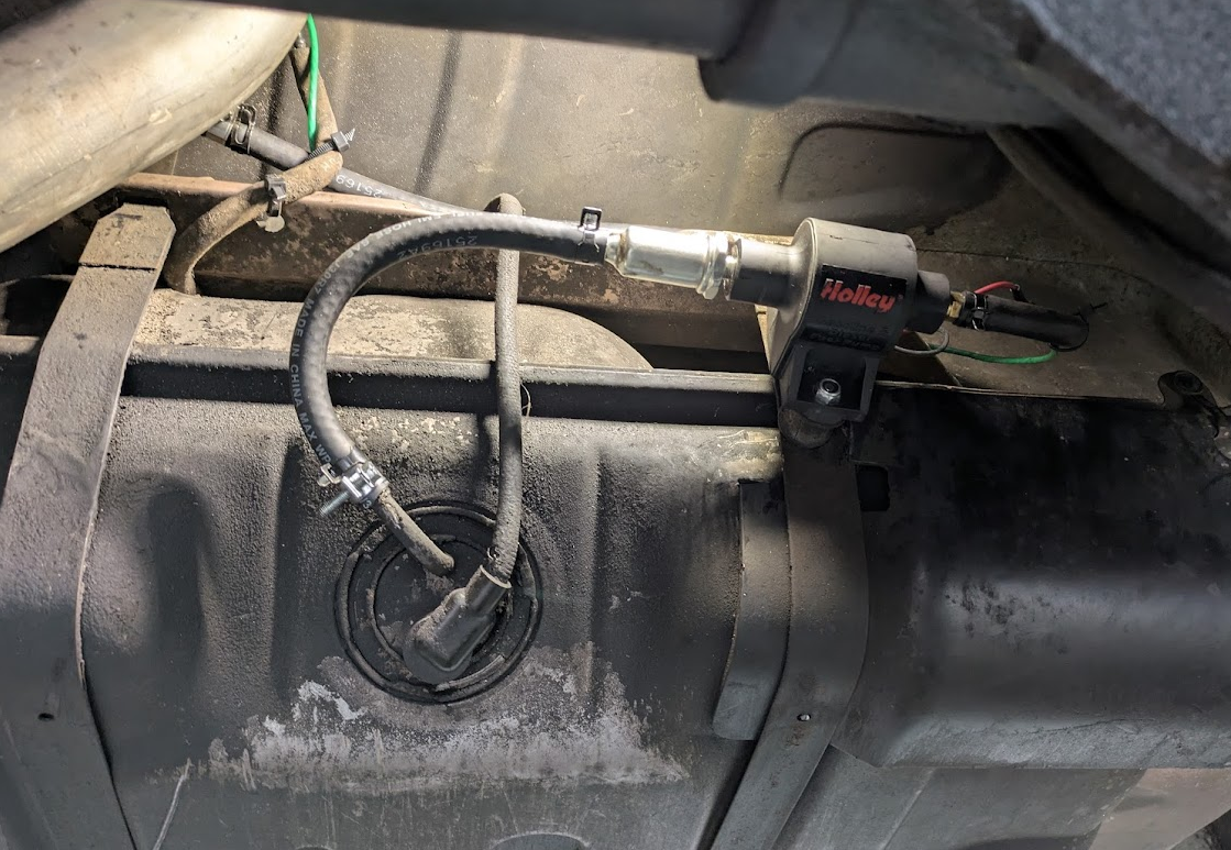

As far as progress goes, I drove the car enough to get the tank mostly empty.  Then I pulled the external fuel pump and moved it back as close as humanly possible to the tank.  And I flipped the fuel  inlet on the carb backwards so the line is not near the radiator.  I'm not sure exactly how much that will help, because now it runs closer to the exhaust.  Either way, the fuel pump is at the back where it can push instead of pull, and its away from all the heat.  I'll see if that helps it out at all.

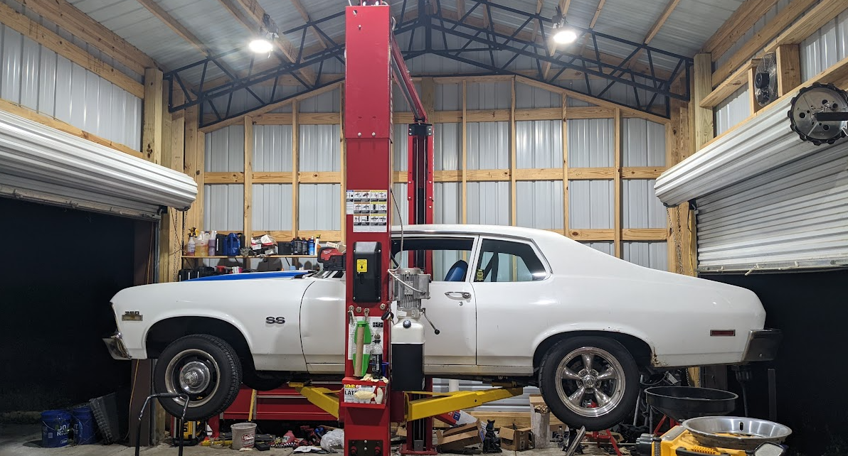

Welp, I rolled out of bed today and decided I felt like making progress on my rear end.  I spread a bunch of crap all over the middle of the floor and got to it.

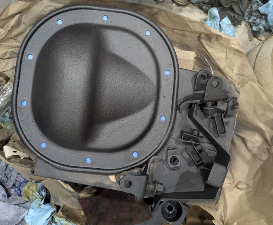

The housing was already mostly stripped and degreased.  I hit the critical surfaces in it with some break cleaner and scotchbrite.  I cleaned up the pinion and carrier a bit.  Then got the old bearings off them.  Pressed on new bearings.  Knocked the races in the housing.  And got it all setup using a crush sleeve eliminator with shims.  I ended up with 20in/lb of preload on the pinion bearing.  Then I dropped the carrier in it, I used the original shims.  Using those, I got the correct amount of preload and my backlash is 0.011", which is just inside the spec.  When I ran a pattern on the gears, it looks good enough to me.  I'm not sure if its the way the gears are cut for this 2.73 ratio or what.  The pattern on both sides takes up most of the tooth.  It looks like its centered up enough and not quite touching the crown or root.  I think I'm gonna send it like it is.  Its probably good enough for the grocery getter.
I still need to pull the nut off the front to install the seal and stuff for real.  Then I have the posi clutches, upper arm bushings, and axles bearings and seals and it should be about ready to party.
12/14/2025 7:52:42 PM EDT
Today I knocked out just about all of what was left of the rear end.  I put the oil slinger, seal, and new nut on the pinion.  New clutch kit for the traction-lok.  Axle bearings and seals.  And then the bushings for the upper control arms.  Those turned out to be the most pain in the ass part of the car so far.  I had the special tool for removing/installing them.  I had the angle grinder.  And the air hammer.  And the bigass impact gun.  And the penetrating oil.  They fought me for a good 4 hours.  But I won.  Usually I buy new control arms to avoid dealing with bushings.  These ones are pressed into the rear end housing, so I couldn't really avoid them.
I think about the only thing left for the rear end is my cover is derusting.  Then I can paint it.  And then its just whenever I get the itch to pull the car in to drop the rear end.

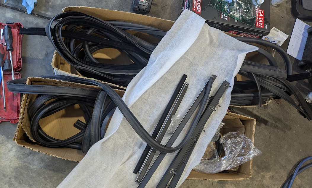

Today's little project on the greased turd was starting to replace some seals.  I've had this box of weather strip, window channel, and beltline seals for a couple months.  I wasn't really excited to screw with it, just cause its not as exciting as a big motor.  I finally figured I'd get it over with.  I got one of the back windows done and it came out pretty nice.  The old window parts are dried up and breaking into a hundred pieces whenever you touch them.  I also got in an aftermarket window defroster for the back glass.  Back in the early '80s, a defroster was an option.  I laid the kit out to see what's what.  After I decide how I want to run the wiring, I'll take a stab at getting that installed.  I guess the people who bought cars with manual windows also didn't check the box for the rear defroster.  I got off lucky, though.  Some people who ordered these didn't even check the box for the passenger side rear view mirror.  At least I got one of those.

Another day, another window with new seals in it.  I did one of the front ones today.  Fucking previous owner got me.  At some point, somebody decided they were gonna fix the window seals, but couldn't be bothered to track down the correct parts.  The front windows had some horrible white putty goop in them.  Its like extra sticky pipe dupe or white urethane or something.  They used that to glue in strips they cut off an old rag.  75% of the time today was trying to scrape that bullshit out of the window track so the new seal can go in.  I eventually got it half way decent.  Whatever is left is just helping glue my seal in.  When I was done, I went and looked and the other front window also got the goop-and-rag treatment.  So that's something to look forward to.
Every time I do a window, the car gets a little less rattly over the bumps and a little less breezy on the highway.
Then I went out to check on my rear diff cover.  I dont know if my evaporust went bad or just doesn't work well in the cold or what.  The diff cover looks about as bad as it did when I put it in to soak the other day.  I dumped that bullshit out and mixed up some of the DIY stuff I'm gonna find out if this stuff cares about it being cold outside.  I'm running it with water straight out of the spigot.    If it doesn't work, then at least I tried.  And thats my excuse to buy some overpriced finned cover with ford logo bolts.

It looks like the rust remover doesnt care if its cold outside.  Most of what's left on the cover is black and looks like paint.  It cleaned up pretty well from how it came from the junk yard.  And with no scrubbing outside of wiping it with some blue shop towels.  I should probably try to get some sort of paint on it this weekend so it doesn't rust.  I left it soaking some more till i get a chance to paint it.  maybe some more of this black stuff will come off.

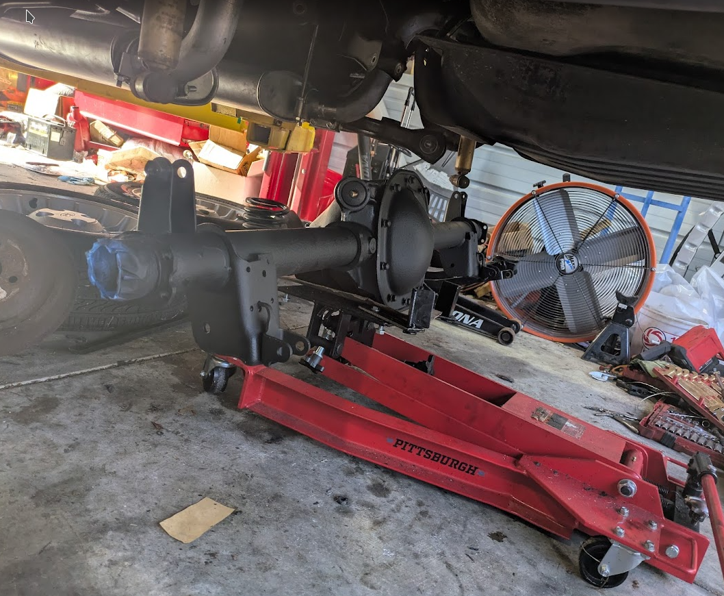

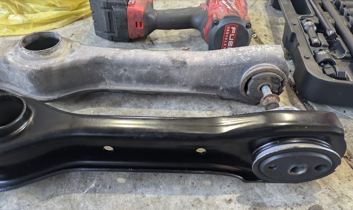

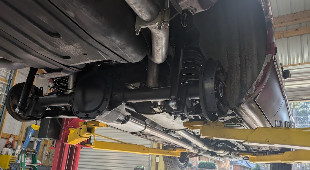

I think I'm just about setup to do the rear end swap.  All the remaining small bits are cleaned up and black.  Maybe sometime this week, I'll get a chance to pull the car in and see how this goes.
12/26/2025 7:27:08 PM EDT
[Last Edit: giantpune][Edited] [#15]
The rear end swaperoo went off without too much drama.  I started at 9:30am.  By 3pm, I had the wheels back on it and filled up the rear end with fluid.  I was able to leave the brakes completely attached to the car.  Just pulled the axles out and unbolted the backing plates, then hung the drums up.  Then i dropped the old rear end out and lifted the new one up into place.  The only real surprise was the front bolts for the control arms.  I swapped my lower control arms for some new ones.  That gave me new bushings as well as the holes to mount my junk yard sway bar.  The bolts for the front of the lower control arms were blocked by the mufflers.  That cost me close to an hour screwing with the exhaust to get those bolts out and back in.
Otherwise, it was fairly smooth sailing.  I got to install the shocks that have been sitting on my floor since I bought them way back on page 1.  I also did new spring isolators.  Then all the bearings and seals in the rear.  Bushings, clutches, c-clips, and even the little bolt for the cross pin are new from ford performance.  The brake lines from the 7.5" work well enough with the 8.8" housing.  The 8.8 lines have the tee in a different spot.
Unfortunately, my test drive got cut short.  I made a couple laps around the neighborhood without any bad sounds.  Then my throttle started to hang.  Something is up with the carb.  The throttle only hangs with the engine running.  When its turned off, there's lots of slop.  When the engine is on, there is enough resistance that the return spring isn't strong enough.  I disconnected the cable.  Its definitely the carb itself.   I guess thats next on the list.  After I get that sorted, I can get this out on the highway to see how far off the speedometer is.  Then figure out which gear I want to swap in it.

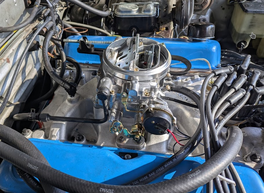

You say there's lots of slop in the carb. Are you talking about worn throttle rod bushings or slop in the linkage or what?
Hopefully it isn't worn bushings yet.  The car's only had like 4 tanks of gas through it since I put the carb on it.  There's a lot of play in the shaft in every direction when the engine is off. When I crank it up, there's not really any play.
For shits and giggles, I adjusted the throttle cable to put more tension on the return spring.  That made it strong enough to overcome the resistance in the carb's linkage.  I think for now, I'll add another spring and roll with it.  Its not running bad like there's a vacuum leak or anything.
I just got back from a 25 mile test drive.  The rear end works just like it was supposed to.  No noises or smells out of it.  It made the car 10% less of a racecar and more of a cruiser.  The added sway bar and the limited slip rear end kinda make up for it a bit.

Was that carb new or has it been around a while or what? There shouldn't be much play at all in the throttle shaft. Something's fucky there.
It was brand new.
I agree that something's fucky.  I've got lots of carbs and never had one do this.  I'm probably not going to invest too much into it.  This carb is a placedolder for a TBI.
12/27/2025 11:30:00 AM EDT
As you well know lots of things can cause the throttle to hang. I've seen 4 barrel linkage bind up and cause it, seen throttle plates physically contacting the intake bores just enough to hang up and etc. I've even seen an intake that wasn't true and when you torqued the carb down it was actually causing it to flex and bind. But there shouldn't be any slop in the throttle rod. If you bought that thing new I'd see about a warranty return or repair. I'd say that there's a fair chance that Edelbrock would make good on it if it's a factory defect.

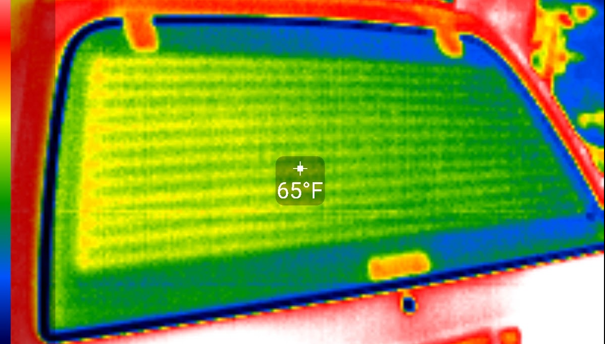

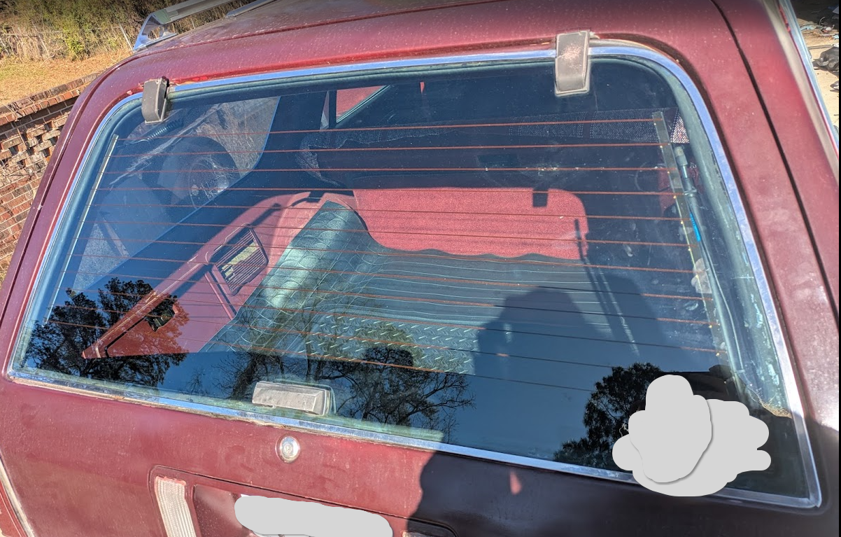

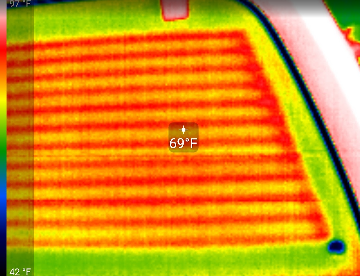

Yesterday evening and this morning's project was installing a defroster.  Up through the mid-80s, rear defrosters were not standard equipment like ash trays for every passenger.  I guess back in the day, if you needed to heat up the back of the car, you had your kids light up a couple marlboros.  I got the defroster like 99.87% done.  I need to order some more of the coily wire to tidy up the ground side.
1/1/2026 4:28:20 PM EDT
Huh. I've never seen aftermarket rear window defrosters for sale that I can remember. Interesting. As an aside I had a 76 Dodge Dart back in the 80s that had a rear window defroster. It was an electric heating element and a fan that went in one side of the package shelf and blew warm air across the back window. It actually worked pretty well. I wish I had that Dart back. It was a "Special Edition". Had plush cloth upholstery, deep pile shag carpet, factory A/C, factory power disc brakes, power steering and etc. It had a passenger side mirror. Slant 6 automatic. It even had a hood ornament.  Still had to roll your own windows down and lock your own locks. I bought the car in 1986 with 43,000 original miles on it. I paid the princely sum of $1200.00. And it was cherry. It had been garage kept from the time it was new. But at the time it was just an old car that nobody wanted.
1/1/2026 4:51:28 PM EDT
Yours was one of the more advanced ones if you even had a heating element in it.  Some of the early defrosters manufacturers were putting out were just that box with a blower back in the package tray.
This one I installed has a timed relay in it.  You hit the button and it runs for 10 minutes, just like the factory one would have done.
1/1/2026 5:22:19 PM EDT
I assume that the wagon already had the defroster wiring in place within the body. My younger son has a 1990 LX 5.0 and I added a defroster rear window to it. All I had to do was put in the dash switch up front and uncover the wires underneath the trim panel in the back and plug them in.

Nope.  This car did not have anything related to the defroster from the factory.  I added the fuse, relay, switch, and ran the wiring from the front to the back and stuck the copper elements onto the glass.

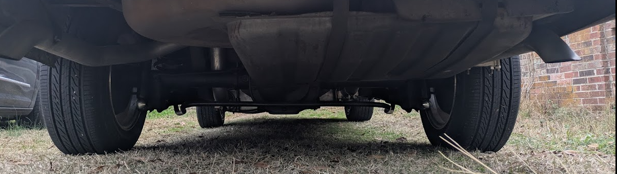

I got to fill the car up again today.  Since the rear end swap, i gained another 1.8mpg with my around town driving and all short trips.
I think that puts me better than the 5.0 mustangs, even the EFI ones.  And its several mpgs better than the 5.8 cobra r.  All while having more power and being heavier.
I think there's still some more to be had.  I haven't messsed with the rods/springs/jets in the carb.  I'm cruising it a bit rich.  The ignition is the stock duraspark.  There may be a few more mpgs in there to shake out.

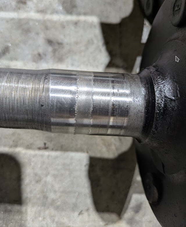

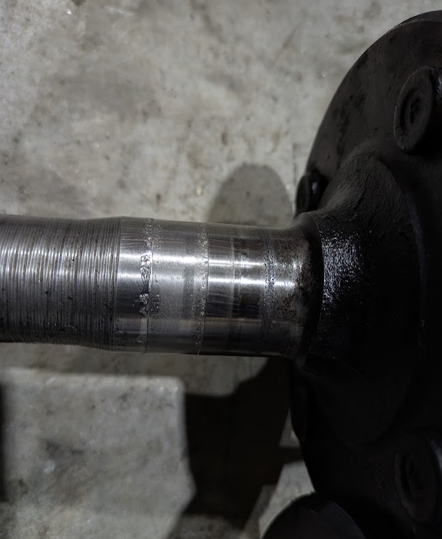

Welp, looks like i broke something else.  I started getting some noise from the rear end over 35mph.  When I got the car up in the air, there was a little bit of free play in the driver's wheel and it made a bit of noise when I spun it around.  FML.  I pulled the cover off the rear end and pulled the axles out.  The guts in the carrier still seem good.  Everything spins nice and quiet.  All the parts are still there.  The backlash and preload are still in spec.  When I stick my finger in the ends to feel the axle bearings, they feel ok.  All the rollers are rolling, but have some side to side play inside the little race.  The real sadness is on the axle shafts themselves.  There's an ugly grove on each of them that looks like where the bearings rode.  I'm not sure if they were borked from the junk yard or not.  I got a couple hundred miles out of them before they started making noise.
I guess I'm on the hook for another pair of axles and bearings.  Sad thing is, I just sold the old rear end out of this car.  It had a couple axle shafts in it that may have just worked.

I ponied up for the moser ones.  They say hardened and stronger than stock.  It was an extra $100 for the pair, which doesn't seem too bad.
I think a new driveshaft is on my short list.  When I had this one shortened, the shop said the tube wall was on the thin side.  It would be ok for cruising around but not launching.  While I was trying to track down this sound from my bearings, I did see my driveshaft has a bit of a bow to it.  I guess I might have partied a tad too much with it.  I'll get a new one made up before I get rowdy with it.

I ate up an axle on one of my SN-95’s years ago.  I used one of the “repair” bearings that moves the bearing surface in a little so they ride on the unmolested section of axle.
It’s a real shitty design to have the axle itself as a bearing race.  I prefer the good old 8” and 9” design of a pressed on bearing.

I'm hoping it was just a bad set of axles I got from the junk yard.  They may have already had some surface damage to them and this was just inevitable.  The "virgin" area on the driver's side axle looks like its toast, too.  I wouldn't try running a repair bearing on those.
I got a set of the forged axles, bearings, seals, and more fluid coming in.  If it acts up again, I may just swap it to an aftermarket 9" housing.    I have a spare 9" center section sitting here in a bucket begging to get built to go into something.

I adjusted the throttle cable to put more tension on the return spring.  And I swapped the throttle cable bracket to one that has a pair of return springs on it.  The throttle cable adjustment by itself seemed like it was enough, but now it has 2 backups just in case.  That's as far as I'm gonna take it for now.  Next time I unbolt that carb from the intake, I want to be ready to bolt on a terminator TBI in its place.  The current hold up on that is my fuel tank.  I ordered one a while back.  Rather than shipping it, they keep pushing the delivery date back.

And fucking a.  This morning, I got another email from amazon about the gas tank that was supposed to be here before christmas.  They finally canceled my order instead of pushing it back.  I called up summit, who also shows the tank as back ordered.  They couldn't get it and said call the manufacturer.  Manufacturer says its discontinued but try gastanks.com, cause they sometimes have things in inventory.  I went there where it showed in stock, but almost double the price of everybody else.  bit the bullet and ordered it.  Then I get a call that they dont actually have one here in the US, but they do in canada.  If I want it, it'll be $80 to ship it.  I reckon i'm gonna take this ride and see how it ends up.  $260 for a fuel tank I'm hoping cut up and convert to an in-tank pump.  At this rate, maybe by spring time I'll be out there tuning my EFI.

Today's little project was replacing the real seal on the TKX.  Modern Driveline sent out one they say is a better style than what ships in these.  This one went in like every other transmission out there.    It took longer to lift the car up than it did to replace the seal.

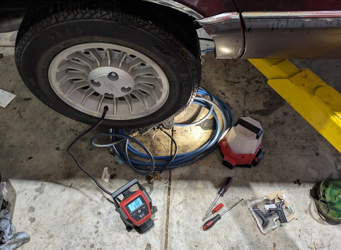

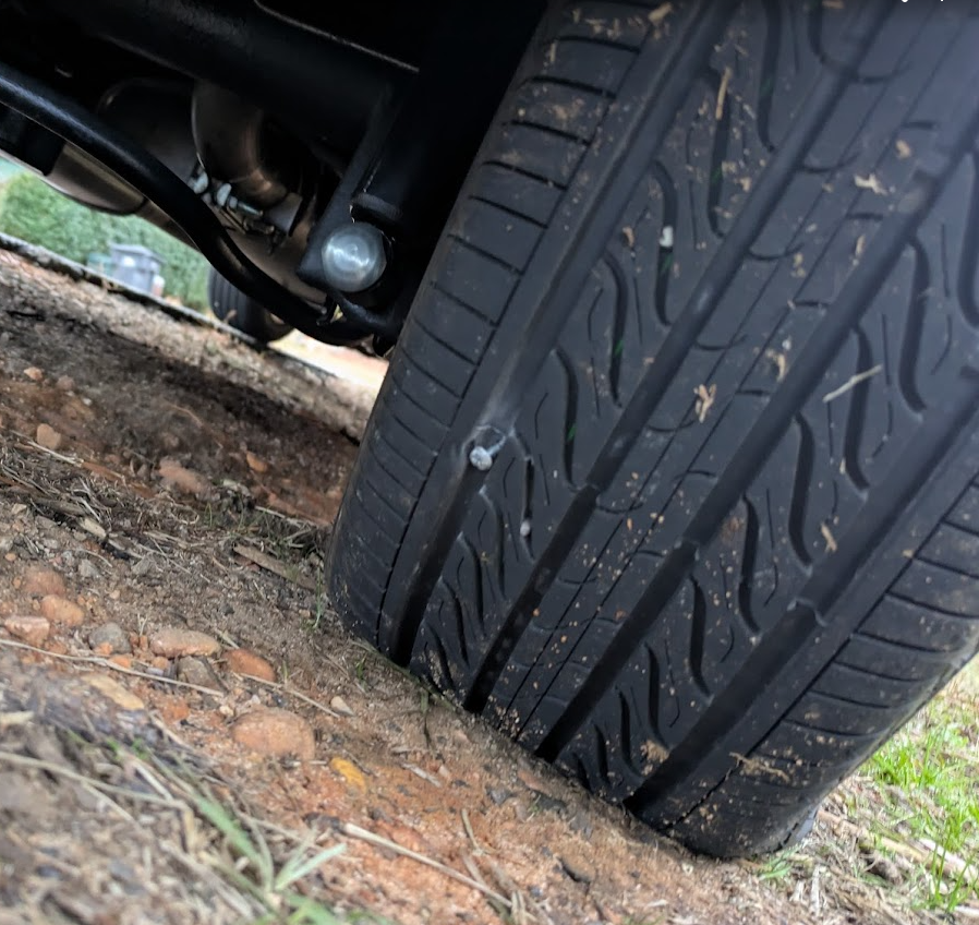

I came out of the house the other day to find one of my new high dollar walmart tires was flat.  The construction workers dumping screws all over the roads got me again.
I spent a half hour talking myself into going out in the cold to screw with it.  Then it took me 11 minutes to fix it, from lifting the car up till when I was setting it back down with the tire pumped up.  The hardest part of the job was motivating myself to go out in the cold.
Its been a few days.  The plug seems to be holding.
