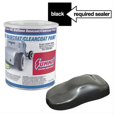

That color does look cool on that car.. But I am not a green guy.. I see a lot of colors on cars today that I like.. But would get sick of looking at them after a while.
It is a cool color but I think it would get old quick.   I was planning on using some paint I brought in for another project but not sure.
https://static.summitracing.com/global/images/prod/large/shz-swbc523v-12.jpg
