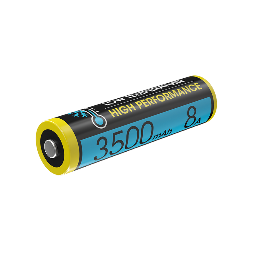

I have Nitcore Extreme Low Temp High Performance in my weapon lights
https://nitecorestore.com/products/nitecore-nl1835lthp-cold-weather-low-temperature-high-performance-18650-battery
