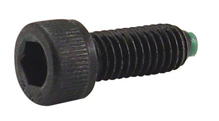

McMaster Carr nylon tipped screws
They also do brass tipped.
In socket cap or set screws.  IMO if you wanted to go 100% never come apart, I'd go with set screws, get epoxy on the threads, and cap the screw in epoxy to seal it in.  That said the big socket head screws would be kinda awesome.  Especially if you could get them to rust or fake it.  So you have "rust" weeping down the side of the rifle, despite the screw body being sealed in epoxy.  If you don't want to risk damage, just some brown and red acrylic model paint watered down really well will do the trick.

Dont see the point for this I think I would want it actually bolted to the upper not just pinching it
That was the 'worst case' option depending on how much metal is left after milling.  The screws would largely be to support it while the internal spaces were filled with epoxy really.  After that, nothing is going to move.  Think of it like using something to support a part you are bedding, but you forgot the release compound.
Yeah I'm thinking set screws combined with epoxy but I'll leave the heads exposed over the square tubing so it'll rust.
On top of that I can use picatinny blanks that everyone keeps linking that arf fucks up, good find there guys!

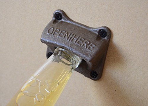

If you put the bottleopener on the left side of the gun, you can still hold it in your right hand and pop the cap on the bottle in your left
4/2/2017 7:35:03 PM EDT
maybe he is left handed
EDIT> I am picturing one of these LOL
4/2/2017 7:51:25 PM EDT
www.amazon.com/dp/B01DELW1RG
It'll be this style, one of the wall mounts would be a bit too much
The reason I'm thinking right is just so I can have it centered but after holding one up to it I could fit one on the left
4/2/2017 7:56:50 PM EDT
https://img1.etsystatic.com/070/0/5239925/il_340x270.820772051_q0sm.jpg
Underachiever
