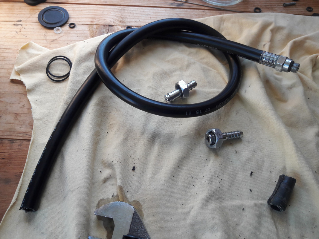

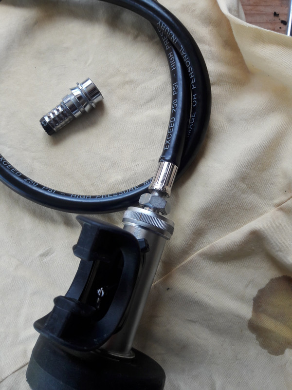

At home like most, not working.  While sorting through a pile of hoses yesterday, a light bulb in my noggin went on.   I have access to a very nice automatic hose crimper.  I hacksawed the ferrule off a rotted Cyclon 2nd stage to salvage the inner fitting.
Chopped an over sized bc inflator hose and crimped the proprietary Poseidon fitting with new ferrule.
I still need the adapters, but this allows me use what I have and not have to purchase a hose as well (Poseidon=$$$).  I will be installing a Poseidon octo down the road.  I have acquired an addotional set, but ALL soft goods are toast.
Recovered parts from 2 hoses.
Primary hose complete

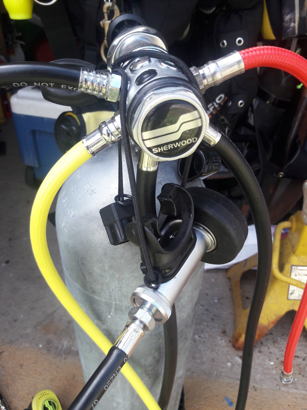

Got to try the Cyklon 2nd (married to a Sherwood 5700).  This thing is a tonsil rattler.  I am hooked.  Still have to use on a complete set though.

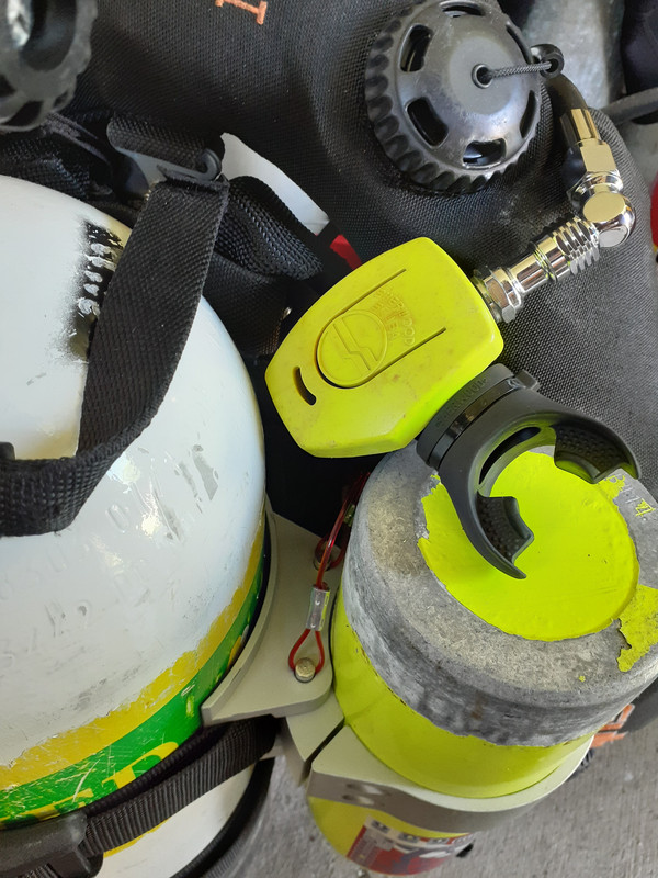

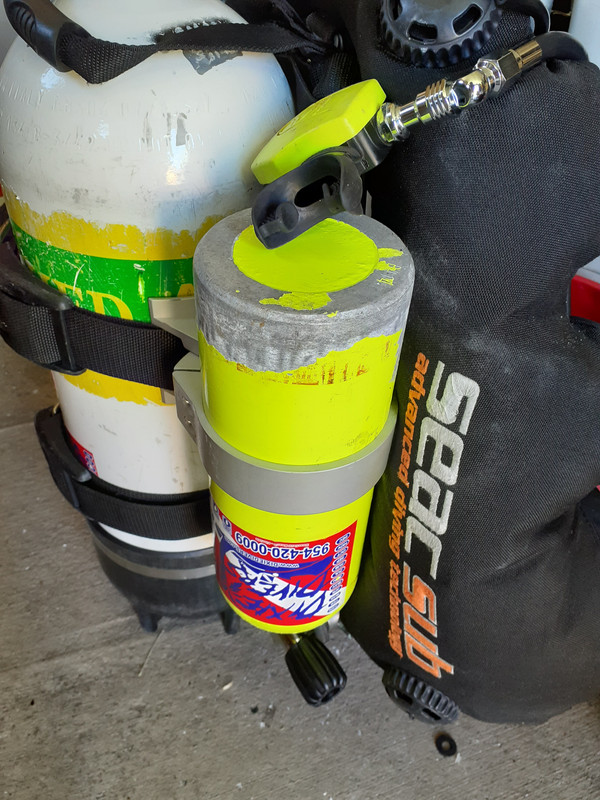

I have rotator cuff (sp?) issues and practiced loading on dry land.  No go in the water. I will need to move bailout from slung to piggy back on main tank as it is just in the way. Also, I am going to make a loading tool to help with my situation. Dive buddy did well with mutton and lionfish and a visit from a bull.

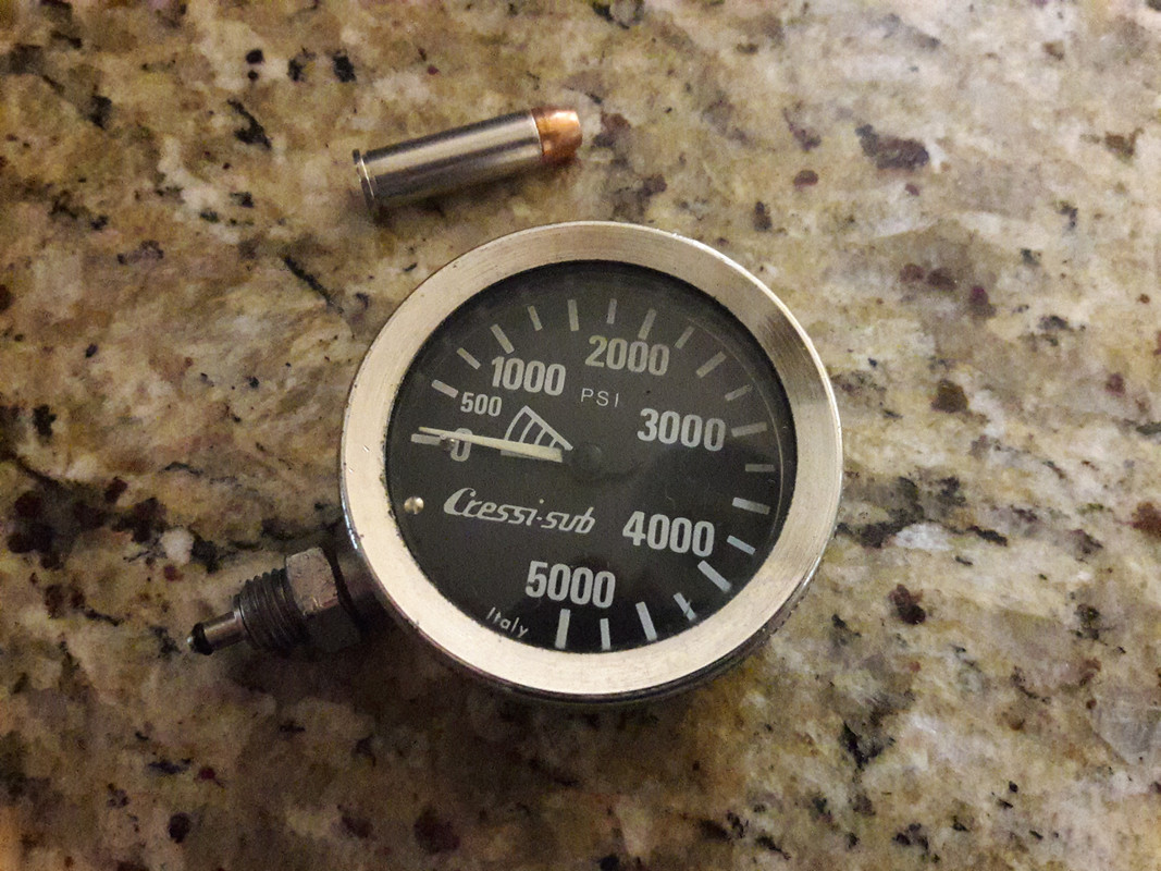

Picked up an SPG that I think will complement the Poseidon.
BIG, .38 spl for comparison.

Cyklon is coming along and working well.

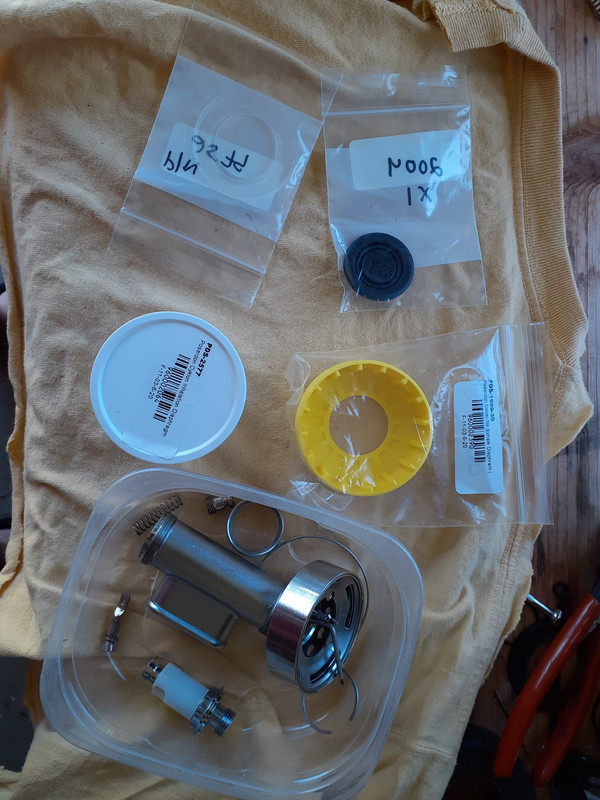

I have purchaed all the soft goods for another Cyklon 2nd that will be safe 2nd.

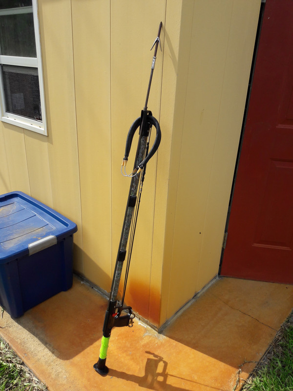

Changed the bands on my gun already .  Salvimar acid green

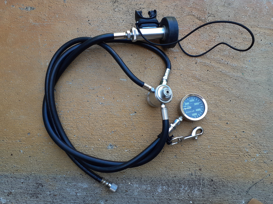

Had to switch from slung bailout to BM to clear up real estate to allow loading the gun.  The Trident quick draw works well.
I changed the SS cable to crimped mono as the oem cable kept coming undone.
Left hand valve with Scubapro MK2 and Sherwood puck 2nd.  Bailout charged and turned off until needed.
