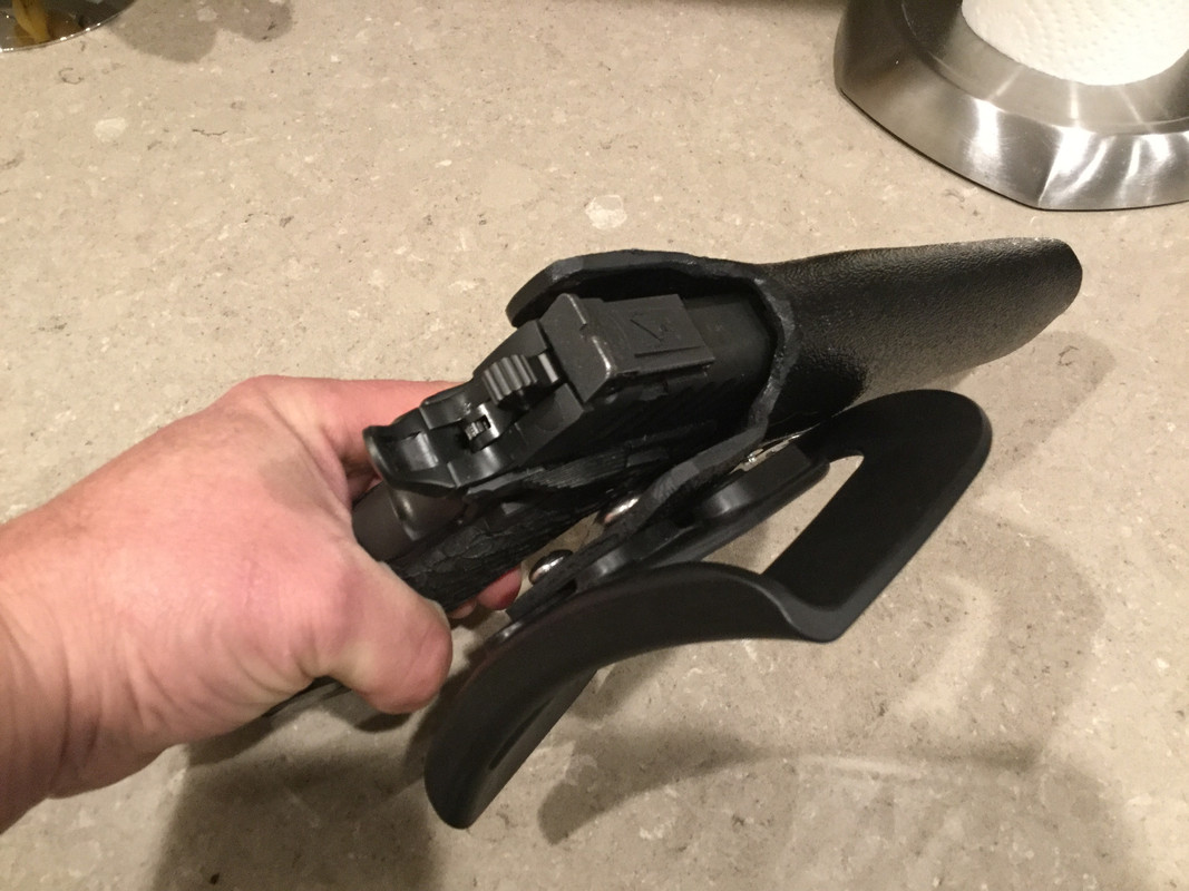

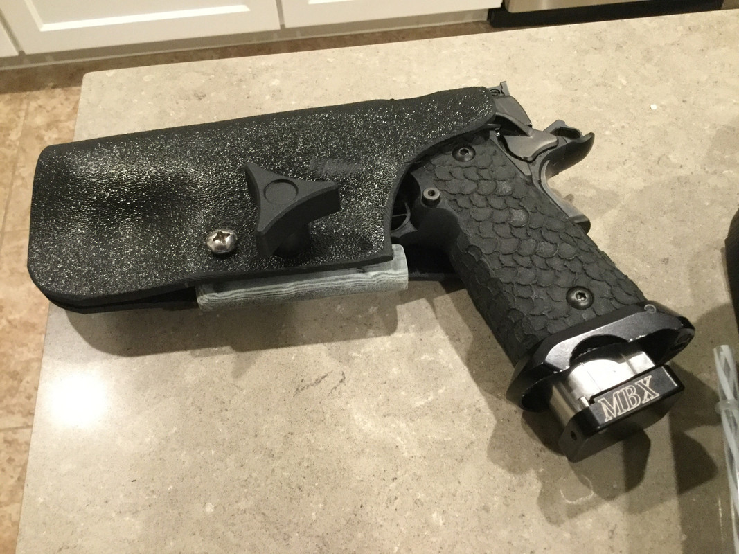

I’m not seeing anything lacking from what I made and what you paid for except my holster is 1/4 thick.
Where’s the benefit in the pro holster that I’m missing? |
There's about 5-6yrs of refinement and hundreds of major matches you can't see. The stuff that matters isn't immediately visible from a pic.

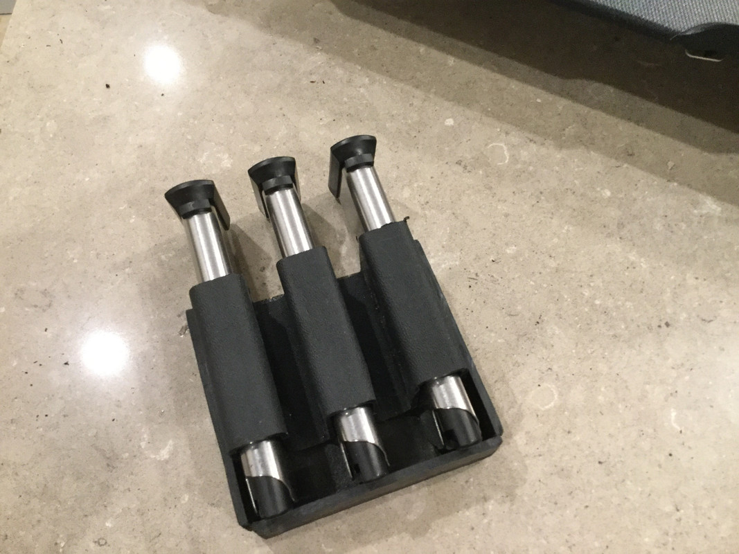

Other crazy assed idea I had was those super expensive double alpha master mag holders. They’re aluminum with what appears to be some square tube specifically deminsioned to fit double stack mags. There’s a round corner on two sides and square opposite .. I’ve been looking through metal supply catalogs for something close but coming up empty. I think they’re extruded specifically for this application.. anyhow. The rear belt clips could be flat casted in aluminum for nothing then drilled and tapped to mount the actual holder to it.
Sand casting is relatively simple. Done a lot of brass over the years ( great way to make retirement plaques) but the mag holder body I’m coming up blank on if anyone has ideas or a decent cheap substitute. |

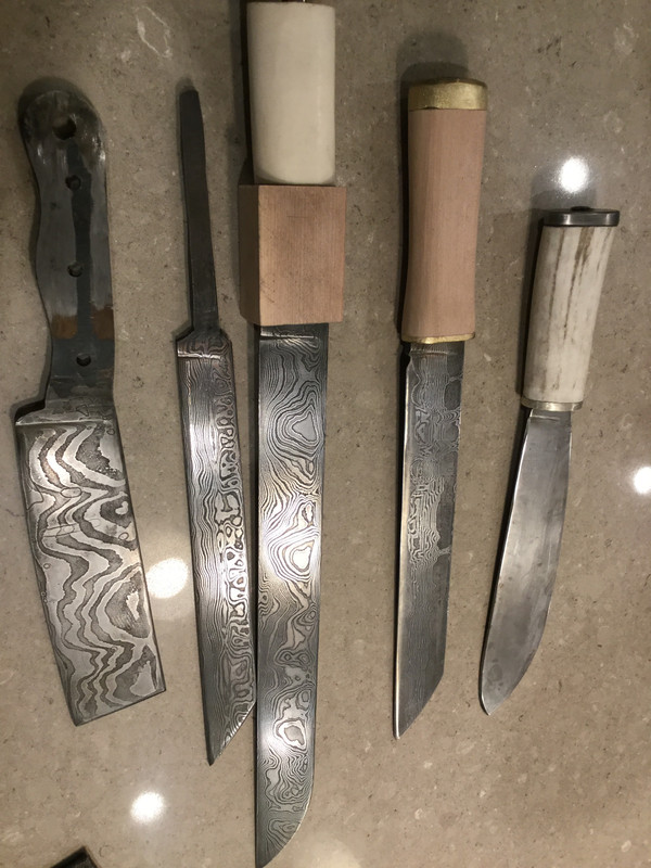

@sawdustnsteel You gottta start somewhere and what better place to test and prove your products (even if they are just for you) than in comps... I've made a few holsters for pistols, mags, knives, Dip cans and a few flasks. It can be both fun and a pain in the ass... I've bought a lot of stuff from https://www.knifekits.com/vcom/index.php and a few other sites also. What kind of press did you make/use??? I bought a TACO press and a book press off Knife Kits.com and had really good luck with them. At my old house I had my basement all setup for making Holsters and other kydex gear, with stations for each step. It was a lot of fun. I even bought a few molds for stuff I have like a Glock G17, Glock mags and Pmags. Unfortunately at my new house I do not have the room in the basement or garage to set up. I'm hoping to build a shop in the next year or so and get set back up. View Quote I’m still learning forge welding and tempering 1095 and 15n20 but getting there. Micarta was another one of them things I decided I’d make versus buying. Thankfully I got a lot of old uniforms that make real cool micarta handle material. The top knife handle was made from one of my multi cam uniforms from my last run in Afghanistan |

Originally Posted By mr50mag: Maybe there was a miss understanding. By all means keep at it and I fully endorse customizing your own gear but after 10+ yrs in that sport one the most important pieces of gear I have come to realize is the holster. Almost 99% if not all of the match DQs come from a dropped pistol of some fashion. Unfortunately with that being the case and all that it implies, a quality holster built for that exact situation will be the cheapest piece of gear in the long run. View Quote One of the things I didn’t like about purchased holsters I’ve seen is the tiny nut they use. Seems most are aluminum and likely to wear out faster than steel from use. The big knob I chose so I could paint the “up” end with a gold or white sharpie and visually see if it’s loosening under movement or keeping hold. The one photoed is the one I didn’t paint. Edited to add: I am concerned the big ass knob I opted for can snag and loosen from going prone or skirting something. I just can’t find a viable option in steel just yet. I’m thinking a big wheel nut with knurled surface. (Like 1” big, I got half a thumb on my dom8nate hand so tiny little fidgety stuff really burns my biscuit when I’m in a hurry and don’t have time to focus and get a grip on it) |
