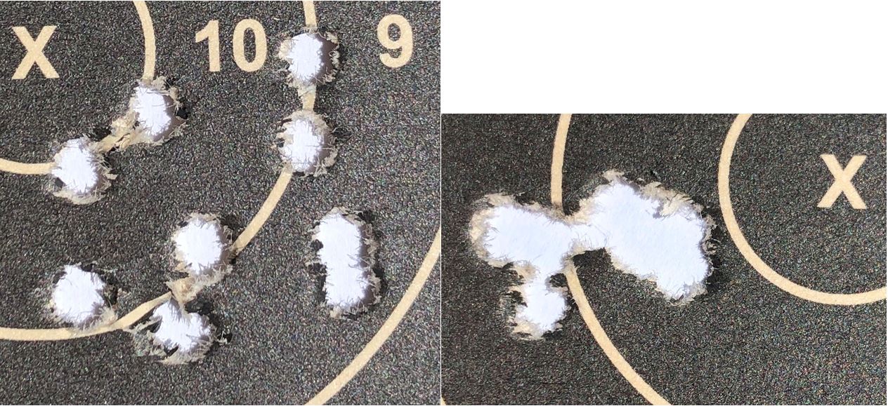

[Last Edit: Trollslayer][Edited] [#22]
Originally Posted By smoothy8500:  Good performance/cost balance: RMR (rocky mountain reloading)...
I found this just now.  The right hand image is the 69 RMR bullet can do at 100 yards and compares it to the 77 gr seconds I bought.   Note the general scatter to the shape of the 77 seconds (left hand image) as opposed to the tight groups of the RMR bullet.  Some of the lateral scatter in both images is wind but wind does not explain the scatter.
I don't have any 75 gr RMRs but someone on this forum has tested them.  At 16 cents each, the RMRs are less than half the price of the Sierras.
Still, the Sierras can out-shoot either of these.
Lesson learned - if you care about accuracy, buy top quality bullets.
...................................................... 77 gr seconds .................................................................................................... 69 gr RMR bullets
I know I went off-topic quite a bit but hope the point is made.
