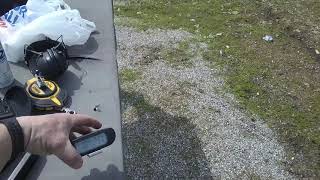

This is just Steel Challenge.
Static steel.
It does not fall.
All you gotta do is knock the paint off.
Here are a couple of old videos of me just practicing by myself on a Steel Challenge stage called Smoke and Hope:
Beretta M9A3 vs. Smoke And Hope
Beretta 92G Elite LTT vs. Smoke And Hope
There will be a designated stop plate on each stage.
There are a total of 8 for real SC stages.
On 7 of those stages you get 5 attempts or strings.  They take your 4 best times and add them together.
The 8th stage is called Outer Limits and it has 2 or 3 boxes that you shoot from.  You have to move between the two boxes while on the clock.  And you only shoot at the steel targets while inside a box.   You shoot 4 strings on Outer Limits.  They keep your best 3 times.
So in all….if I math’ed it correctly, 31 string times get added together to calculate your final score.
Back in 2007, Max Michel was the first to break 80 seconds (with a centerfire pistol drawn from a holster).  Sig Arms and Outdoor Channel gave him a check for $30,000.
Breaking that 80 second mark is akin to running a sub 4 minute mile.  Or say a sub 10 second 100 meter dash.

I went and practiced yesterday morning.
I’m thinking, now, it is one of those things where over the years shooting at paper/cardboard IDPA and USPSA targets have been way more forgiving  than shooting steel.
Google puts the dimensions of the brown humanoid shaped cardboard USPSA target at roughly 18 inches by 30 inches.  That’s 540 square inches.  Yeah, yeah, it’s a little more involved than that.  But I will get to that later.
If I did the math correctly, a 10” diameter plate is 78.5 square inches.   So it is about 14% of the surface area of a cardboard USPSA target.
I have RO’ed / SO’ed hundreds of shooters at matches, some at national level matches.   I can now see why steel plates and pepper poppers give people problems at IDPA and USPSA matches.
Wide open cardboard targets with no hard cover on them or no “no shoots” in front of them makes for a hoser or hose fest type stage.
I did watch some videos on YT yesterday:
I have been shooting it like this for years:
A, B, C, D, Stop
I had a eureka! moment yesterday when I saw this YT video.  The dude shot it like this:
A,B, D, C, Stop
So I will have to try that next time…see if that helps.
Swinging this conversation back around to reloading….
NOPE!  Still can’t tell the difference between the 115’s and the 124’s both with CFE Pistol with respect to recoil / muzzle flippiness.
The gun ran 100%.
I picked up all my brass.  Which is one of the perks to wet tumbling is the bling really stands out versus the tarnished not so bling brass that has been there for a while.  I found a few .380’s in the gravel.  I threw those on the side berm.
Maybe about 90% of the way through my practice session, my fiber optic front sight decided to launch itself somewhere.  Just the light pipe….not the entire front sight.  I didn’t think to bring any spares with me.
I might just bring a regular black metal front sight post equipped gun next time.

I also watched this one dude’s video where he had added in the shot coach timer app.  I think he was at a 1.30 draw time with about 0.4 trnsitions.  So finishing up tight around 3.3 seconds.
